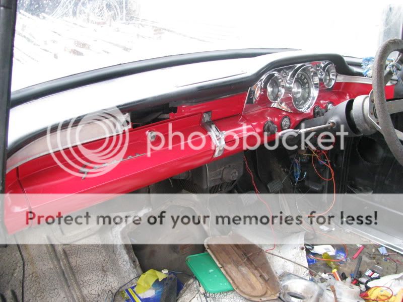

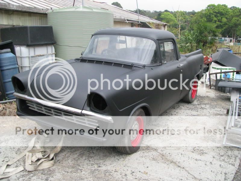

this is what we found... most of you would have seen this before...
greg rewired the car through out...
took a little while to get into it.. but just about there...

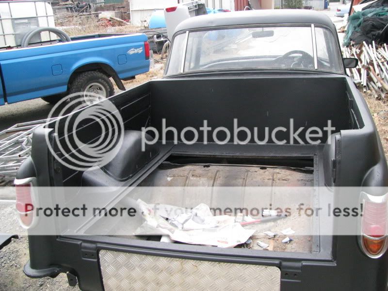

looks as though the ute has been hit from behind at some point.. a bit of a mess in lh rear quarter.

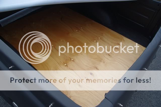

was going to replace the checker plate at the spare wheel door... but one you start digging.... might be a job for another day... but a hit of matt black and a new ply tray sorted that.. out of sight.. out of mind.. for the moment

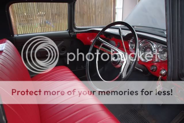

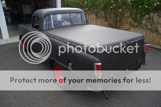

new door trim and front seat reupholstered... and new tarp
repro floor matt...

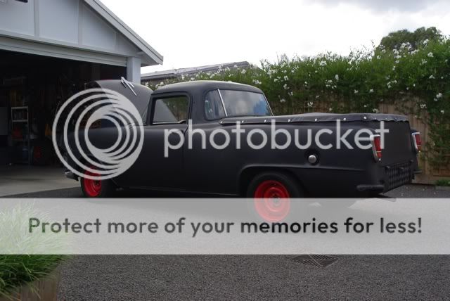

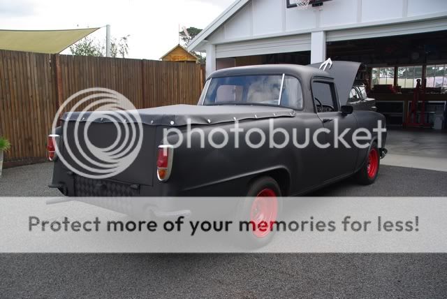

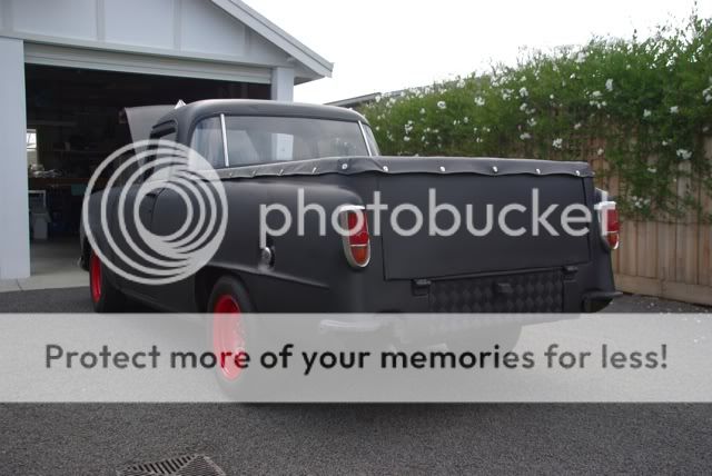

a few door rubbers to do... a couple of tail light lenses.. and hopefully.. roadworthy... next week !

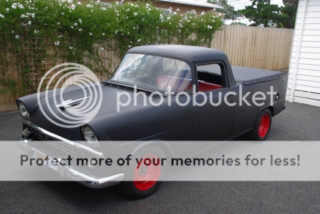

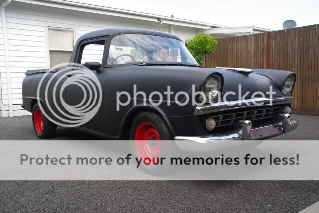

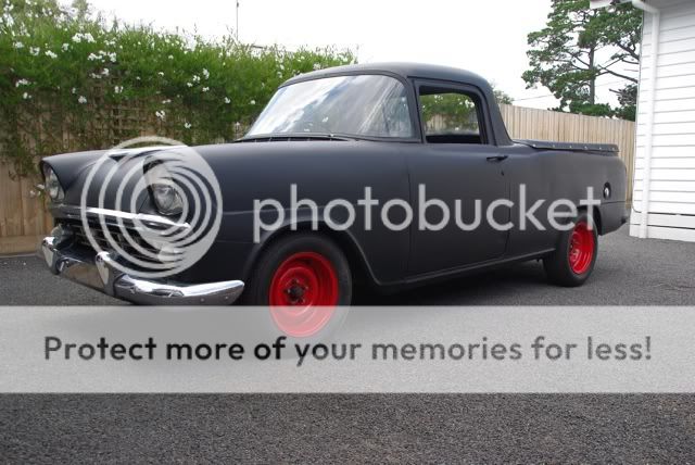

this is where it sits at the moment...
it aint going to win any awards... a few dings here and there.. but overall pretty straight... and i think she looks pretty cool...
