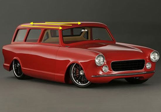

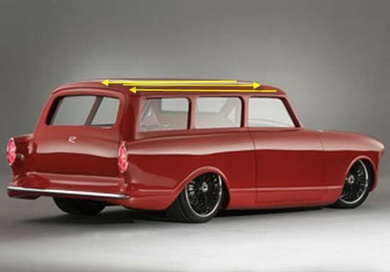

This is what I meant previously.
Although I don't think I can get a continuous run all the way along the entire length of the car.
THEN MOVE TO THE OTHER SIDE, and continue.
Any better ways.
Doing it in quarters would mean the paint would be dry by the time you got to the 3rd quarter.

Hey Finny :)
thats how i painted my wagon roof from front to
back back to front then ran around the other side
if you do the middle runs abit wetter it wont dry by
the time you run around the otherside so you avoid
a dry line
a good trick also if you can take the wheels of the car
and put it on low blocks so you can reach the middle
better

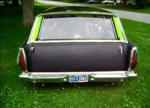

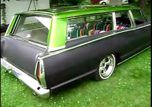

Hadn't considered taking the wheels off, but that would really help.
So many nice colours, its hard to pick only one.
Found this one, and really like the contrast. 8) 8) 8)
Rat Flat Black, with glossy Green................

Do as long a stroke as possible, start on the outside of one side, work into the middle, then go round the other side of the car, start in the middle and work backwards. Lean on the drip rail or doors for balance
