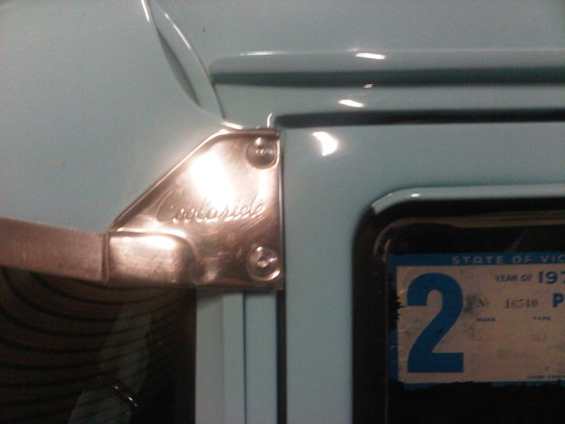

The sides should sit at the same height as the door frame -

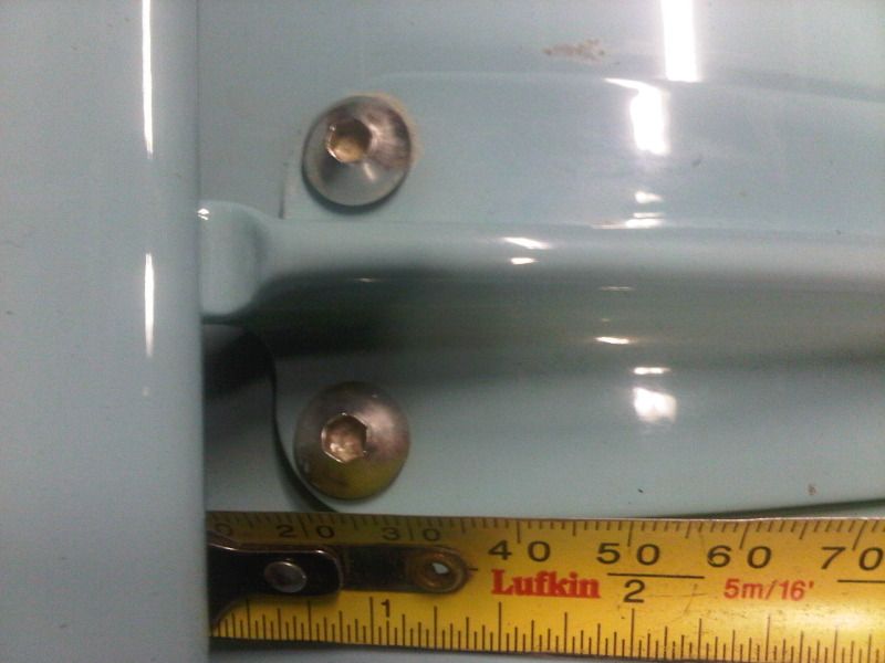

The centre bracket sits about 23mm back from the edge of the turret , I stuck the end of the tape measure between the surround and the roof.

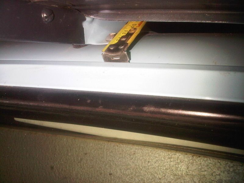

Here is the other end of the tape -

Thanks Blacky, Thats exactly what I needed. Trying to sort this out while the body is still bare metal to save scratching etc. Cheers again Daz.
