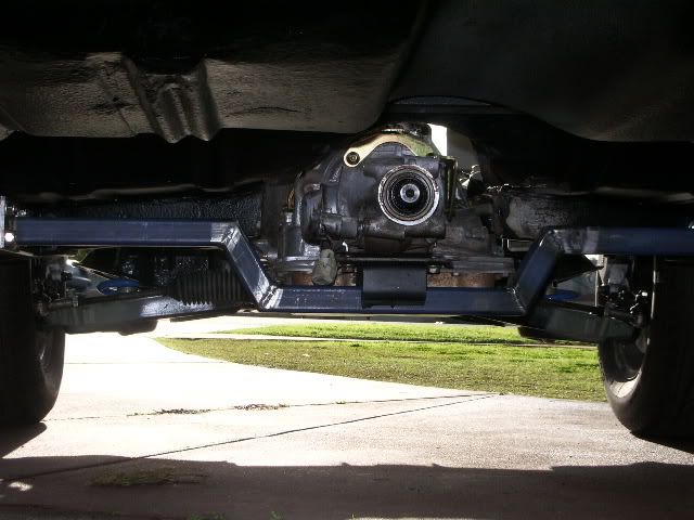

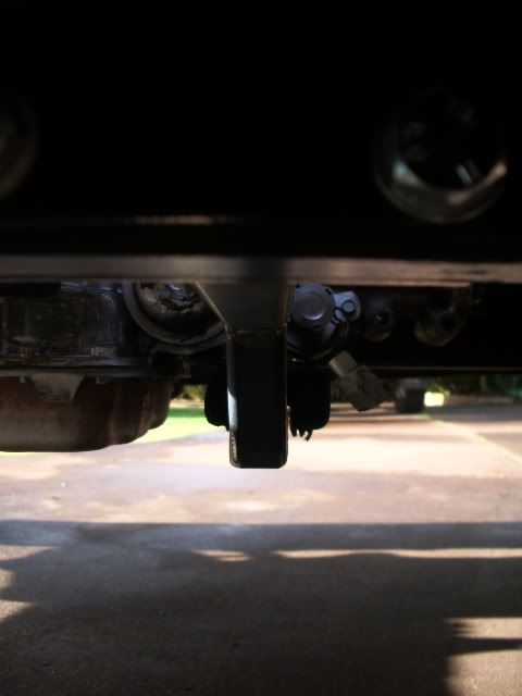

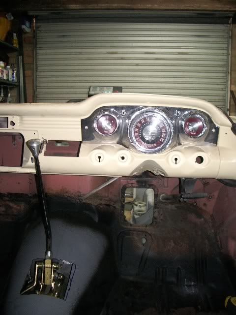

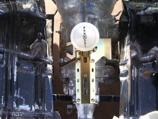

Got round to finishing the real gearbox crossmember today....
From the Rear
From the passenger side

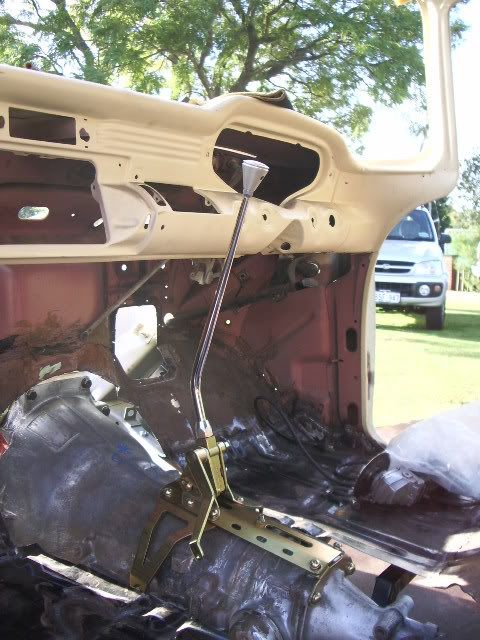

Fun stuff - the 16" Lokar Shifter (I love it!!!!)
And initial tunnel work!

Looking good!
Where did you get the shifter from?
Does it come with a rubber boot? Or does it need a consol?
NoMAD
Posts: 1993
Post by NoMAD »
its a Lokar shifter from the States...very popular with the hot rodders which is where i pull a fair bit of inspiration from...like what my paint & interior & wheels will be!
www.lokar.com
the shifters come in all different sizes up to 32" mines a 16"!
The boots & rings you buy seperatly....but i think you can also use aftermarket ones!
http://www.lokar.com/interior_pages/indicatorsboots.htm
I also have the control module & an in dash LED indicator!
there not cheap i warn you now!

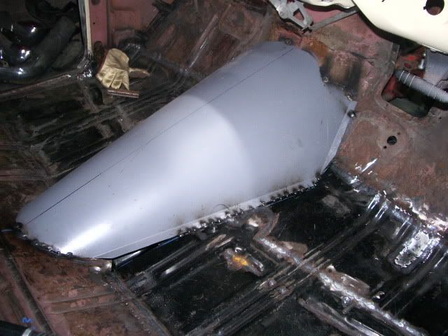

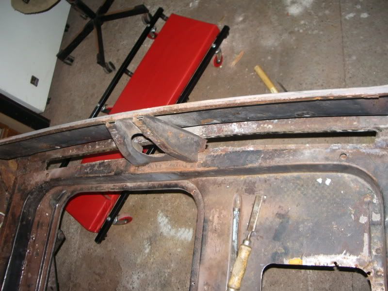

Yes i know its been a while since i updated...but its been a while since any major works has begun due to partying in Canada for almost a month - hence where most my funds went and working to much aswell!
But work has begun in the Boot...plan is to hunt down an XB tank in the next week or 2 and finish replacing the section that has been cut out below, finish off some minor works and then spray the boot inside!
Bottom Side
Top Side

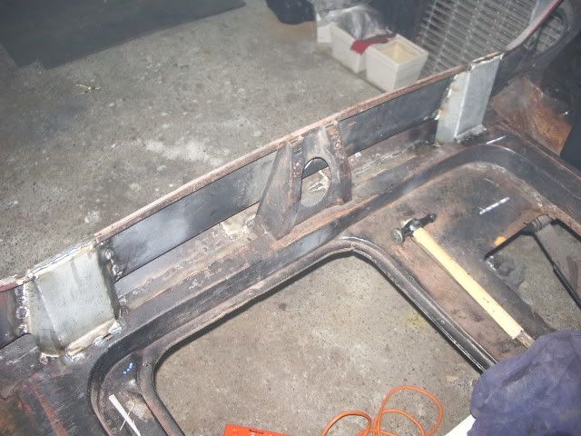

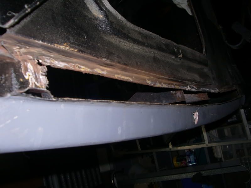

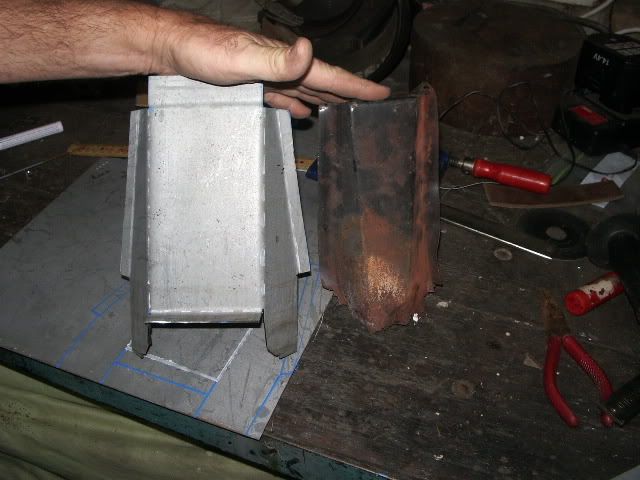

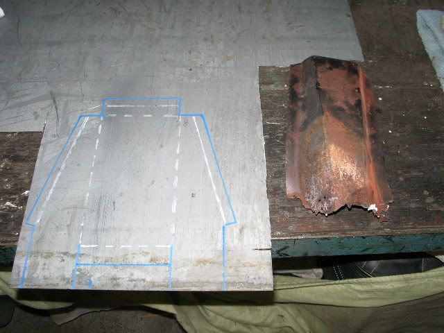

So little bit on the boot today....the Boot finally had its Wheet-Bix, since i couldn't get a tank.
As 1 strenghtener was completely missing and the other completely rusted away, we made these up not original but alot stronger!
Template
Folded Up
Both Tacked In
Next load of Boot Work should be the tank, filler/Fuel Flap and the Battery Box/Tray Area.
