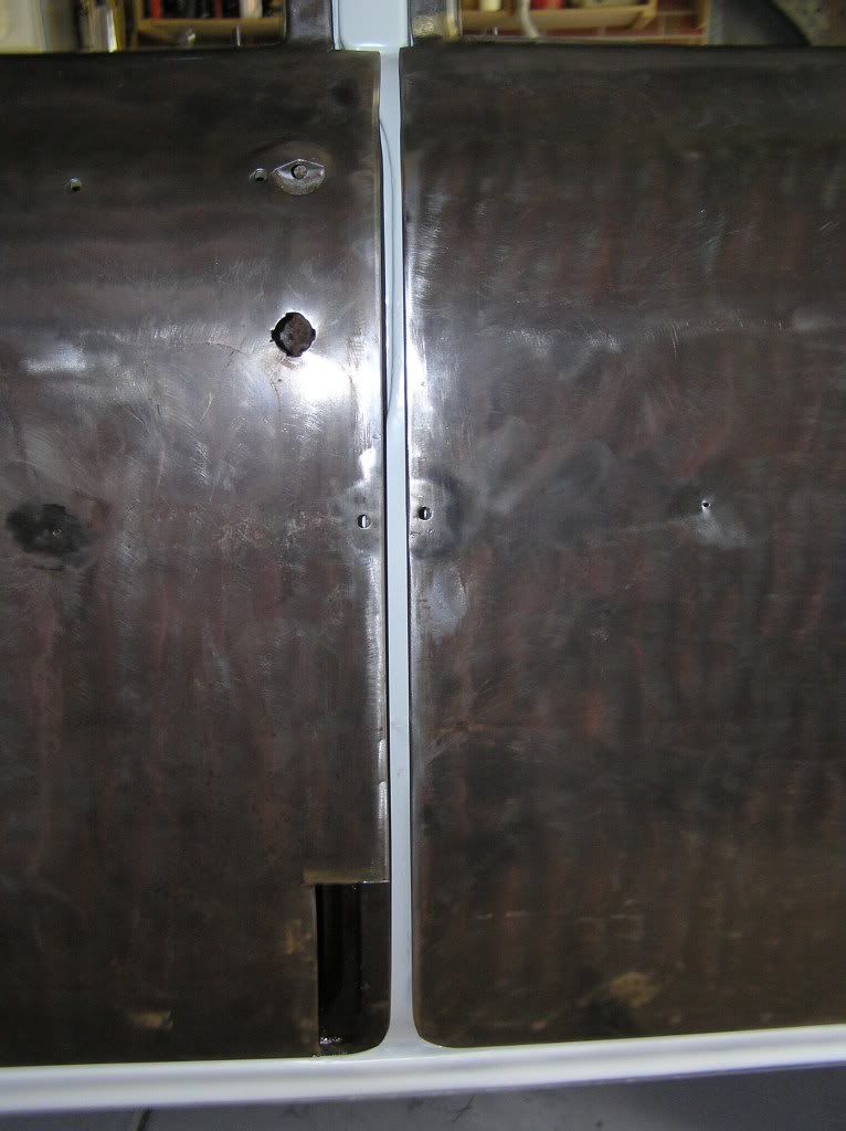

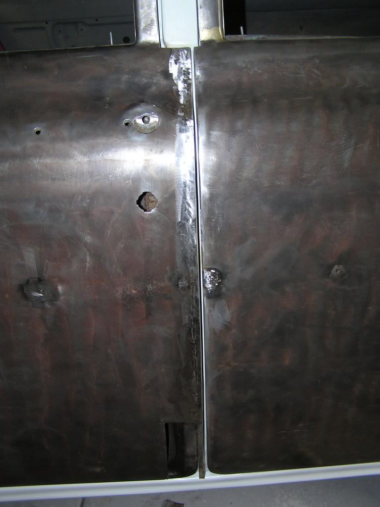

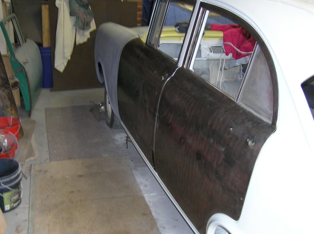

Last two panels began today :shock:
Passengers doors stripped and rust cut out........
Adding the extra for the gap between the doors was much easier this second time around.

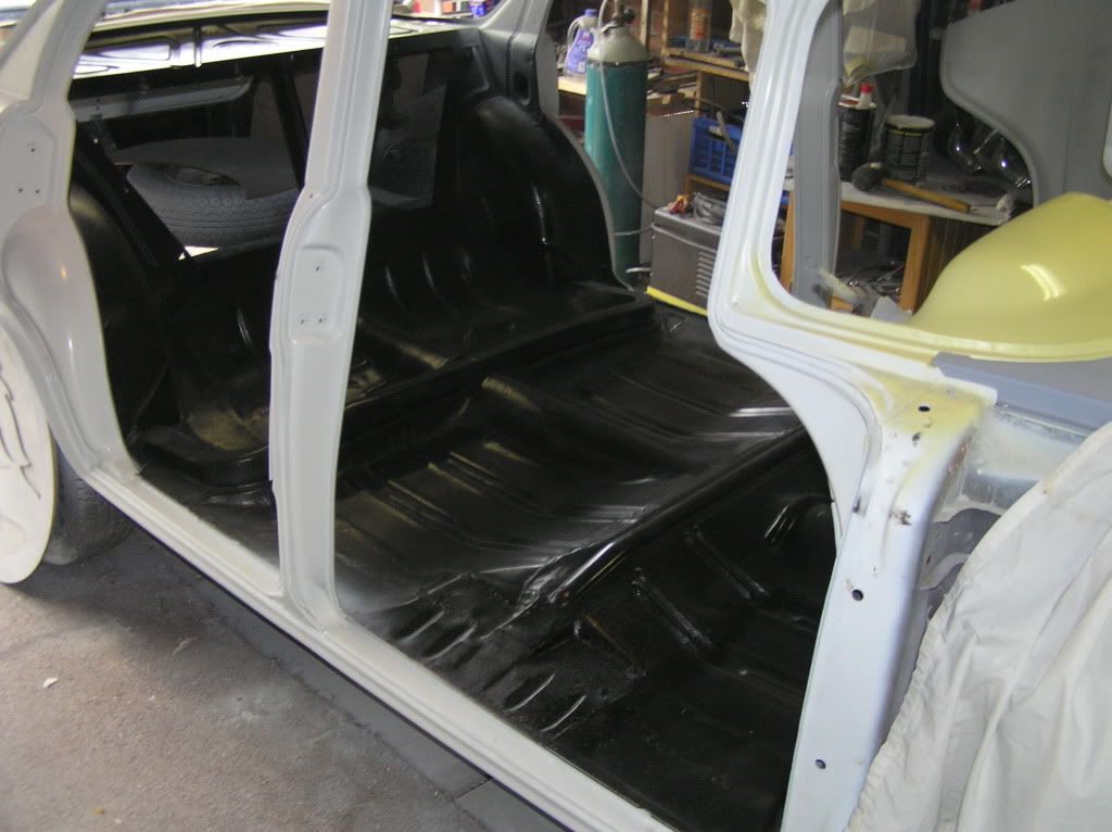

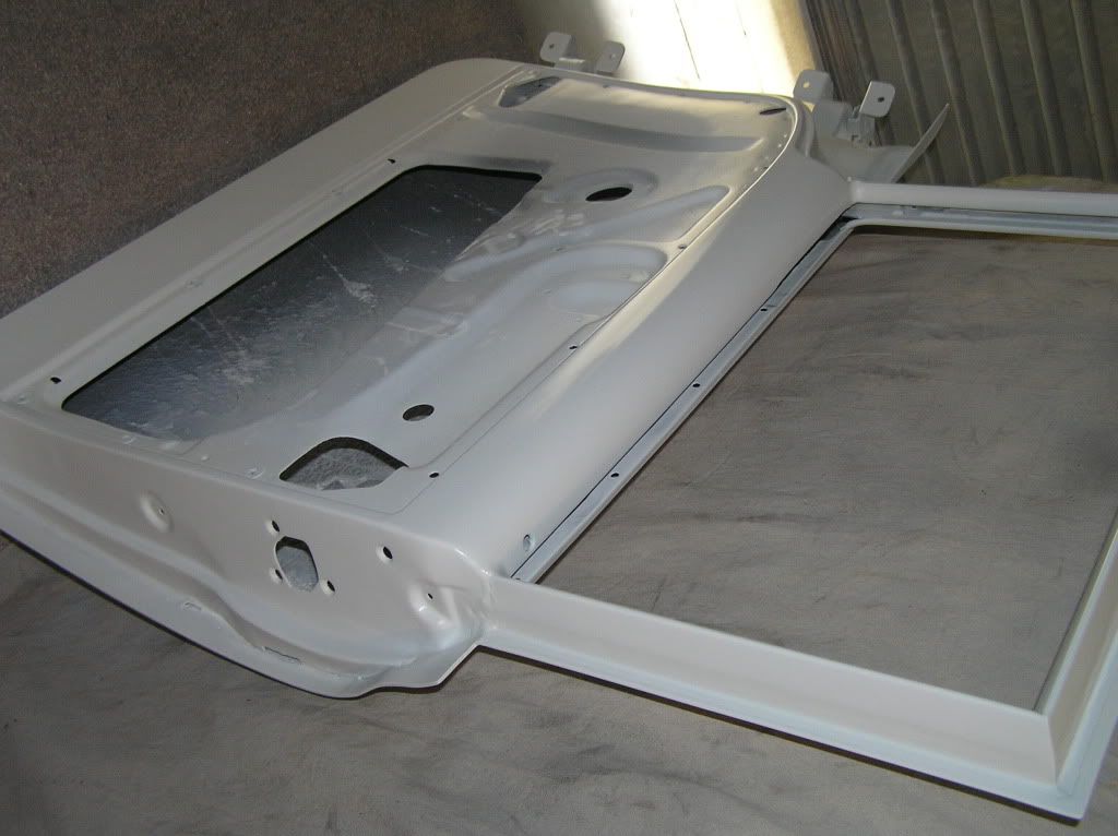

I've been blocking back the doors to get them ready for painting the inside faces.
Also painted the floor, parcel shelf and inside the pillars........

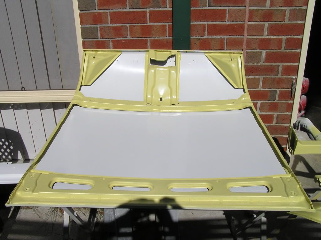

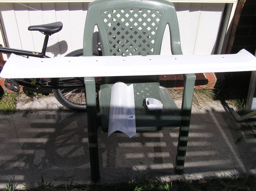

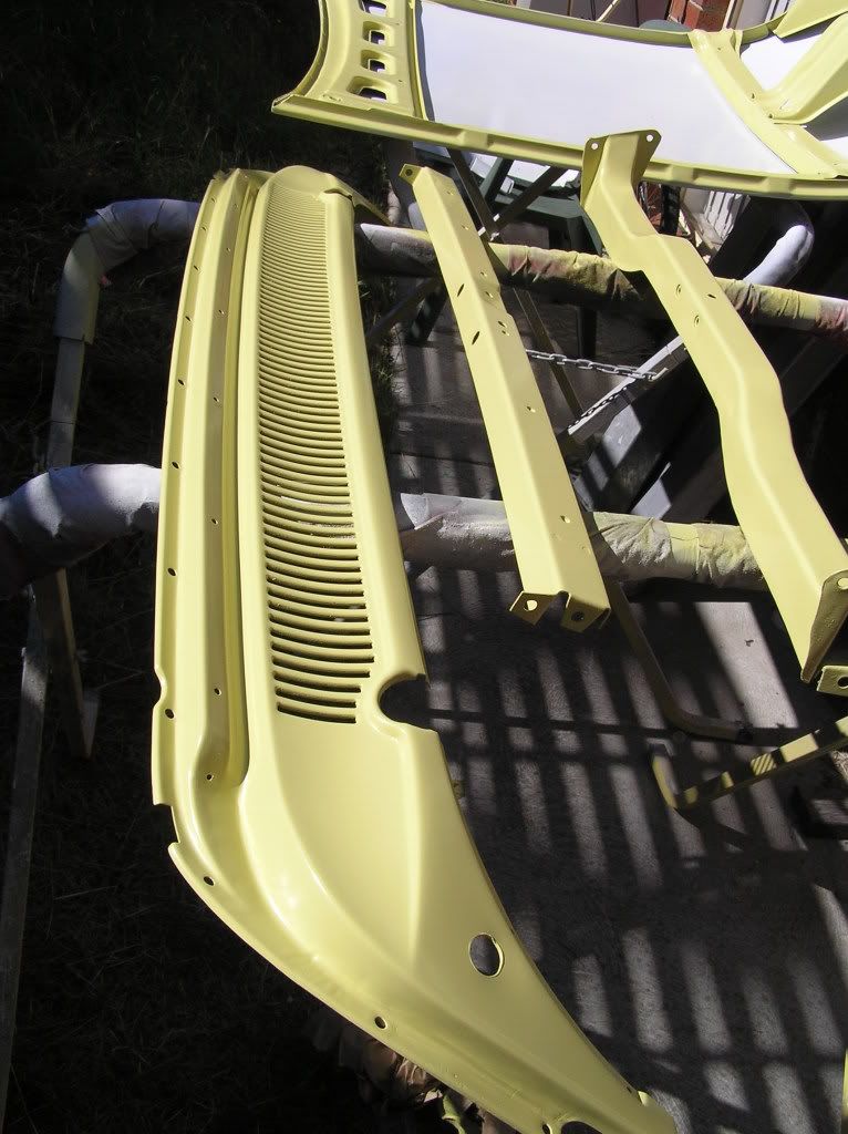

Finally no more rust on this old girl anymore :D :D :D
I got the last of the bolt ons stripped and primed.
Some more pics of what's happened lately.
Door jambs painted.........
Stone tray, glove box and ashtray painted........
Plenum grille and 'under bonnet' bits painted........
And the underside of the bonnet done.........

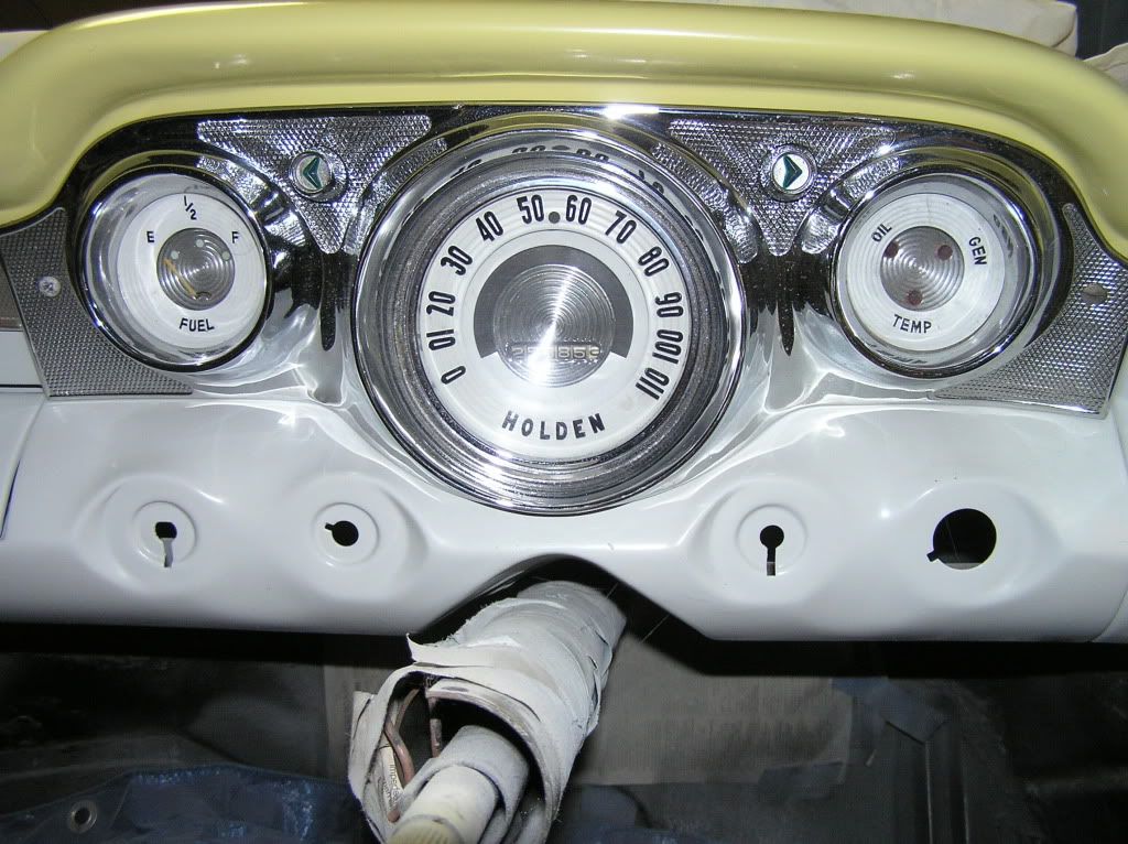

Finally got the dash guages painted and back together.........
I like shiney :D

Dash looks great! Nice work.

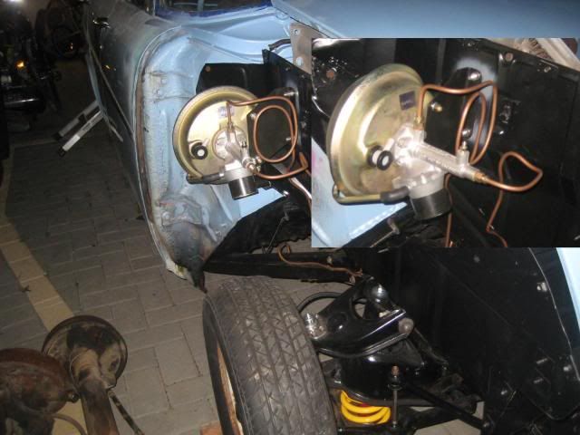

I was just reading through the whole thing and in ref. to your brake booster I did the same thing but Terry at Hydroboost sent me a cap to go over the intake that allows for a small vaccum hose to go into the engine bay( something about keeping mud etc out and possible engineer requirements). I wondered at the size of the hose vs the intake but it seems to work fine.
Its just a press fit metal cap with a nozzle off the side- you just seal it with a bit of silastic- I drilled a 10mm hole in the subframe behind the bonnet hinge and stuck a 13mm poly pipe cap through with a hose clamp on the outside and some vacuum hose in between. You can get the cap from hydro boost but it wouldn't be hard for someone with you skills to knock one up.
