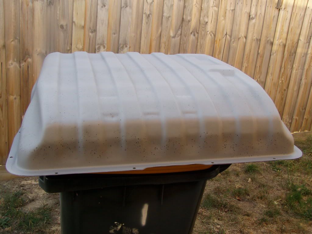

Picked up a fuel tank at the wreckers today. Now to work out how she fits...

There is a couple of us on the forum that have done the XC fuel tank conversion. One thing to be aware of is the tank clearence to the diff center. I used a 9 inch &*#@ diff and I had to cut a recess in the front of the tank to clear the diff. Also I fitted the tank around the other way to original (sender to the back). The tank seems to fit better that way and it give the look of a drop tank.

Thanx Malcom. I'll keep the diff tip in mind.
I had planned to fit the tank backwards.
If you have any pics handy of the process and finished it would be great to see.
Does doing this effect the how the fuel guage works?
Where did you end up putting the filler?
