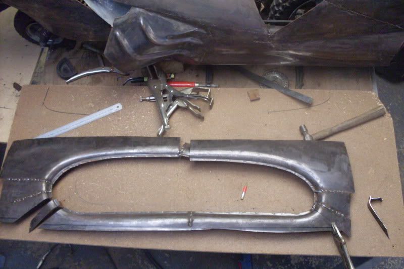

Yes mate ,by my understanding of the mpv rules as of right now all the mods I have done and have planned will pass.
Didnt think the window was quite right so I took some shape out of it - happy now :)

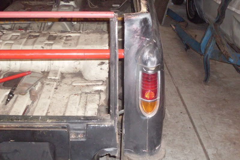

So I decided to use some of the skills learned in Franklins back in tha day ,We used to slice open boxes like this :shock:
But in all honesty it started out needing more tyre under the guards ,It works out the guards are a factory 17mm narrower to the rear.
The rail at the top of the tray is 30mm narrower to the rear , hmmm if I push the quarter out it will square it up ,give me more tyre room ,and fatten up the rear profile . done :D

The car went backwards to go forwards today hardiddyharhar ,I just wish they were built right in the first place !
Ive finished widening the driver side of the body , stripped the tubs from it and the floor in the tray :cry:
Im planning to pump the quarters a touch and run the new inner guards out to the quarters and tack/glue them there rather than having the inner wall .
apart from the offset I was worried about the stock rims before now it should easily go 9s maybe 10s.
Ill have a look at swapping the chassis rails side to side later and see if it will gain some more but still be um factory.
The rails bow outwards stock :shock: and Id reckon bowing inwards would be much better :wink:
