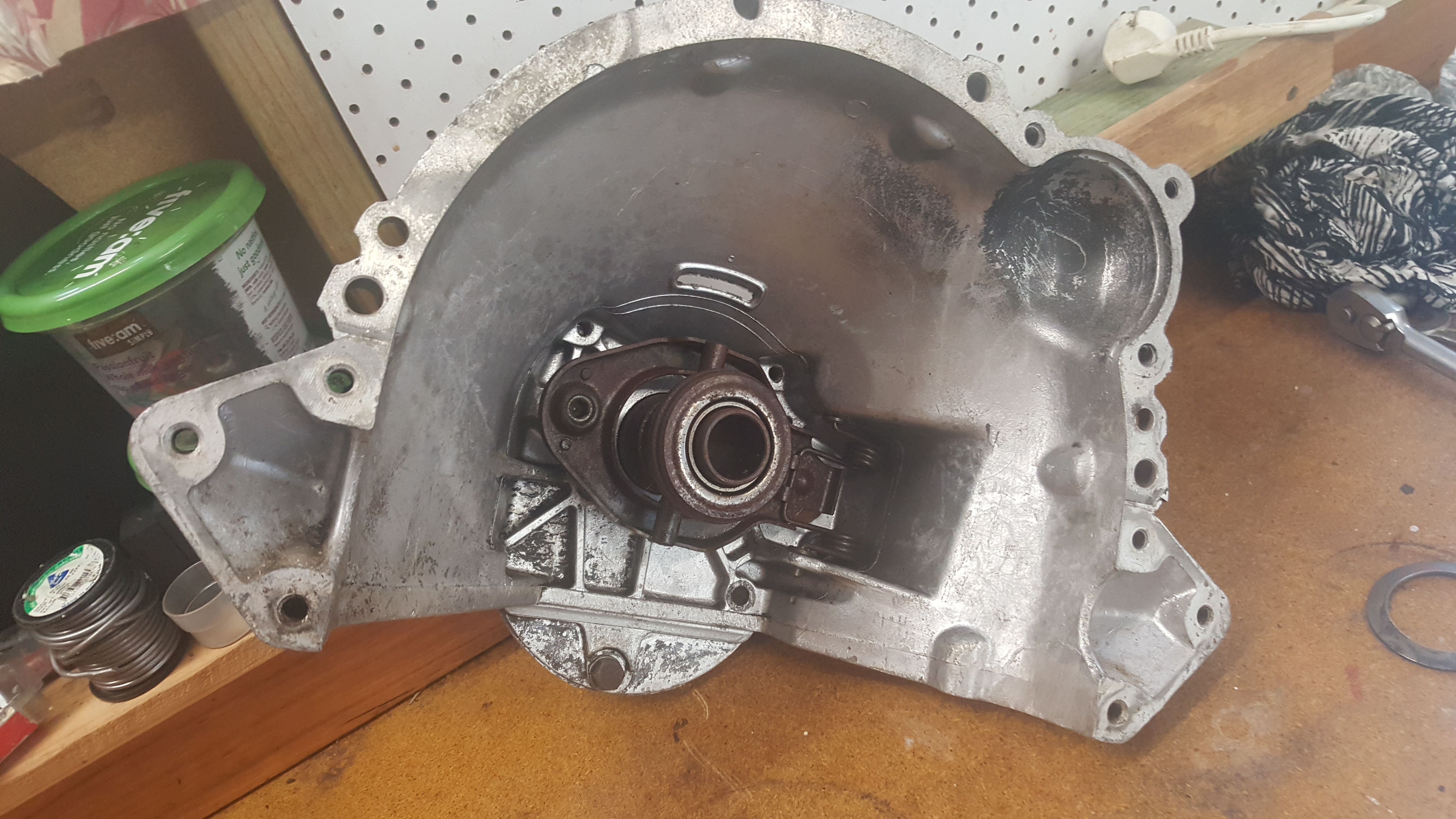

Did a bit more looking tonight, and re-read EJVince's post, and noticed his gearbox had the spring the other way around as per the below pic from his thread.
Looking at EK283's pic on the first page, that one is the other way around that snaps easily around after moving just a few mm.
I beleive EJVinvce's is actually the correct way around, as when I install it this way, I can move the level 10mm and the spring is held in place. It also makes sense the way the clips on the lever are facing, as the mouse trap part of the spring is actually moving in that direction.
Weird thing is my original pics had the same way around as the pics EK283 posted. Maybe its just a mstake people make?

Well done spotting the assist spring the wrong way around.

one more thing - I notice that your bellhousing has red overspray inside where the starter motor goes. Red, not grey. Could you possibly have an early EH 149 bellhousing? ETA: Belay that. In the photo with the new slave cylinder, it's definitely an EJ bellhousing.
