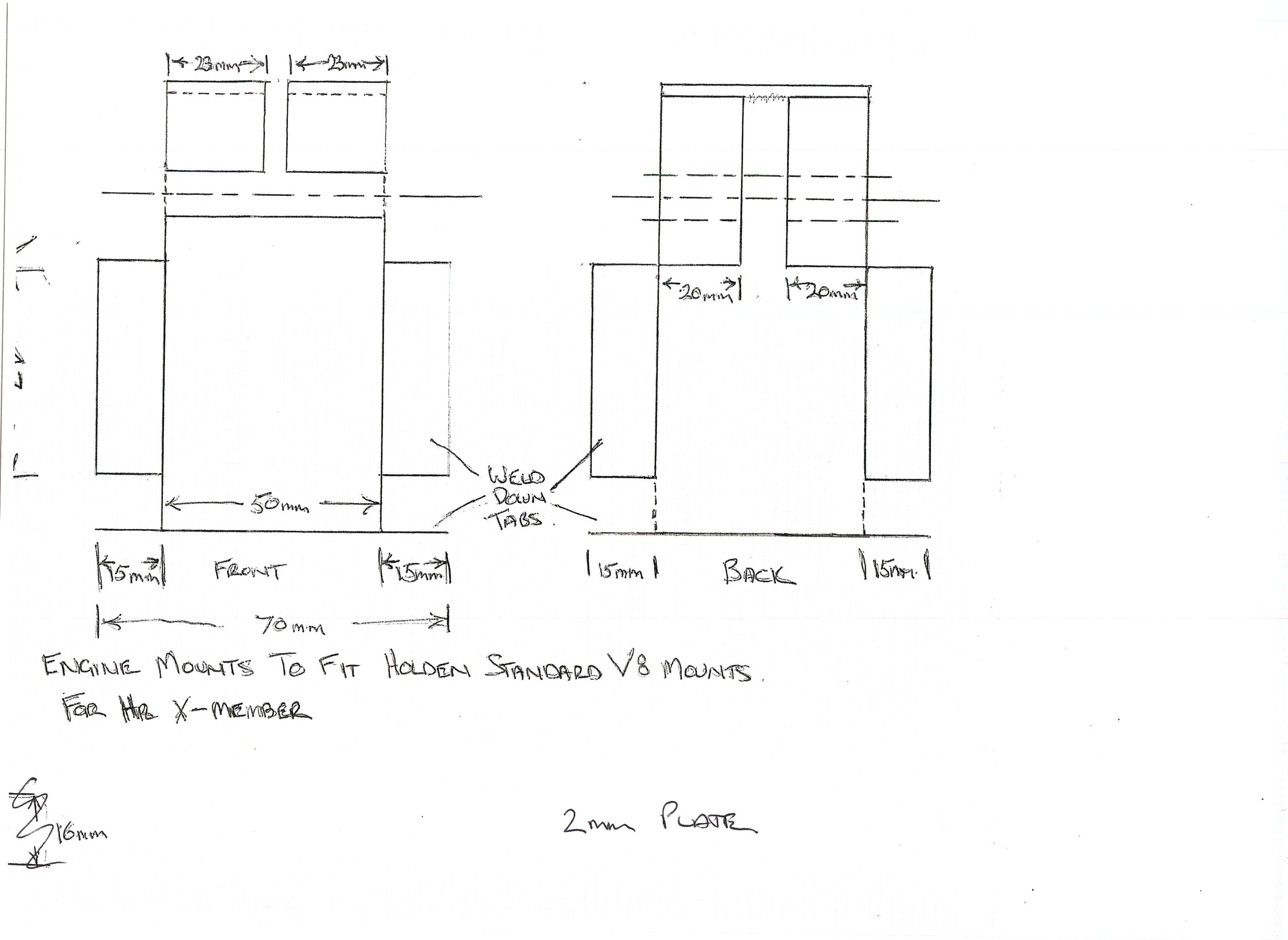

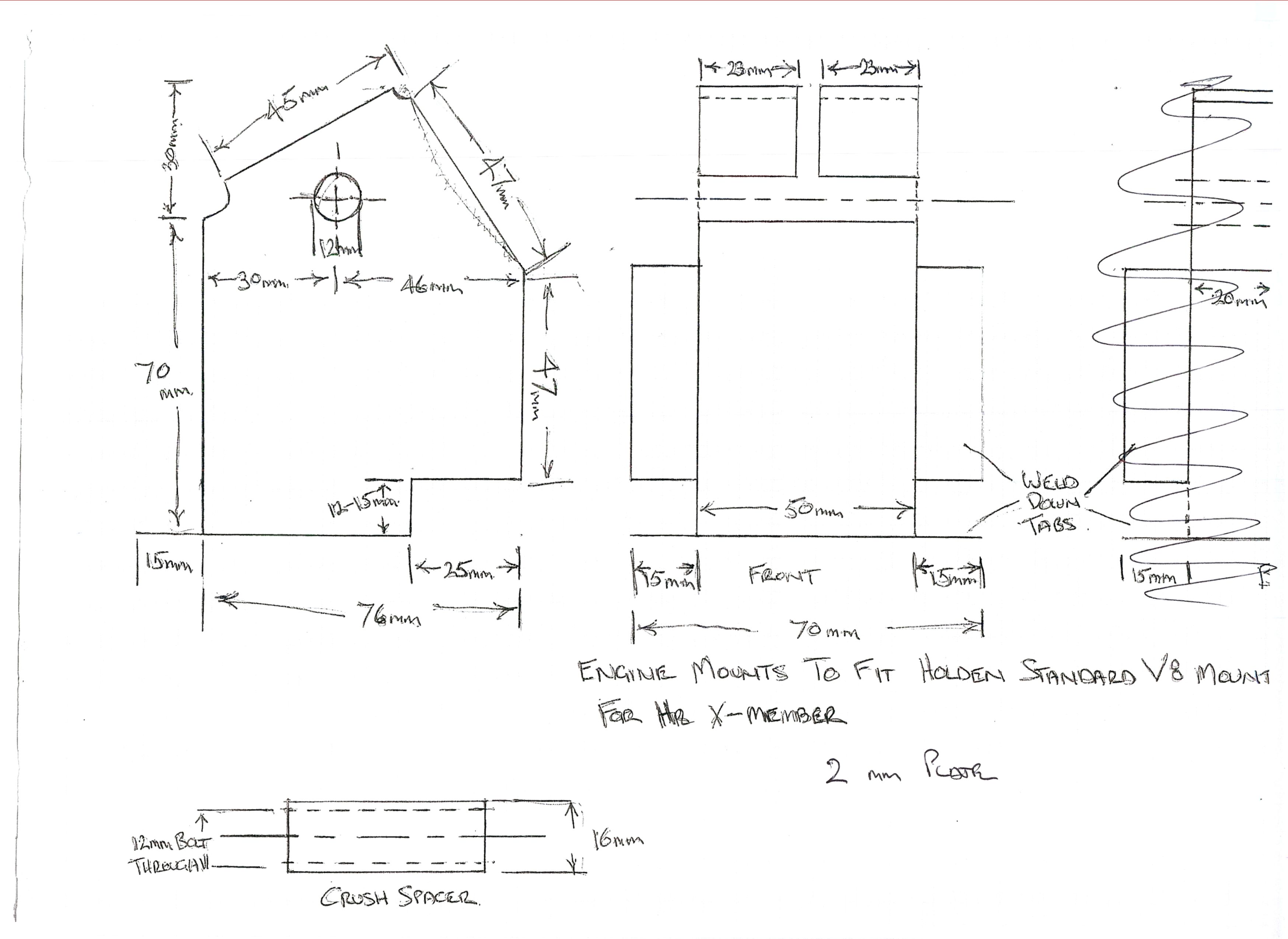

My original drawings that were sent to Pete feel free to use them guys
Bracket Drawings_0001.jpg (428.54 KiB) Viewed 12026 times
Bracket Drawings_0002.jpg (374.79 KiB) Viewed 12026 times
Bracket Drawings_0003.jpg (309.12 KiB) Viewed 12026 times

Re: HD/HR disc front end - re-conditioning.
If you can convert that to a DXF file I can have them laser cut Neil :thumbsup: :thumbsup:
Posts: 2816

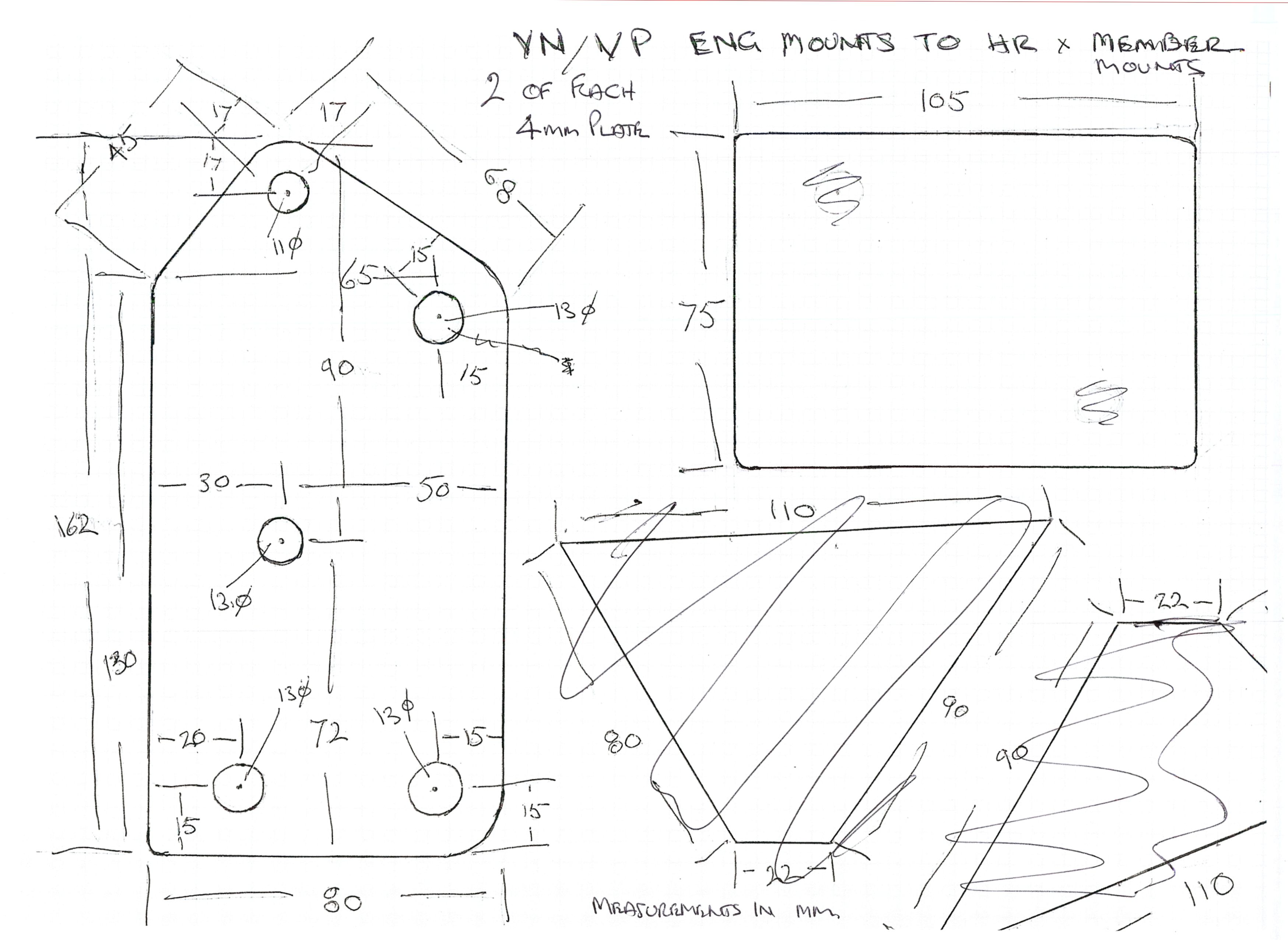

I'll see what I can do Blacky have an acquaintance that is pretty handy with CAD the drawing of the mount unfolded needs to be cleaned up a bit.
These were the other drawings I sent, these were for the engine side mounts for my V6 in to the Ute which I welded up and used, this time for the wagon I have bought CRS.
Bracket Drawings_0004.jpg (565.37 KiB) Viewed 12017 times
Bracket Drawings_0005.jpg (502.84 KiB) Viewed 12017 times
Bracket Drawings_0006.jpg (466.42 KiB) Viewed 12017 times
Posts: 2816
Not trying to be a smart arse just showing not all you read is true :wave:
Posts: 11669
Those drawings are excellent, though I did think you might have done them in CAD. Only a select few of us are privy to your genius mate. Never mind all those poor mugs that try and get by on Facebook.
Posts: 2816
Never used CAD mate (the actual program that is) unless you mean cardboard :lol: :lol:
I'll clean them up and get them into CAD by a friend
