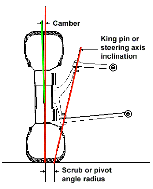

Yep Rosco, the steering arms should always bottom out before the steering box does. If you have issues with one being closer than the other then I would look t making sure the steering box is centred i.e. drop the drag link and check the number of turns lock to lock then centre the box. Your wheel should be straight ahead and the pitman arm should be approx. 89 degrees. There should also be a stamped line on the end of the steering shaft under the horn cap. It should be pointing upwards. Most wheel aligners remove and refit the steering wheel during the process. This is incorrect. The straight ahead position should be achieved by adjusting the tie rods only as the steering box has a manufactured high spot on the gearing which is used to prevent straight ahead wander. If yours is all ok you may have a bent steering arm.
Wider tyres or indeed a change in profile height has a huge impact on steering geometry. Without writing a heap, the changes effect scrub radius and centre point steering which ultimately makes the steering heavier and effects tyre wear.
