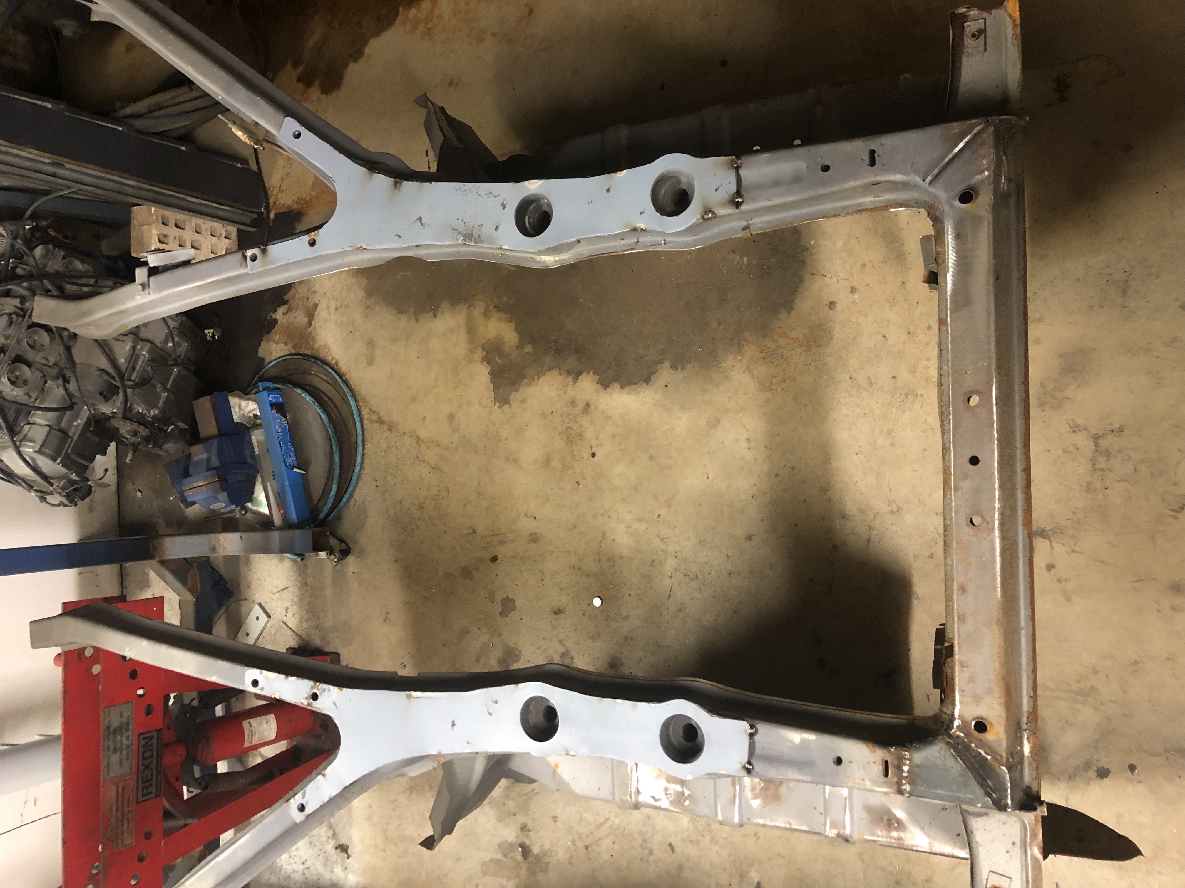

Next piece ready to weld in
gpi
Posts: 1131
Re: Dave’s EK supercharged v6
Post by gpi »
looks a little thin around the sway bar mount,...
DaveEK
Posts: 156
Joined: Thu Apr 22, 2021 1:57 pm
Post by DaveEK »
Same as before. Plate just sitting in at the moment so it’s a bit low once I lift it and weld it, it will be good

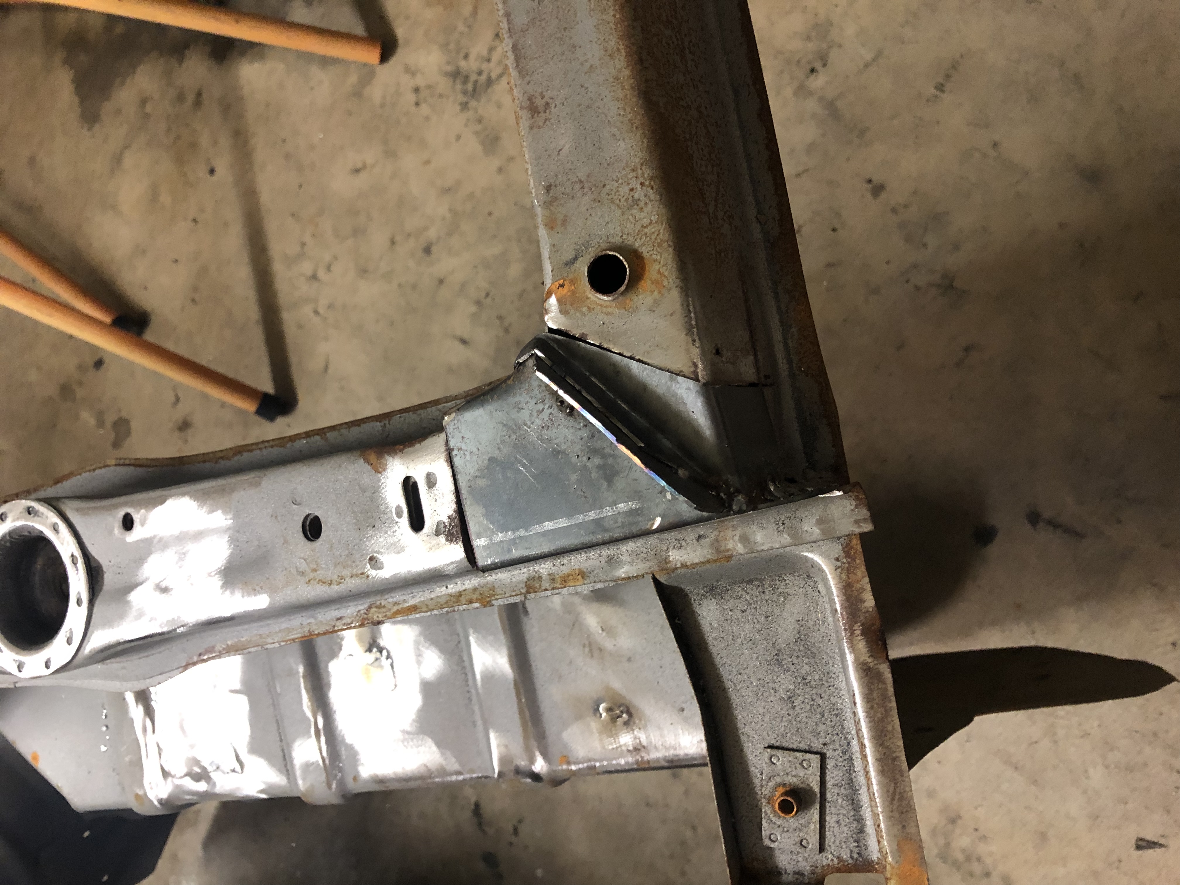

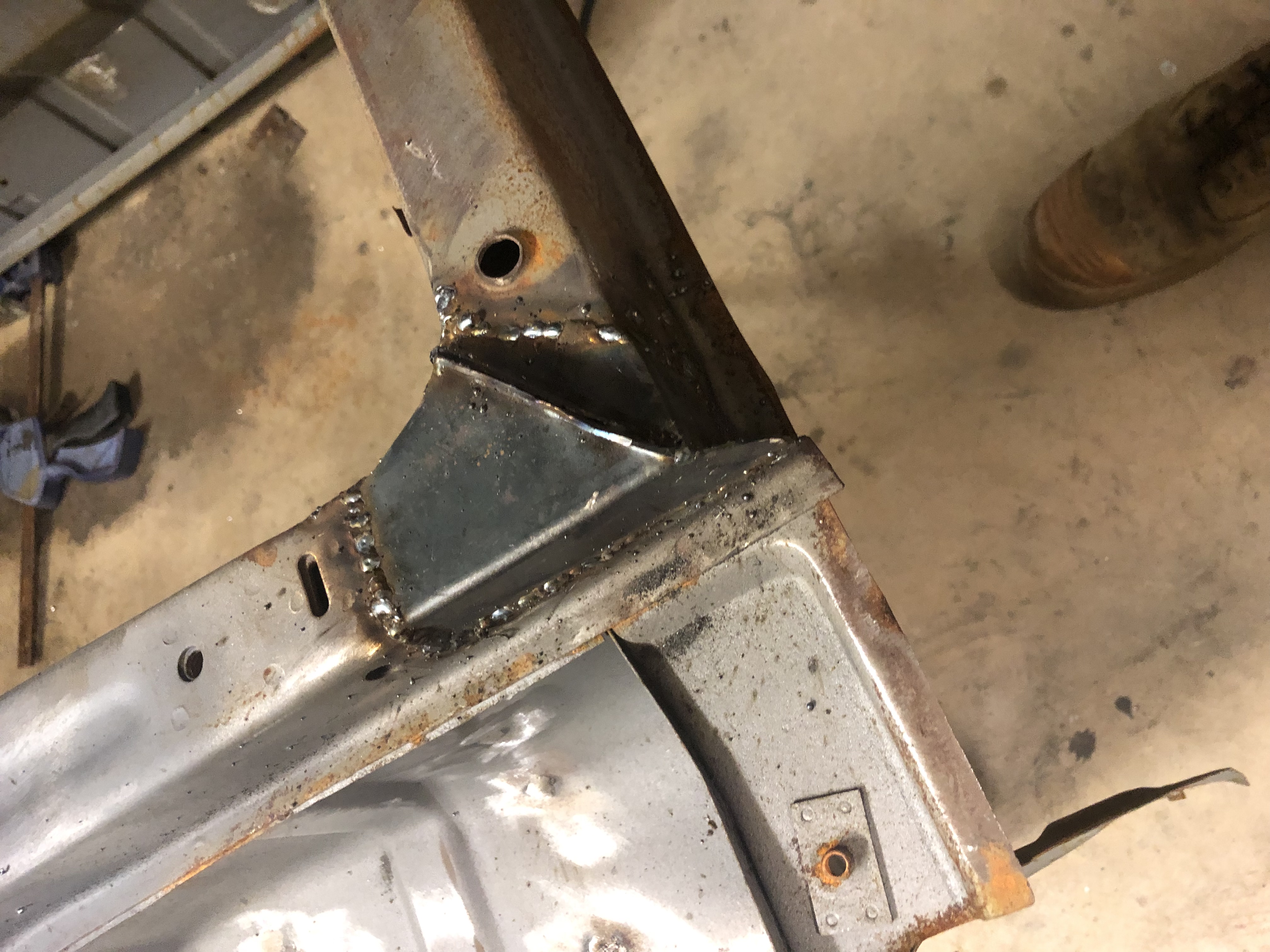

Other corner now fully welded just need to grind back and clean up
Chassis strengthening plates tacked on ready to seam weld
Posts: 11647
Good stuff Dave. Can you tell me what gauge/thickness the reinforcing plates are?
DaveEK
Posts: 156
Post by DaveEK »
Not sure mate but I will measure for you this arvo
DaveEK
Posts: 156
Post by DaveEK »
Errol62 wrote: Thu Feb 24, 2022 10:35 pm Good stuff Dave. Can you tell me what gauge/thickness the reinforcing plates are?
Sorry just checked. They are 3mm
Posts: 11647
Thanks Dave I guessed they’d be 3mm. Thinking about when I do my subframe after the main shell.

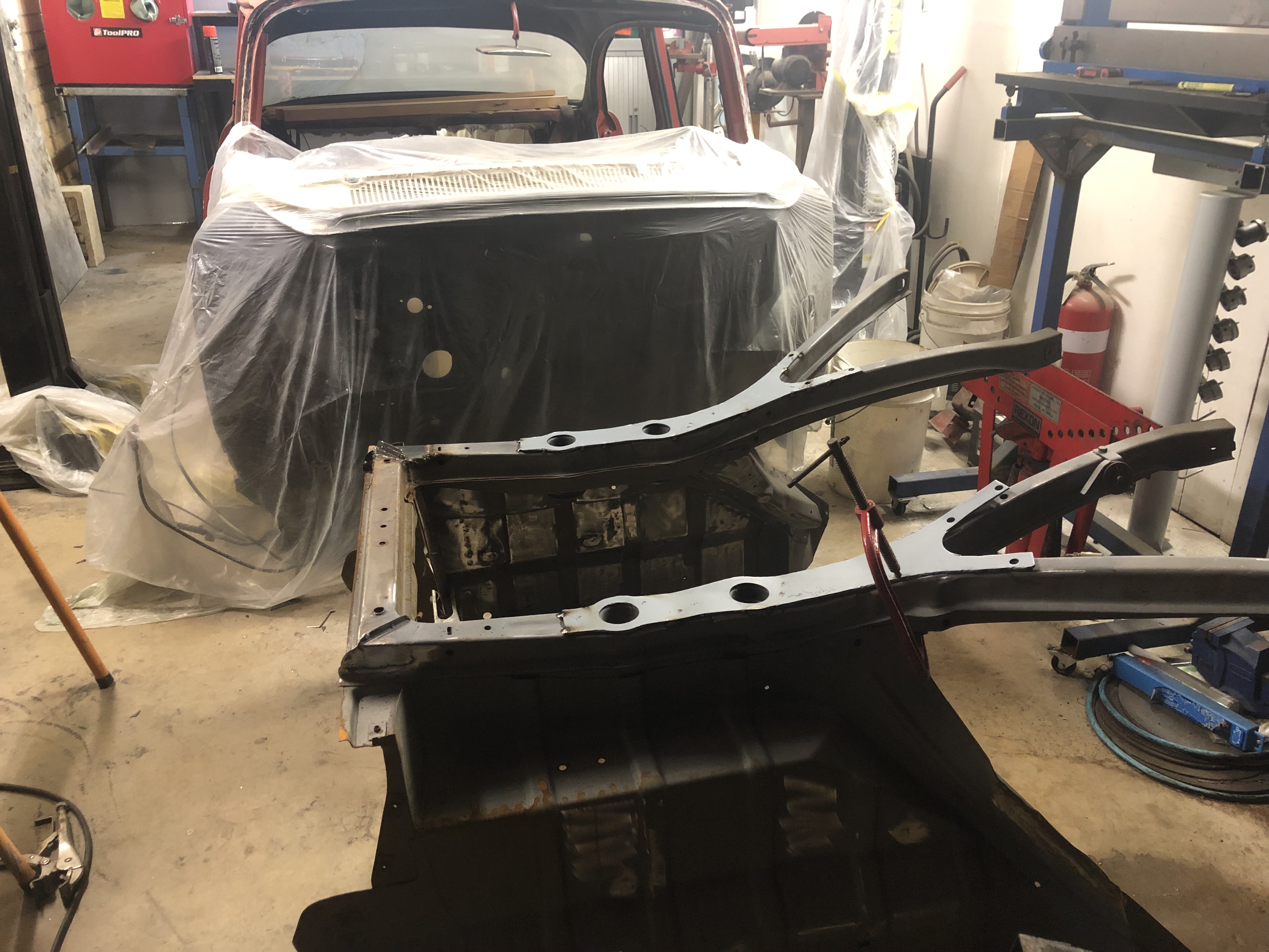

DaveEK
Posts: 156
Post by DaveEK »
I originally had them welded to another front end but cut them off and put on the new one. Much better doing it this way as I originally welded them laying under the car…….never again
