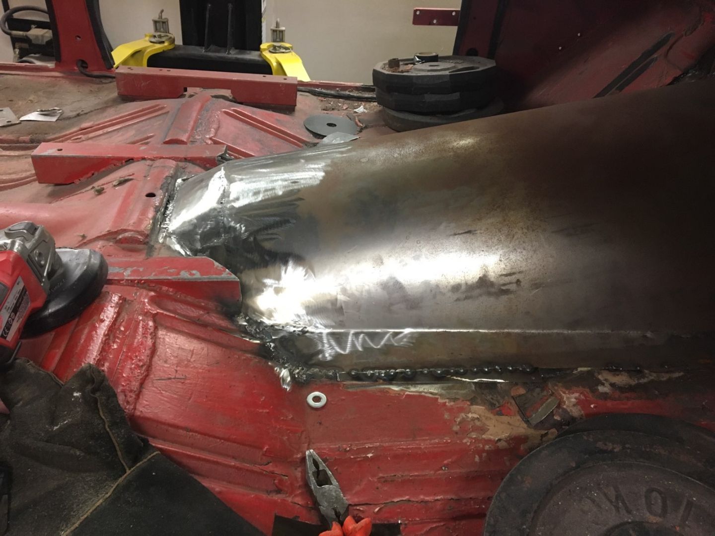

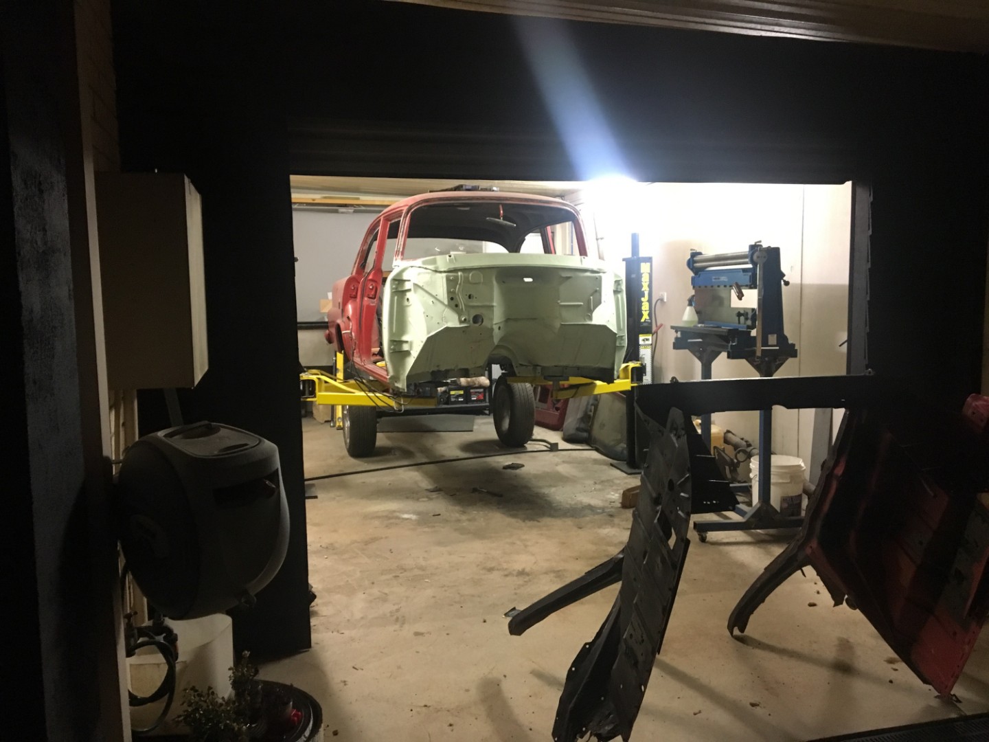

Hey guys I have been building my ek for about 2 years in between many other house projects and family commitments but I got this with already having the Buick v6 conversion done but very rough and messy. So as I took it apart to clean it up I found many problems and rough cut holes in firewall and engine bay which I have finally finished patching and firewall bodywork. So I have bought a l67 supercharge v6 and have completely gutted the old install.

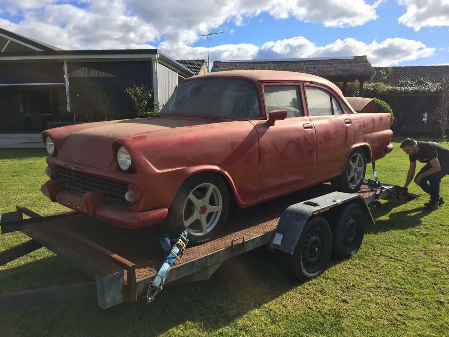

DaveEK
Posts: 156
Joined: Thu Apr 22, 2021 1:57 pm
Re: Dave’s EK supercharged v6
Post by DaveEK »
This is my donor
Posts: 14242
What’s it in ???
