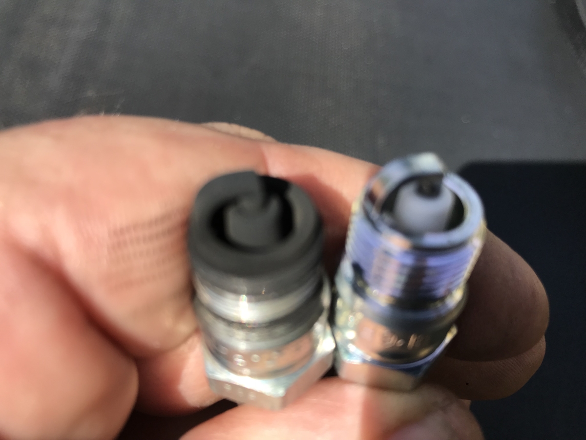

The main drama at the moment though is not so much plug wear, more plug fouling. This is what the rotten thing does after about 10km of driving:
With the high compression ratio, she struggles to get enough zap to light off. A (not so) quick clean, and it starts. Time for some smaller main metering jets methinks. Just got to find the Holley box-of-jets in amongst the rest of my crap.

The fuel of today is just crap sitting around so that could be part of the problem as well.
I used to muck around with jets plugs etc and thought that dynos were for wankers, but the moment I used one it opened my eyes and I will never tune without it.
The fuel air mixture is graphed so jetting is easy,the timing can be measured for ultimate bang and if the tuner is switched on its set and forget.
The dyno will also highlight any other issues real quick including transmission slip etc. I believe its the only way to go especially if your engine is warm as you have said.
Dont worry I have to take 2 plugs out by feel and can barely see them around the booster and exhaust !!

You could also try a hotter plug Harv, I run one range hotter in my drag car with a small block. It will still foul if it is not fully warmed up before it's shut down. Not sure what ignition you have, but may need an MSD or similiar.
Posts: 5649
Re: harvs ek 327 wagon
A hotter plug is good advice. I run a range hotter in the FB, and the plugs come up beautifully. The colder range of plugs that I used to run end up really sooty.
The ignition seems to run OK, or at least so the dyno says. It's an MSD billet dizzy, running an MSD Blaster coil. Pretty simple stuff, but for what I am doing it doesn't need the "features" of a full electronic ignition box.
