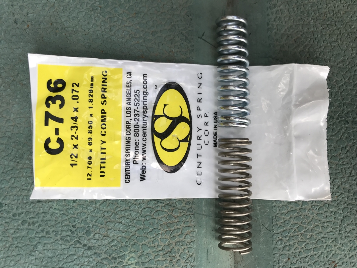

Got the tailgate sorted so it doesn't drop. The internal mechanism was very sloppy, so I had shimmed it up with washers. Too much tension on the mechanism, and the rod return springs could not cope. Replaced the rod return springs with some heavier ones from Bunnings, and all good.

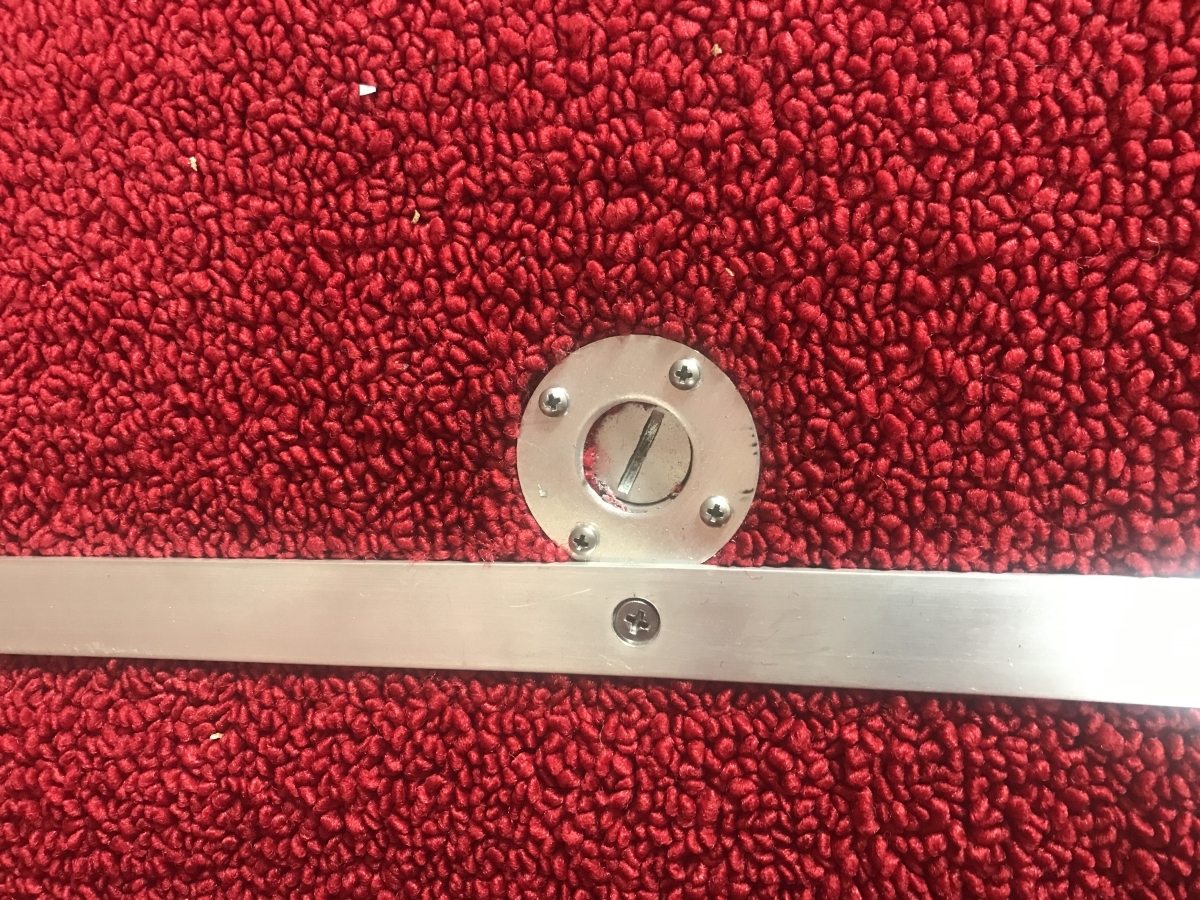

Sorted out the cargo floor latches (recessed them a bit more and fitted fancy cover plates).

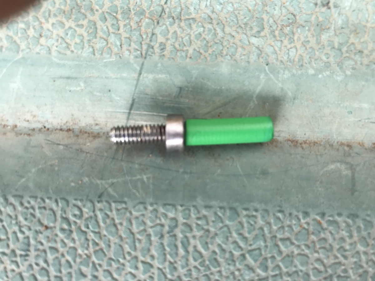

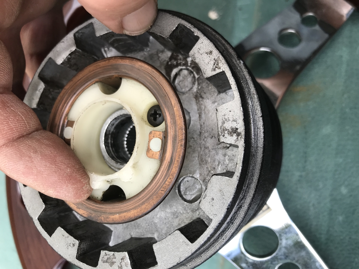

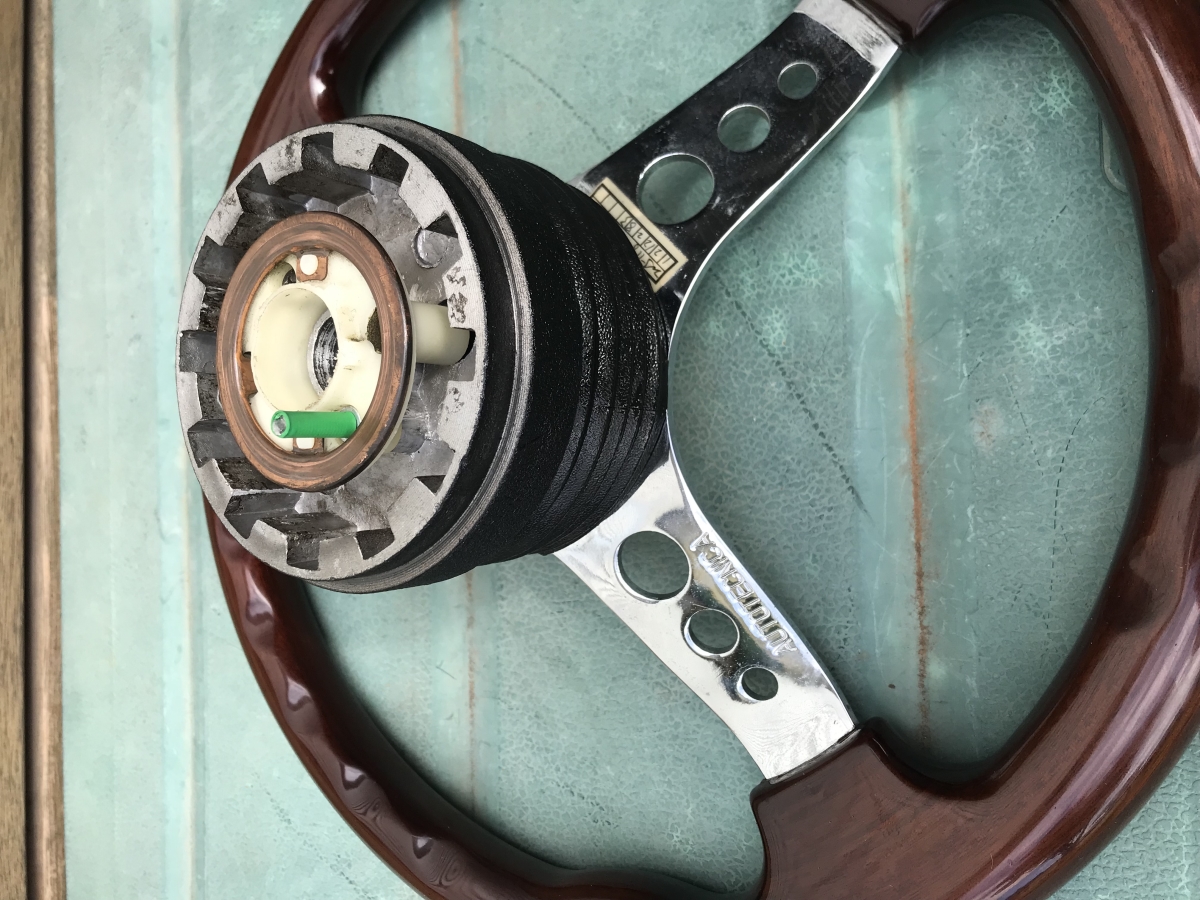

Sorted out why the indicators were not cancelling. The aftermarket Autotechnica steering wheel had plastic "cancelling" pins that were nowhere near deep enough to engage the cancelling springs. Made up a new cancelling pin and fitted. Made me smile... I bought that steering wheel (with an LH Torana hub) from K-Mart many years ago. Not sure anyone stocks LH Torana hubs anymore, let alone K-Mart.

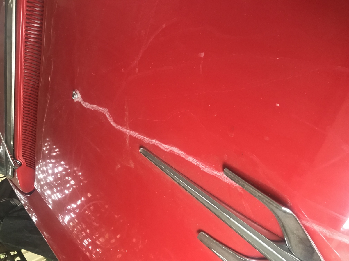

Car needs a good wash and tidy up - lots of smeary finger prints don't make it too photogenic. Washer bottle has decided it wants to dribble out the washer jet when the car is sitting around, despite the plumbing being all uphill . Jet is mounted EK-style in the bonnet, so water trails down the bonnet. Will fit a late-model non-return valve and see if that helps.

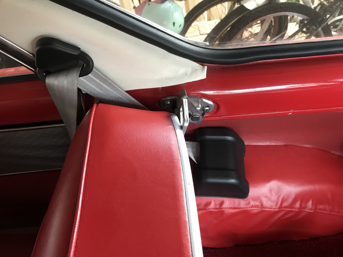

Hi Harv,
With the location of the sash guide where I think it needs to go on the rear pillar in accordance with the code, and then having the retractor horizontal on top of the wheelarch, it appears that my seatbelt will be pulling at an angle over the rear seat top bracket. Just wondering if you found that?

Hey green wagon I used Harvs seatbelt guide too and yep seat belt runs over the top of the seat brackett
on my wagon I fitted a small piece of tube onto the top of the brackett so the belt ran smoothly over the top as per my engineers suggestion I can send you some pics if I can get it to work I'm having trouble posting pics aswel

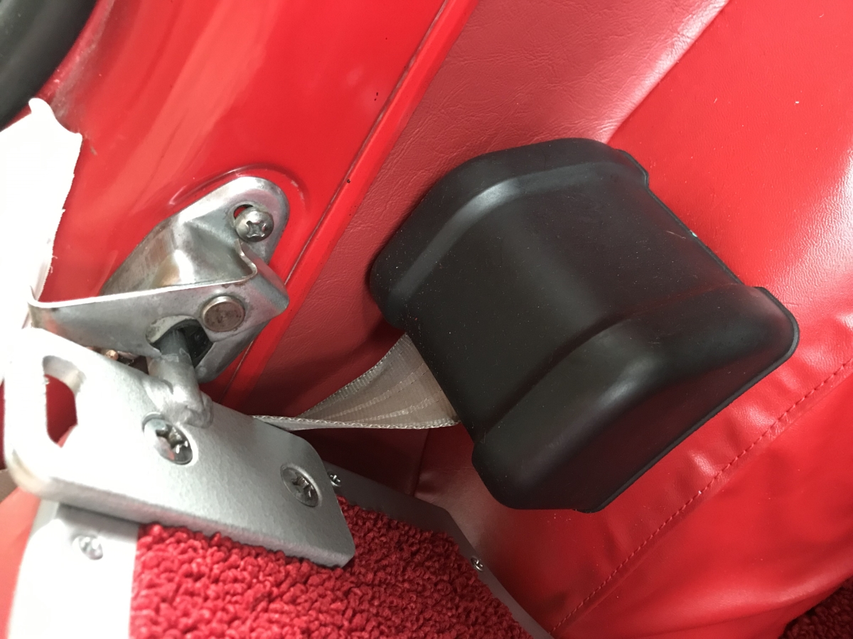

The main drama with trying to comply with the NCOP code (and hence ADR) for seatbelts is that it is a very "measurement heavy" process. Depending on how far apart you put the side belts on the floor (the "bumcrack line" from the Guide), the sash guide location varies a lot. This is why I send people the Guide, rather than just a distance up the B or C pillar.
When I did mine, I ended up with the rear belts running under the seat bracket.

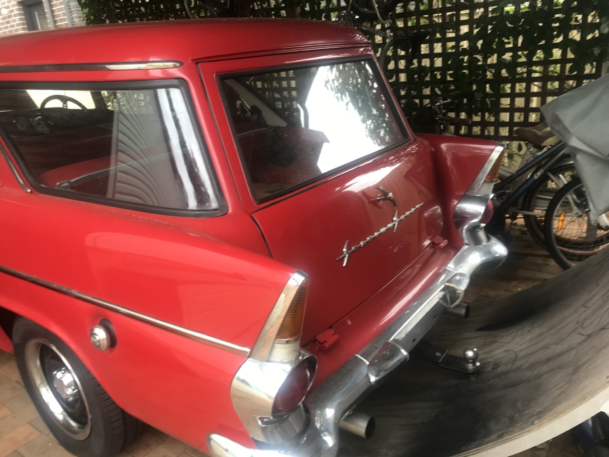

Some photos below. They are not overly artistic, the car is filthy, and in bad need of detailing. They give you some idea though.

... and this time with the tailgate shut after fixing the latch springs:
Optimized-Rear quarter.JPG (647.87 KiB) Viewed 736 times
Fancy Dzus fasteners I used to hold down the rear cargo floor (and the circular cover plates I had to add after finding out that that the carpet depth made them no longer work the easy way):

The results of my incontinent windscreen washers:

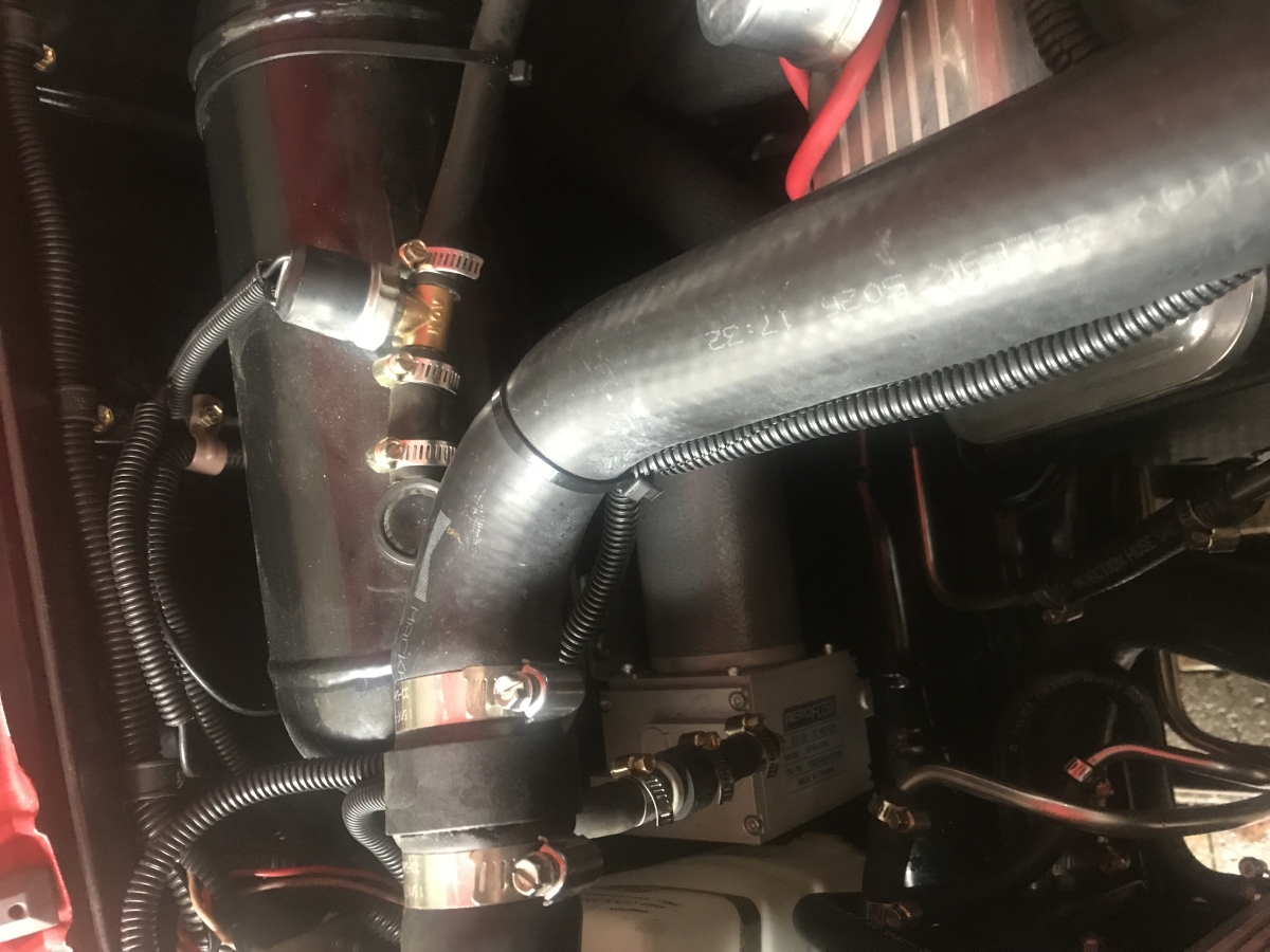

The vacuum tank and electric pump I had to add because the cam overlap left no vacuum to drive the brakes. The transmission cooler hose at the bottom of the photos is the one that decided to fall off during the last highway test run:
Optimized-Vacuum tank and pump.JPG (612.77 KiB) Viewed 736 times

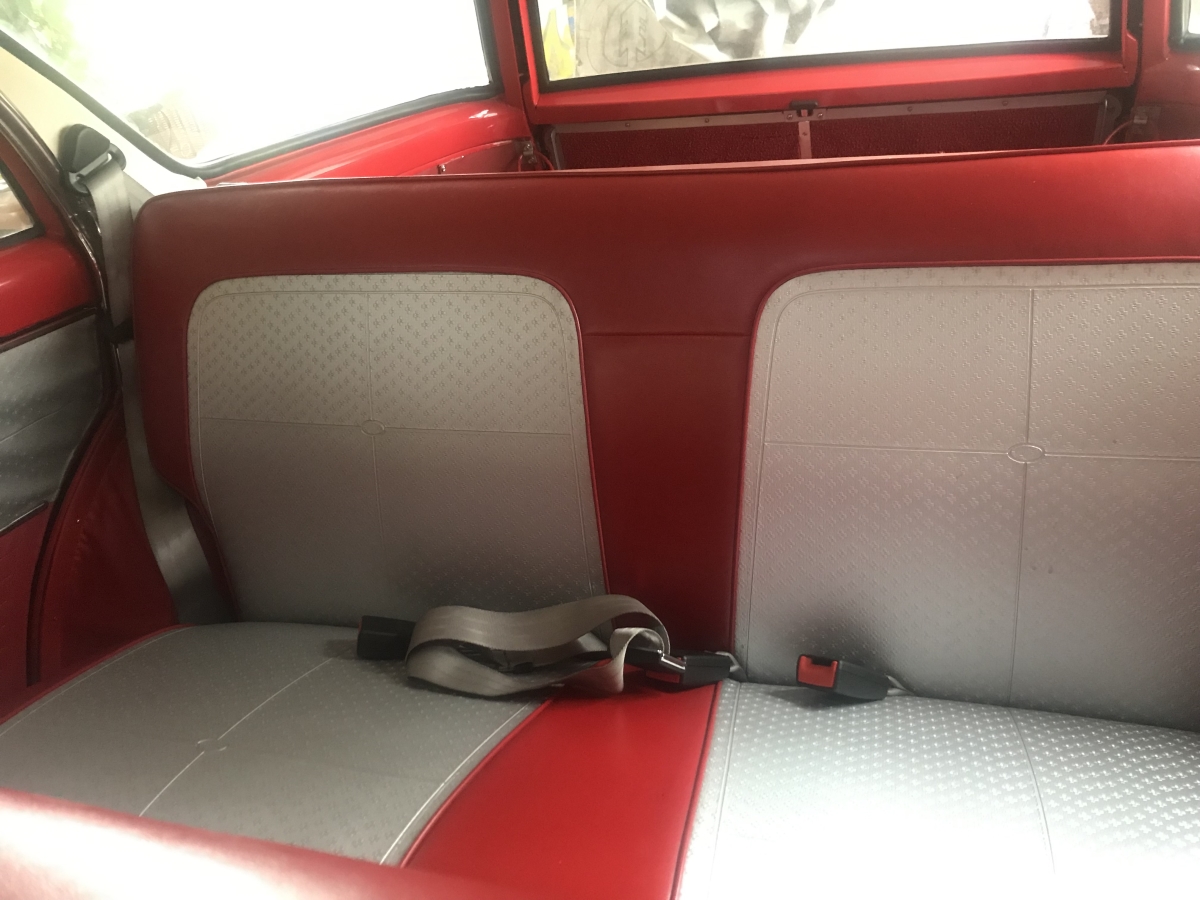

Rear seat:

Steering wheel with dodgy cancelling pins (too short to reach into honeypot and grab the cancelling springs):

Home-made cancelling pin:
Optimized-Replacement cancelling spring.JPG (611.07 KiB) Viewed 733 times
Cancelling pin installed in lieu of one of the mounting bolts:

Replacement tailgate spring from Bunnings (above, after shortening) with original spring below:
