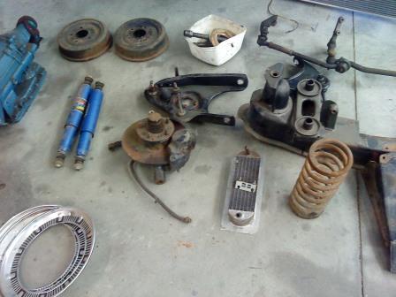

what's leaking exactly? Is it the core or the heater valve? I'm assuming you have a warmaride unit fitted. If you have no luck I have a Hemco fresh air core that bolts directly underneath the plenum flap. It doesn't run a fan and relies on having the vent open to get air across it.
Its shown in the picture below.
