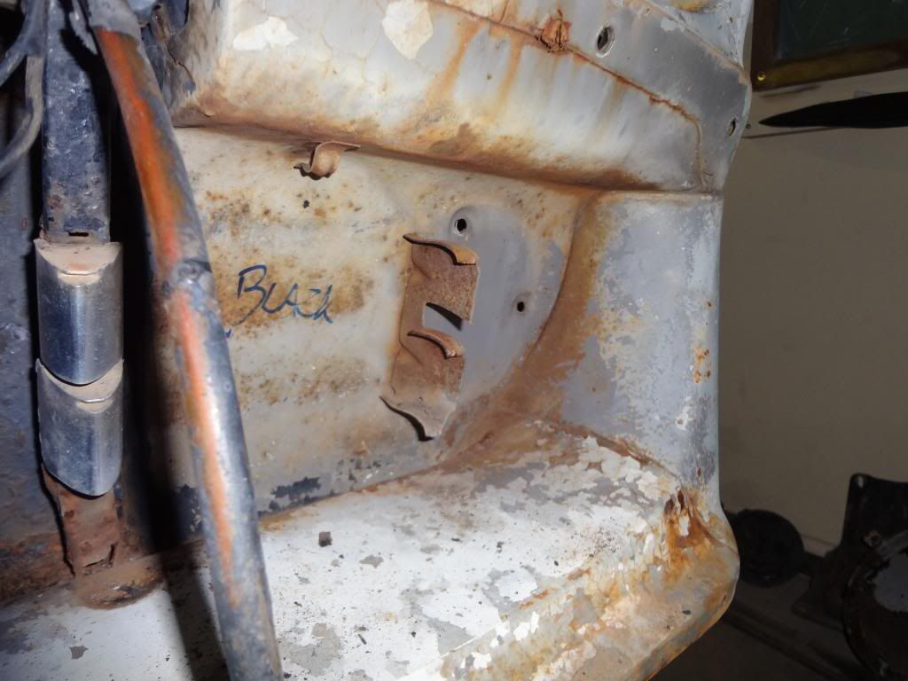

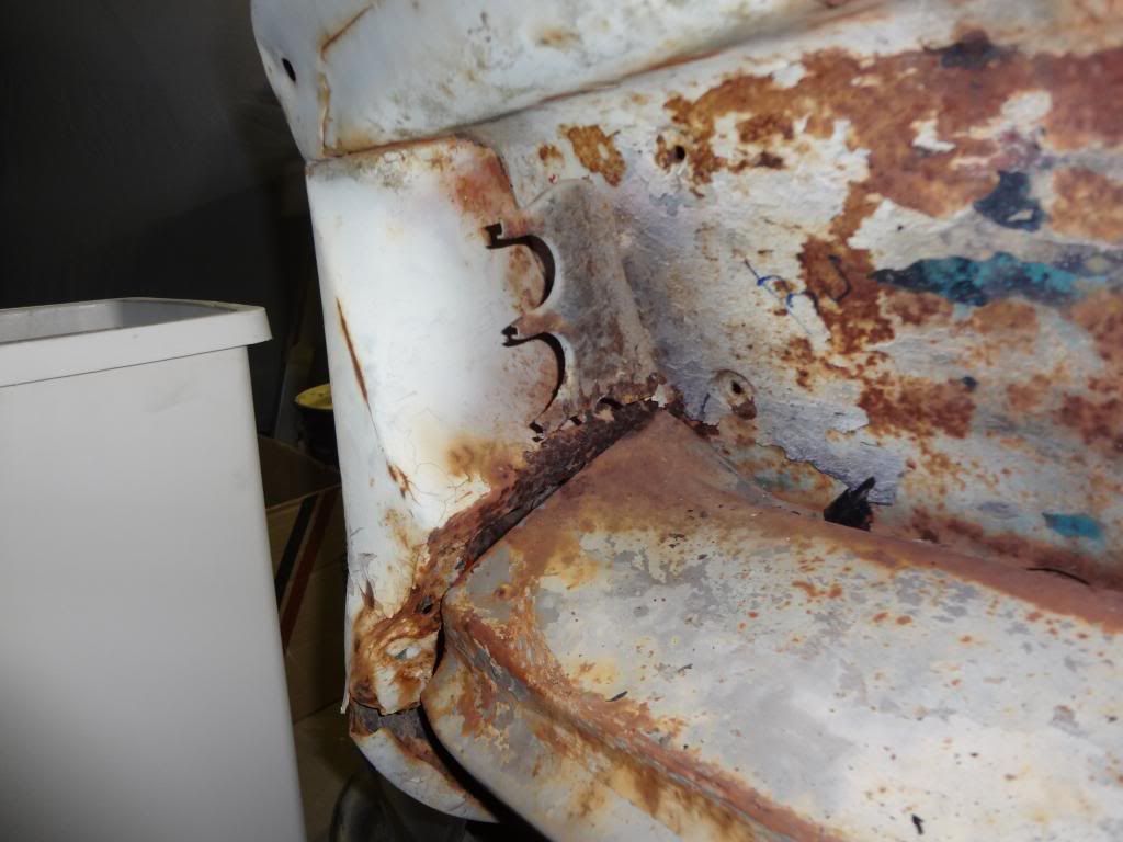

Okay, have taken a photo of the two guards on the car. I have also checked the 2 spare guards as well and they are just like these....
THE PASSENGER SIDE
THE DRIVERS SIDE
Shouldn't the grill brackets be the same? Please correct me if I am wrong but I think the FB grill brackets should be like the Passenger side.

Pass side is FB

Driver's side = EK
