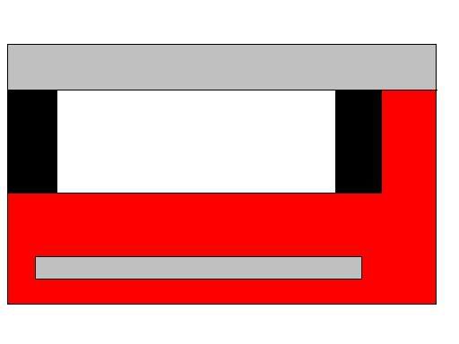

Any ideas on painting multiple colours on a car. Acrylic paint.
Painting experts or anyone who has done this before ?
Assume an FB, Body is Red, side colour is Silver and top half is Black, with Silver roof.
Black borders on Red and Silver is bordered by Red.
Picture shows how colour join.
Now the Black is straight but the Red and Silver are metalic/pearl, so they need a clear coat over the top.
What is the process for masking up and painting the various colours ? :? :?
At this stage I am looking at.
1. Mask out all non black parts of car and paint the black areas.
2. On another day, when black is dry. Mask out all non silver areas, paint silver areas, then paint clear top coats.
3. On another day, when silver is dry. Mask out non Red areas, paint red areas, then paint clear top coats. This is the main body colour.
4. When all dried, sand/cut/compound/polish back the top coats.
Any alternatives ? Or can the silver wait before the clear coat is applied ?
But then it couldn't be masked for the red painting without sticky from tape being left on paintwork and under clear coat.
Example pic so you get the idea.

So I'm planning these stages ?
2. When black is dry. Mask out the black painted areas, paint car with metallic Red. (Doors, bonnet, guards, tailgate are painted separately as they are still off the car)
3. When Metalic Red is dry. Mask out non Silver areas, paint Silver areas.
4. Clear coat the entire car.
5. A few days / weeks later, sand/cut/compound/polish back the top coats.
Only issue is lining up the Silver on the front guards, front and rear doors and rear section, without having the doors hinged and lined up on the car.
If I hang the doors, then don't get into the hinge areas that well when painting. :? :? :? :?
Paint the door jams, inside the doors tailgate bonnet etc, then put them on the car and paint it all together!
Trev 8) .
