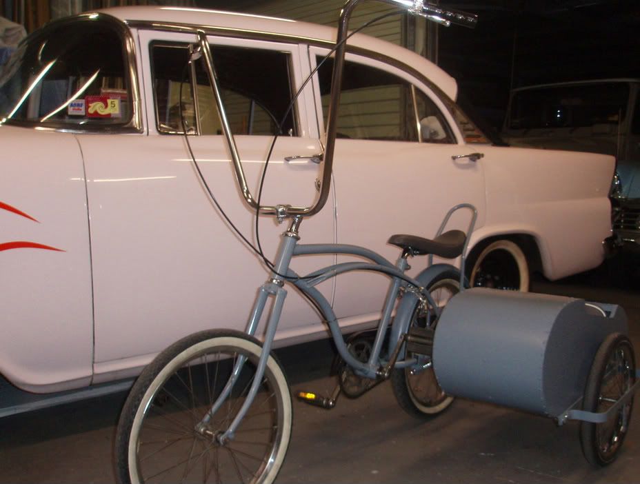

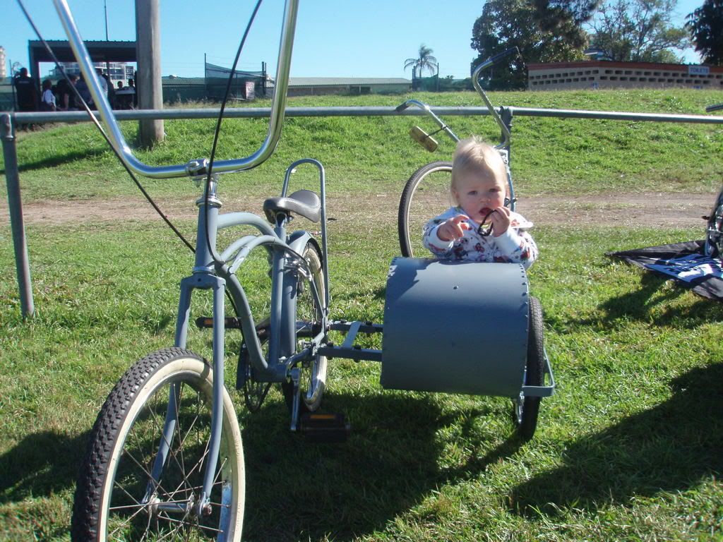

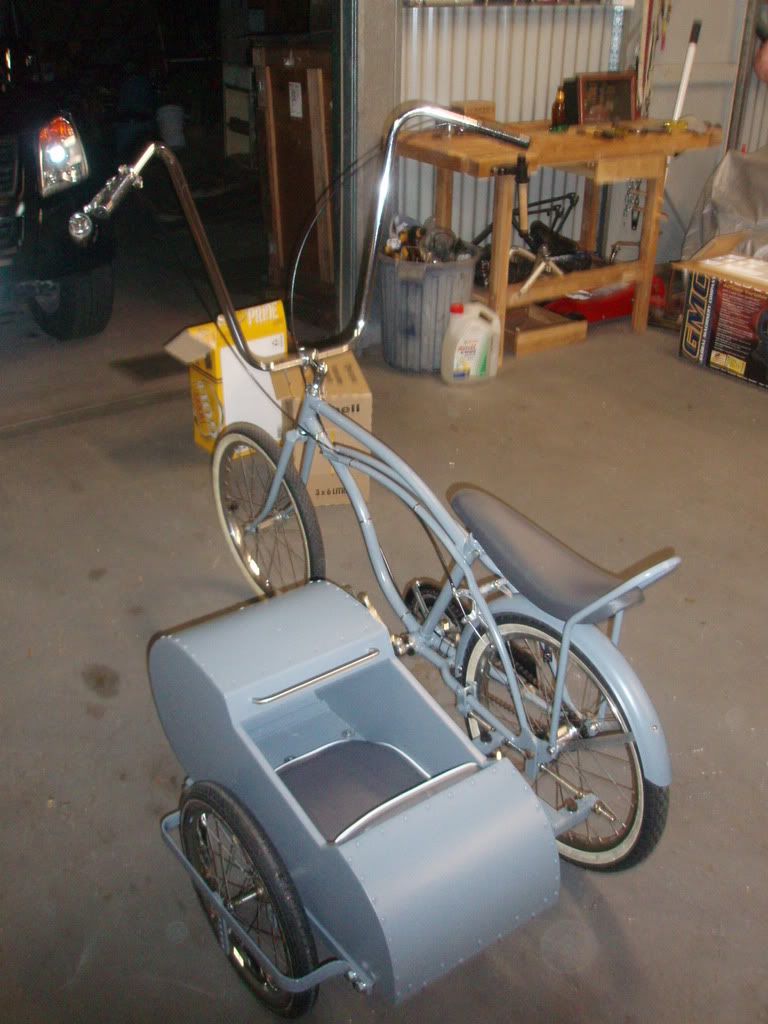

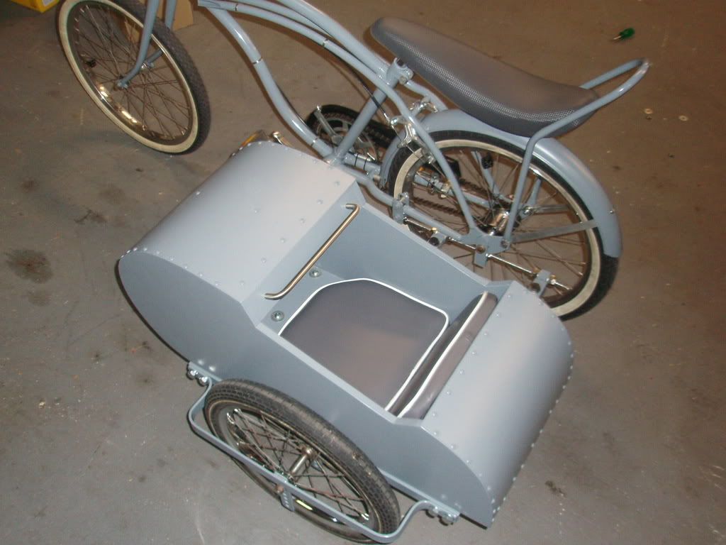

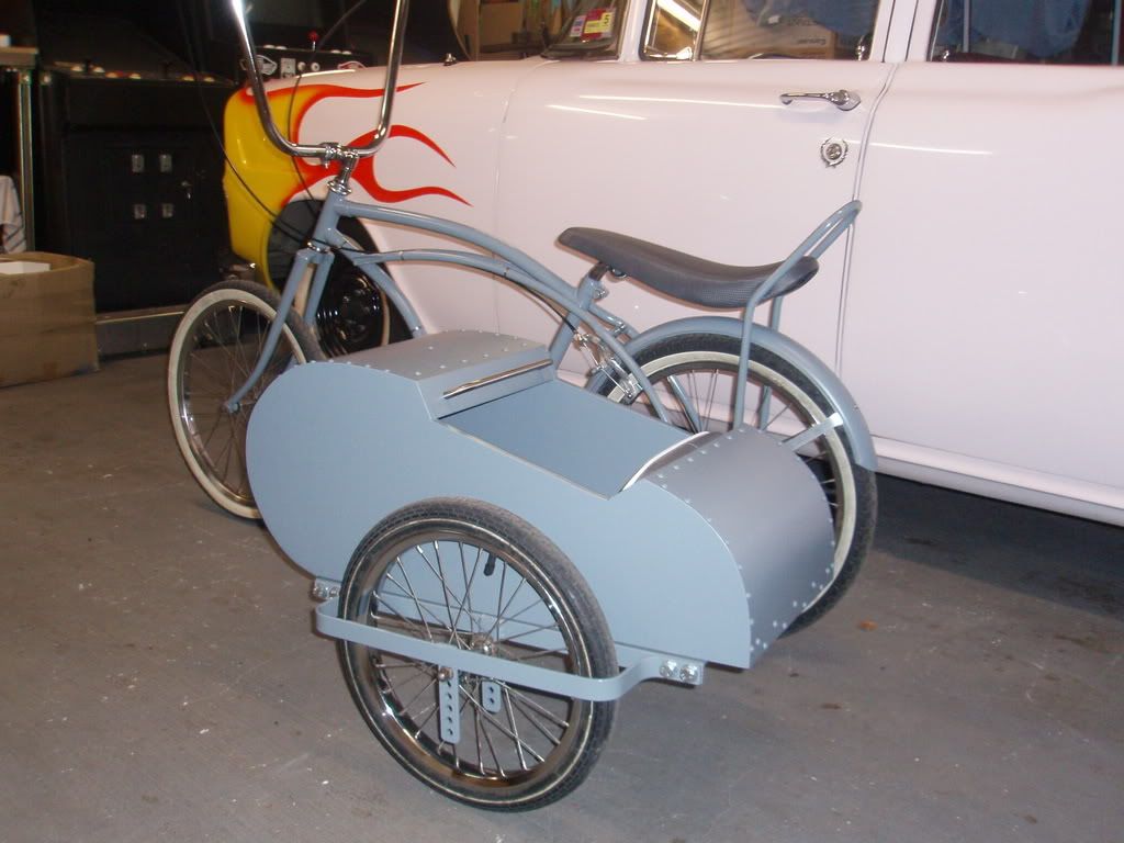

Hey Peeps,
Just finished my latest project the night before Greazefest.
Here are some snaps.....
It runs a 3 speed shimano internal gear hub (1970s issue) with a sturmey Archer trigger shifter. The sidecar is mounted to the bike utilizing a pivot bar so the bike can lean independently for proper handling.... its not rigidly welded to the frame.... it handles beautifully.
Remember a family who rides together stays together
Pods
