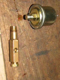

well now i got great oil pressure
after sprending all day worring and thinking
i finaly got home and tryed every ones suggestions
still no pressure seconds away from pulling the engine out and crying
i removed the brass extion fitting a pow lots a oil
i had my master gauge hooked into the bung in the end of the fitting and sender
goes in side hole i had to have this for for clearence issues with the moon gauge sender
checked for blockage all ok the hole through the centre was only small
so maybe when i tighted it up it was crushing close????
a 7mm drill later and fitting it bang lots a oil pressure
why would of thought
