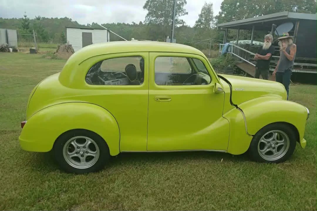

bought another one this one 2 door sedan (converted 2 door) tons of mods body channelled over chassis, tilt front, lj torana front suspension, volvo diff, SR20DET engine and auto

Fun 8) :thumbsup: :thumbsup: looks like its intercooled ? Needs more turbo :twisted: :twisted: :twisted: :twisted:

That's pretty cool Mick

wow - I looked at this on my laptop last night and I thought it was yellow with a little bit of a green tinge - looks MUCH greener on my work computer !

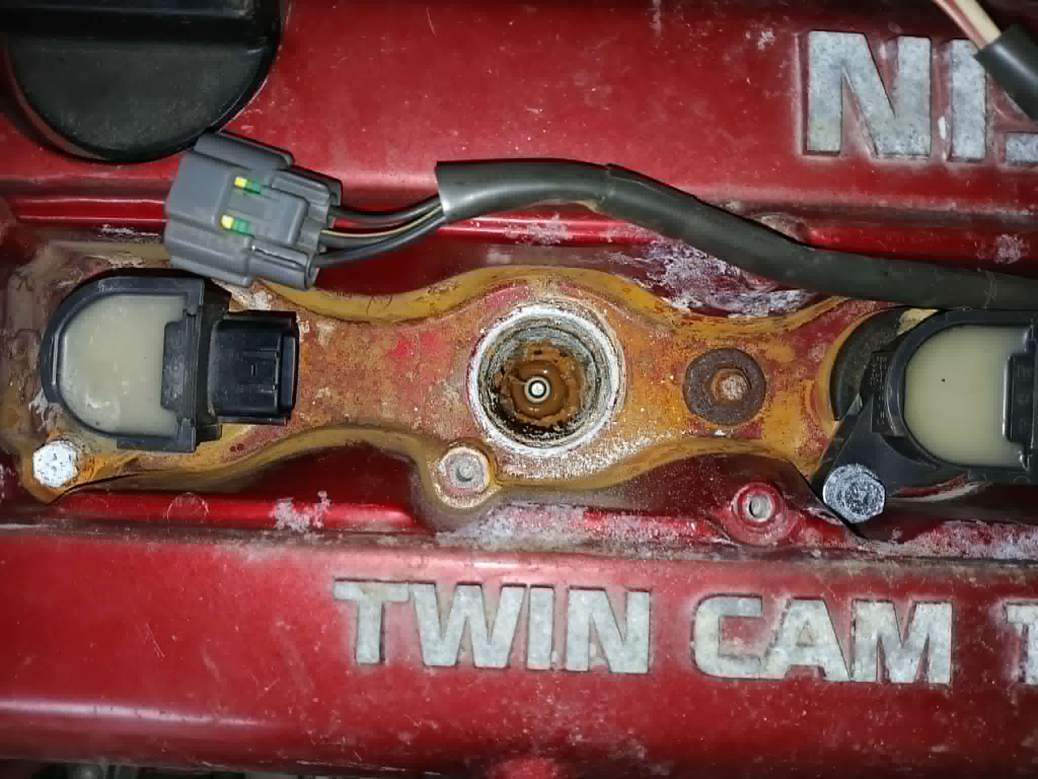

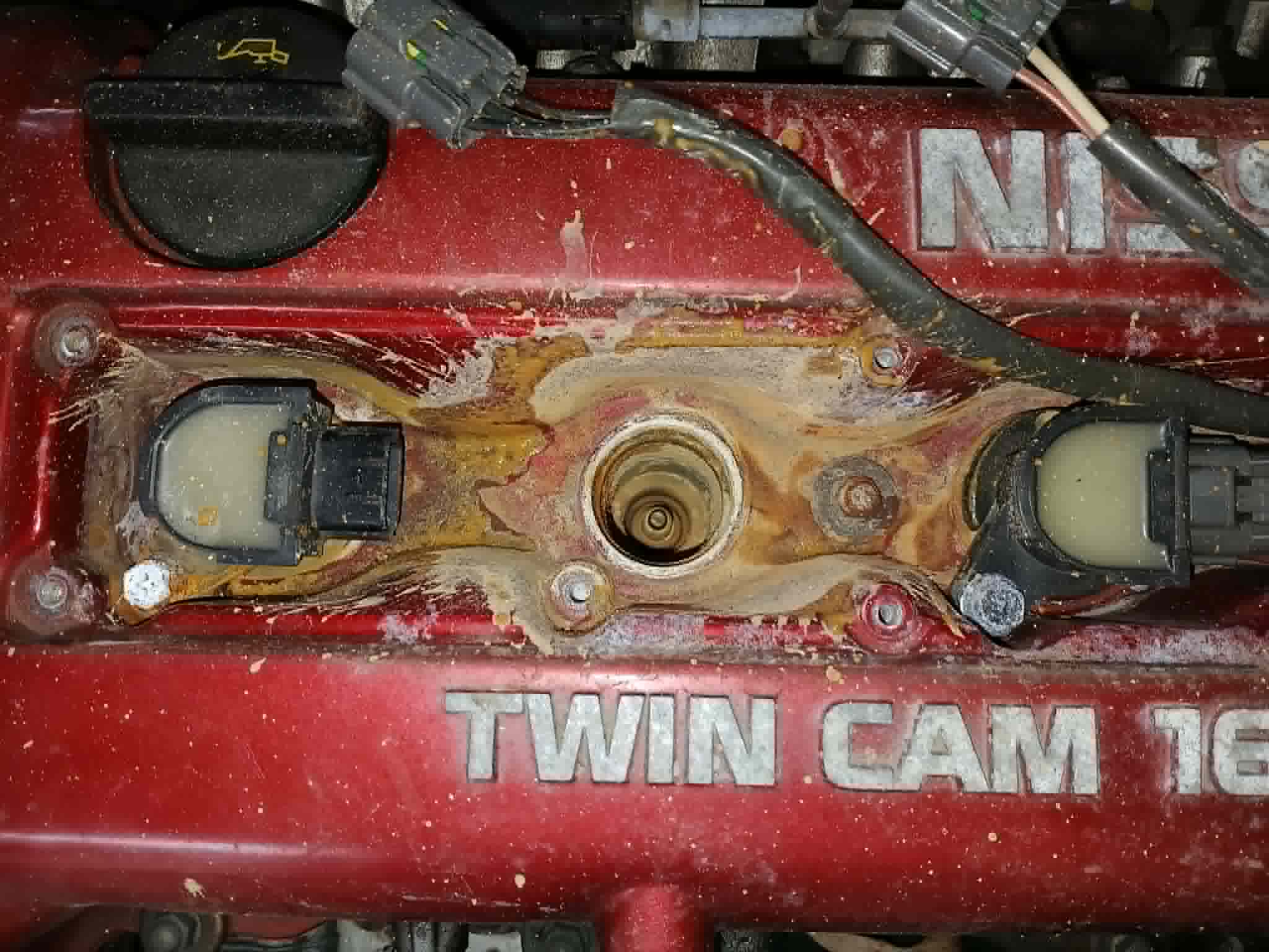

yeah factory turbo and intercooled all out of a 180SX, have to get it sorted first looked at it and drove it 18 months ago went like a bullet someone else bought it and story goes didn't drive it much and passed away (so no information) but now it isn't going well fine when cold but the more it warms up the worse it runs to the point anything over 2000rpm it just completely breaks down but only under load, i'm hoping coil packs and plugs but who knows on an engine with a computer and a hundred sensors on everything, but heat and load and the fact 2 of the 4 plug tubes were half full of water for god only knows how long and a third had had water also isn't a good sign for coils

Yuk - that certainly wont help - I think you have found the problem there mate :thumbsup:

it's all been cleaned and put back together, it's better but still not good i'm hoping that the water being in there so long has killed the coils

can ya swap them over and see if the miss moves with it ???

not really a miss as such it just totally breaks down

Ah well, just had a look - a new set is only a couple of hundred unless you buy cheapies off Temu or Epay …..

nah these take a different coil to a standard SR20 4 coils $964 :shock: and that was mates rates, though after looking could have got genuine Nissan for $190 per coil, even cheapies on ebay were $400 to $500 per set, done now better but still not great fine when cold but once warms up seems just as boost is coming on it breaks down though if i accelerate slowly seems ok, injectors out to be cleaned and flowed next
