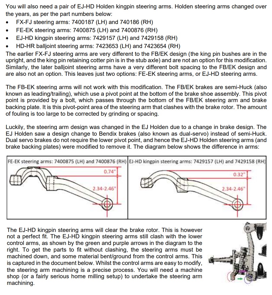

Some info below on the steering arms, from my post on putting the Mitsi vented disks onto the kingpin front end:
viewtopic.php?p=229694&hilit=db005#p229694
Excerpt below:

Clay,
An editorial change first: HD/HR front drum brakes have 2-1/4" width linings, EJ-EH are the same width as FB/EK at 1-3/4", although EJ/EH brakes are duo-servo and FB/EK brakes are semi-huck.
I have an HD front drum brake, with backing plate, stub axle and upright. So I can check the interchangeability of parts. From memory, FB/EK stub axles have two through holes - the lower ones, and two threaded holes - the upper ones. EJ-EH and probably HD king-pin stub axles have four through holes. Ken McLean alerted me to this after I found a "rogue" king-pin and upright assembly with all through holes on the stub-axle. I thought it might have been early FE, but Ken said it was most likely EJ/EH.
You'll need to replace the FB/EK steering arms with EJ-HD steering arms, and then there are a couple of ways forward: bolt the HD front backing plates onto FB/EK stub axles, using two shorter 3/8" UNF bolts at the top to go into the threaded holes in the stub-axle, or . . .
use EJ/EH uprights and stub axles on the FB/EK front suspension, and bolt the HD front brakes to the EJ/EH stub axles.

You wrote, "I can’t quite get my head around the need to use the later steering arms, considering the backing plates fit the original stubs."
Yes, they do, but -
In FE-EK brakes, the braking effort from the primary shoe is taken by the big anchor bolt at the 6 o'clock position, and then transferred to the stub axle via the steering arm, because the anchor bolt goes through the steering arm. The components are dimensioned so that the anchor bolt is as short as possible, which means that the steering arm sticks into the brake assembly quite a way, almost to the plane of the brake shoe webbing.
In EJ-HD king-pin brakes, the anchor is now moved to the 12 o'clock position, above the slave cylinder. The bottom of the brake shoes, where the adjuster now is, is free to move. This feature allows the braking force generated by the leading shoe to be transferred to the trailing shoe, increasing the self-servo action. In these brakes, the braking effort is transferred from the anchor pin to the stub axle via the backing plate. This is why EJ-onward backing plates are so much beefier than in FX-EK. And the change in brake geometry necessitated a redesign of the steering arms: no need for the anchor bolt hole in the steering arm, but also, because of their shape, FE-EK steering arms will foul EJ-onward adjusters and backing plates.
Hence Harv's steering-arm diagram above.
Posts: 11669
Re: Duo servo front brakes
Thank you sir. I get it now. I recommended he get the entire drag link and pitman arm etc for a steering upgrade while he is at it.
