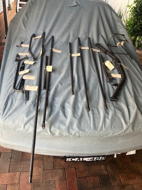

Yep. The bloke I was using was good value. Everything you see in the photo below, plus a mangy sump, for $1500 inc. freight.
