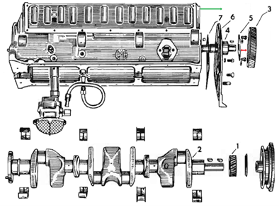

In a grey motor, the crank gear (labelled 1 in the image below) is pressed onto the crankshaft as far as it can go (until it bottoms out on the crank snout, labelled 2 in the image).
exploded diagram.png (82.09 KiB) Viewed 6978 times

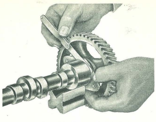

The crankshaft is fixed into position in the block by it’s bearings. This means that the crank gear can be located in only one position in or out of the block (in the direction of the green arrow in the image). The camshaft gear (labelled 3 in the image) however has a few more variables. The camshaft retaining plate (labelled 5 in the image) mounts onto the camshaft (labelled 4 in the image) as far as it can go (until it bottoms out on the cam snout). When the gear is pressed on to the camshaft, an amount of end float is allowed between the gear and the retainer (as shown by the red arrow in the image). The specification given by GMH is 4-6 thou, allowing for some variance.

There is also a steel engine plate (labelled 6) between the retainer and block. This steel plate is not likely to vary much in thickness. The gasket (labelled 7) that goes between the block and the engine plate however could vary in thickness. Because there is the variability in end float and gasket thickness the cam gear can be in different positions in or out of the block. This means that the cam and crank gears can be meshed together by varying amounts.

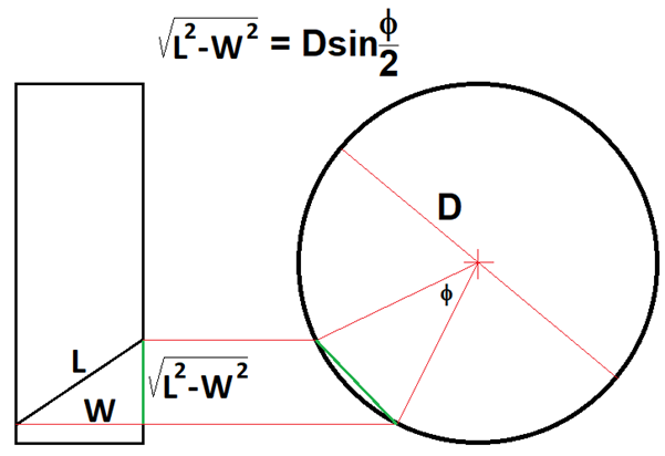

So how much difference does this make? By measuring the camshaft diameter, width and tooth length (D, W and L on the diagram below) then the angle that the camshaft rotates as the gear engages can be calculated.
From some measurements, W=0.875”, D=0.5455” and L=0.930”. Working on the sums,  = 6.622° With a little more mefs (and bearing in mind that crank and cam angles are different beasts), for every 66 thou of extra clearance a the snout the cam timing changes by 1° (crank degrees).

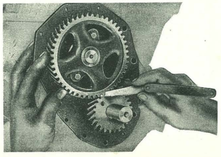

Out of curiosity (if I was doing a little mefs, I may as well do some more) the backlash between the timing and crank gears (either from manufacturing or wear) can also adjust camshaft timing if it is excessive (should be 0.003-0.004” for a grey motor). Backlash is measured as per the image below, by inserting feeler gauges between the gear teeth.
Assuming that the backlash is present at the tooth root, for every 0.022” of backlash the camshaft timing changes by 1º at the crank.
