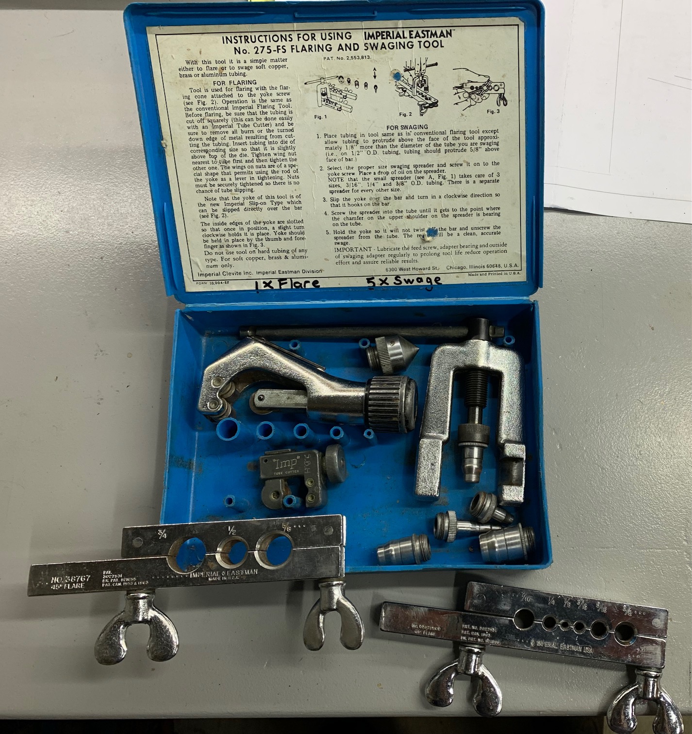

Yep, I can flare up to 3/4” in copper, aluminium or brass.
Imperial Eastman Flaring kit (USA)

I think the Eastman tool does 45-degree SAE flares... does your kit do 37-degree AN flares?
Posts: 2240
Re: Long shot - can anyone flare 3/4" pipe?
Yes 45 deg flare Harv. Perhaps the flare cone could be changed to do the 37 deg however I only have the one for 45 deg.

Thanks mate - appreciate you looking. I'll see if I can hunt down someone with a 37 degree set.
