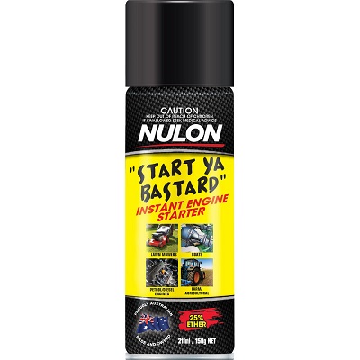

Re: Gentlemen Start MY Engine
Post by 62ekute »
as per above - but I'd turn it by hand first and make sure the valves do what they're supposed to - fill the carb bowls manually or give it a wiff of ether
