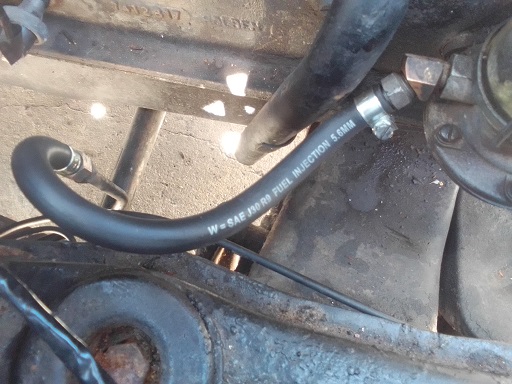

or if you don't mind it not being braided, after you cut through the crimps (I used a dremel) you can slip a bit of fuel hose on ... though if you don't have the braided hose, an additional earth to the body is a good idea
