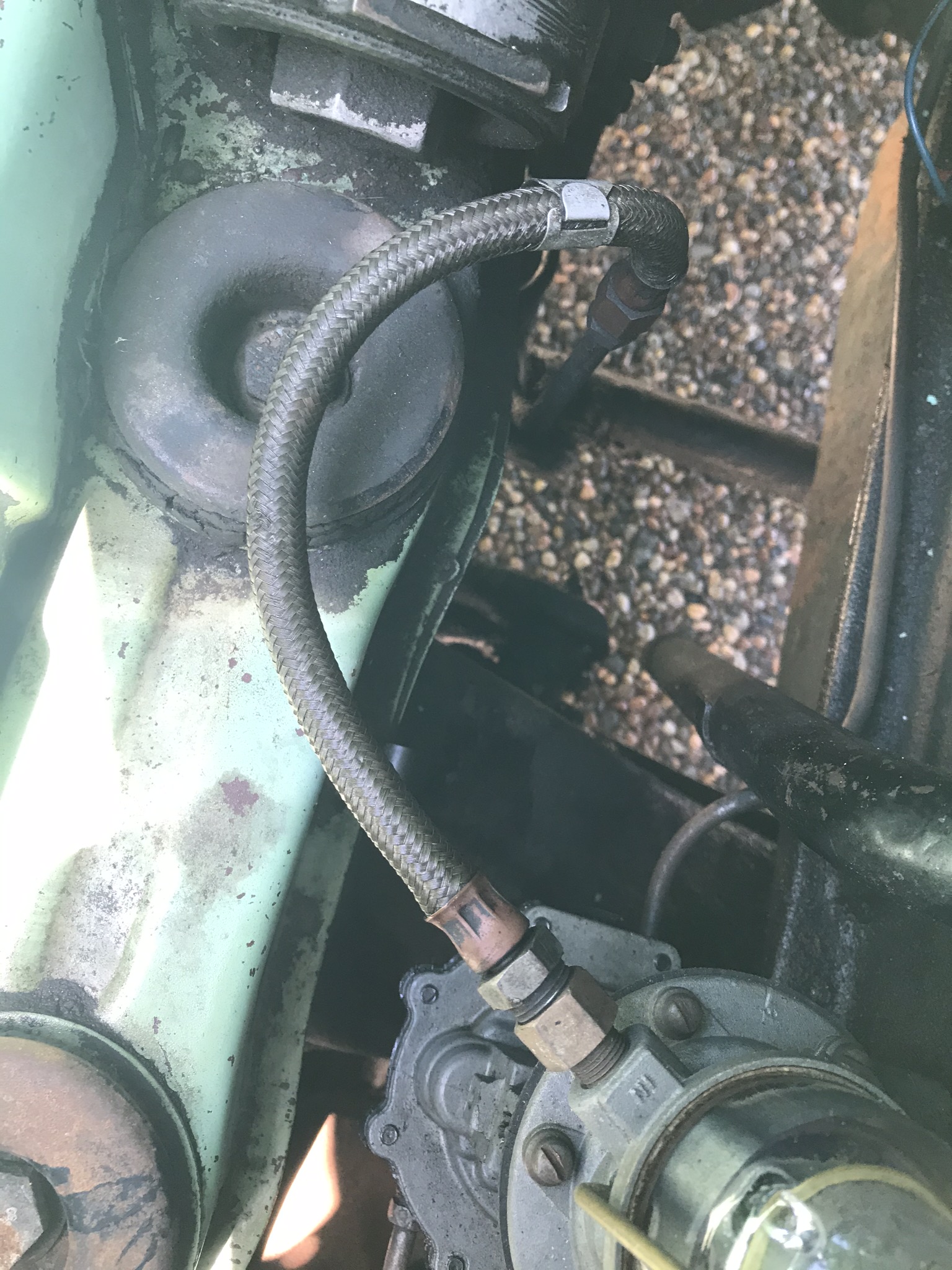

Gents,
Found my braided fuel line bubbling at the crimp to the connection of the fuel pump.
Does anyone have one for sale?
Many thanks in advance Ric.
0409194725
Here is a pic.

File through the crimp ferrules so that you can separate the hose from the fittings; and then go to a hydraulic place with the fittings. They should be able to crimp a new hose section in place.

or if you don't mind it not being braided, after you cut through the crimps (I used a dremel) you can slip a bit of fuel hose on ... though if you don't have the braided hose, an additional earth to the body is a good idea

Repro are available from holdenman restomotive early Holden parts. Has a lot of good stuff, not cheap.
