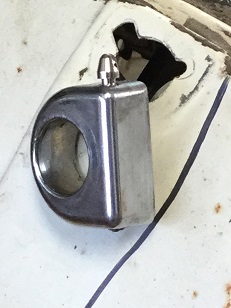

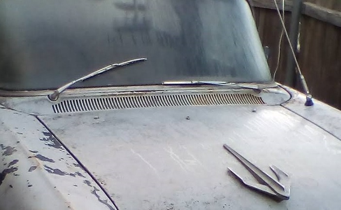

Hi Greg
looks like you are pretty limited by the bonnet reinforcement
my original bonnet had what I believe to be an original single squirter ... this was then deleted and had two squirters put in - directly in front of the driver and passenger (a bit closer to the windscreen)

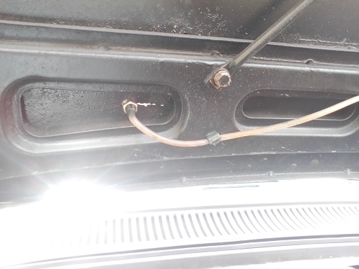

I put two in the new bonnet (where they fit in a hole in the reinforcement and directly in front of the driver and passenger). This spot lets me squirt up to about the middle of the windscreen with the squirter adjusted all the way up (which is fine)

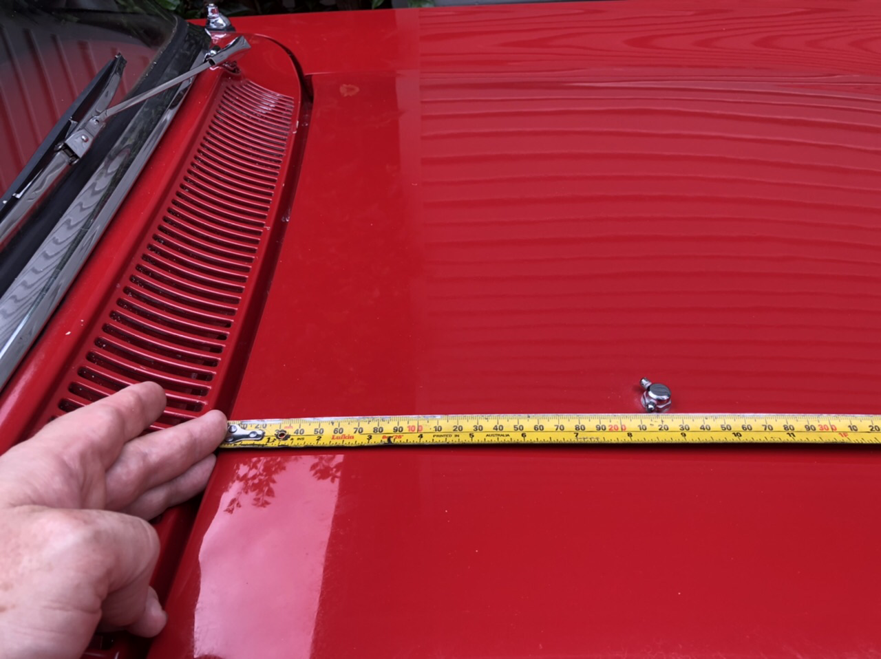

My bonnet came with the single-squirter hole. Can measure that for you if it helps, but no guarantee it is NASCO-correct. I don't have the instructions for the EK washer kits.
Posts: 5654
Re: Bonnet mounted windscreen washer squirter
8.75” from the trailing edge of the bonnet to the centre of the hole.
