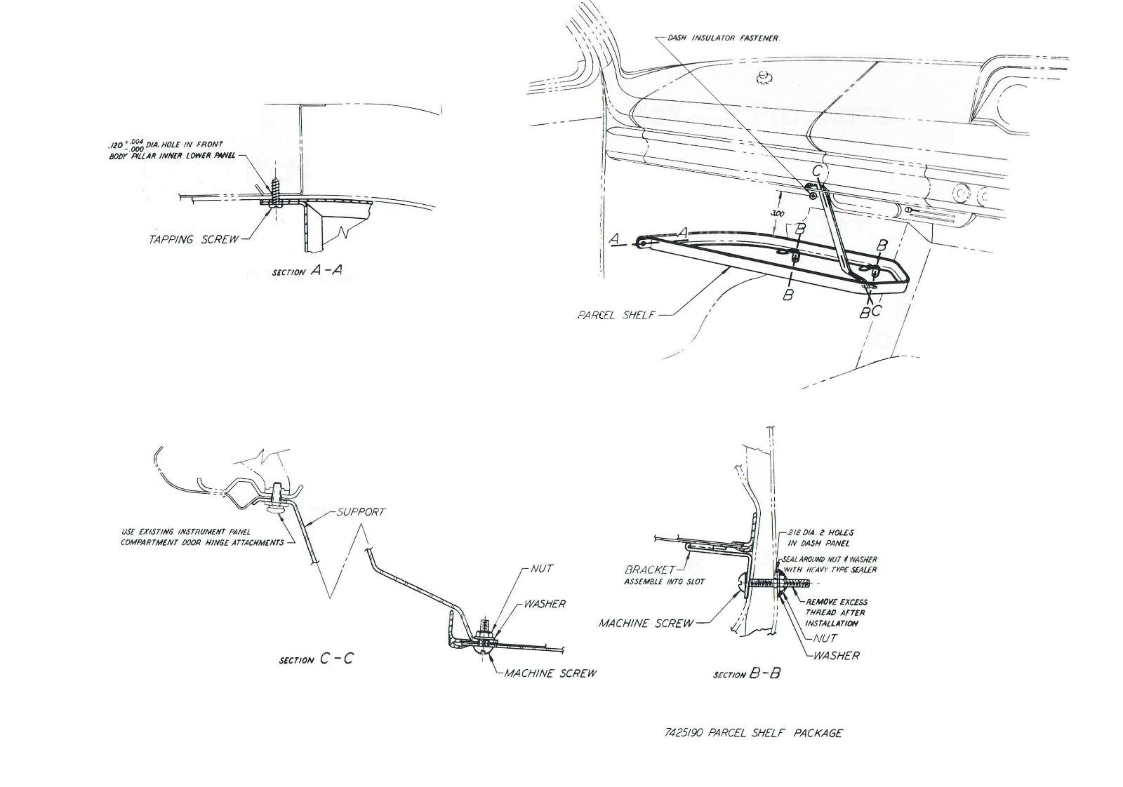

Posts: 5487
Re: Parcel Shelf Under Glovebox
These are the fitting destructions for EJ/EH... I don't have FB/EK, but they should be similar.
7425190 Parcel Shelf EJ and EH Holden 1 of 2.jpg (163.03 KiB) Viewed 3209 times
7425190 Parcel Shelf EJ and EH Holden 2 of 2.jpg (115 KiB) Viewed 3209 times

Thanks for destructions Harv appreciated.
Hi Blacky that's great mate I would like to borrow it if that is ok when I get a chance to catch up with you, I'm off shore from 1st August and most of the month so will give you a buzz when I get back, thinking of using to to put my computer and relays on that way keep full glovebox, I'll just make a cover and put over them.
