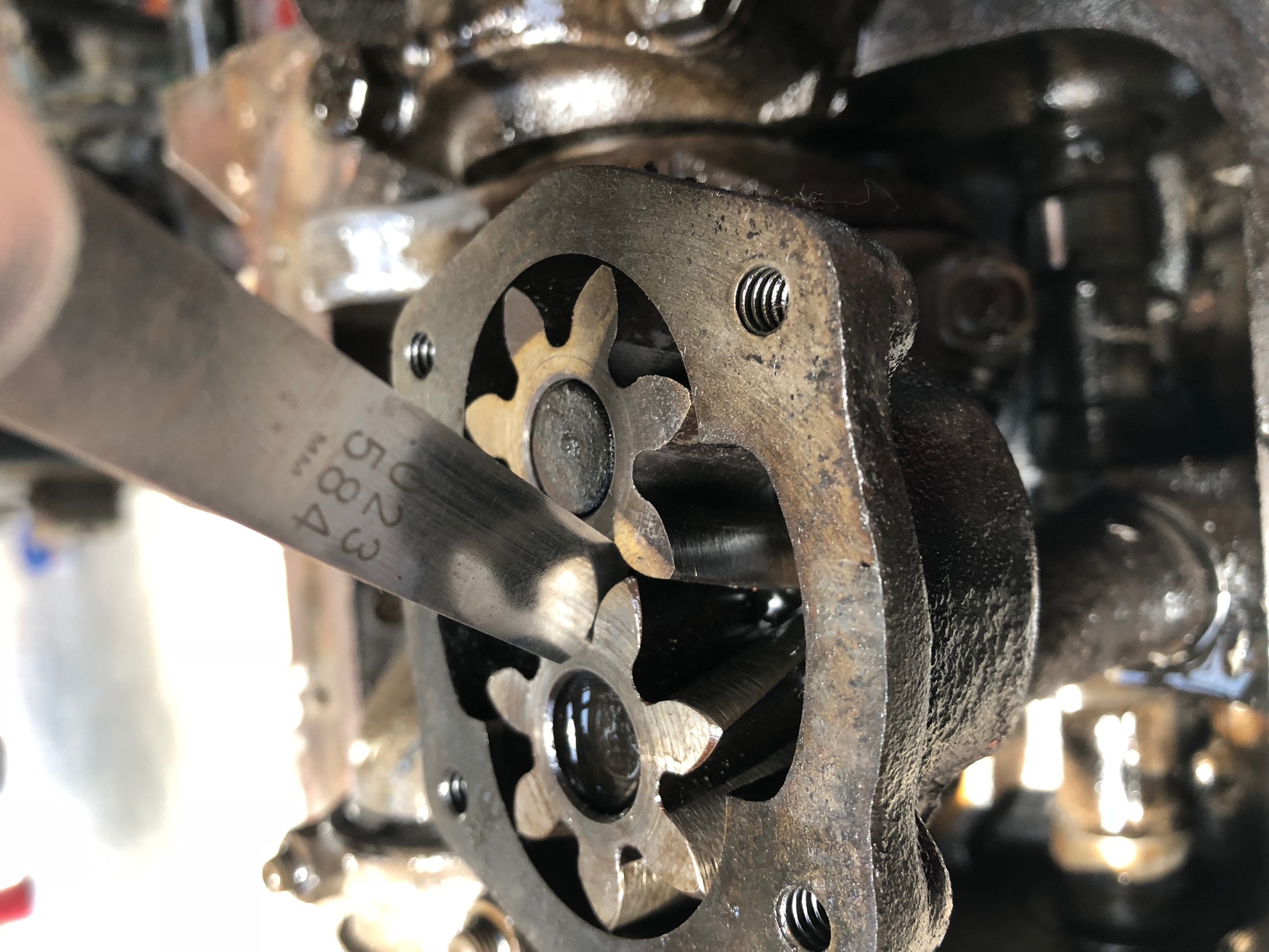

I've done a bit more investigating into the oil pump issues. Pulled it out and cleaned out what I can. The screen was pretty caked in gunk.I tried to measure the back lash in the gears - there appears to be about .023" between the engaged teeth - is this the correct way to measure it?
oil pump back lash.jpg (583.05 KiB) Viewed 4738 times
From what I've read this is way beyond spec - could this mean the pump wont pump?

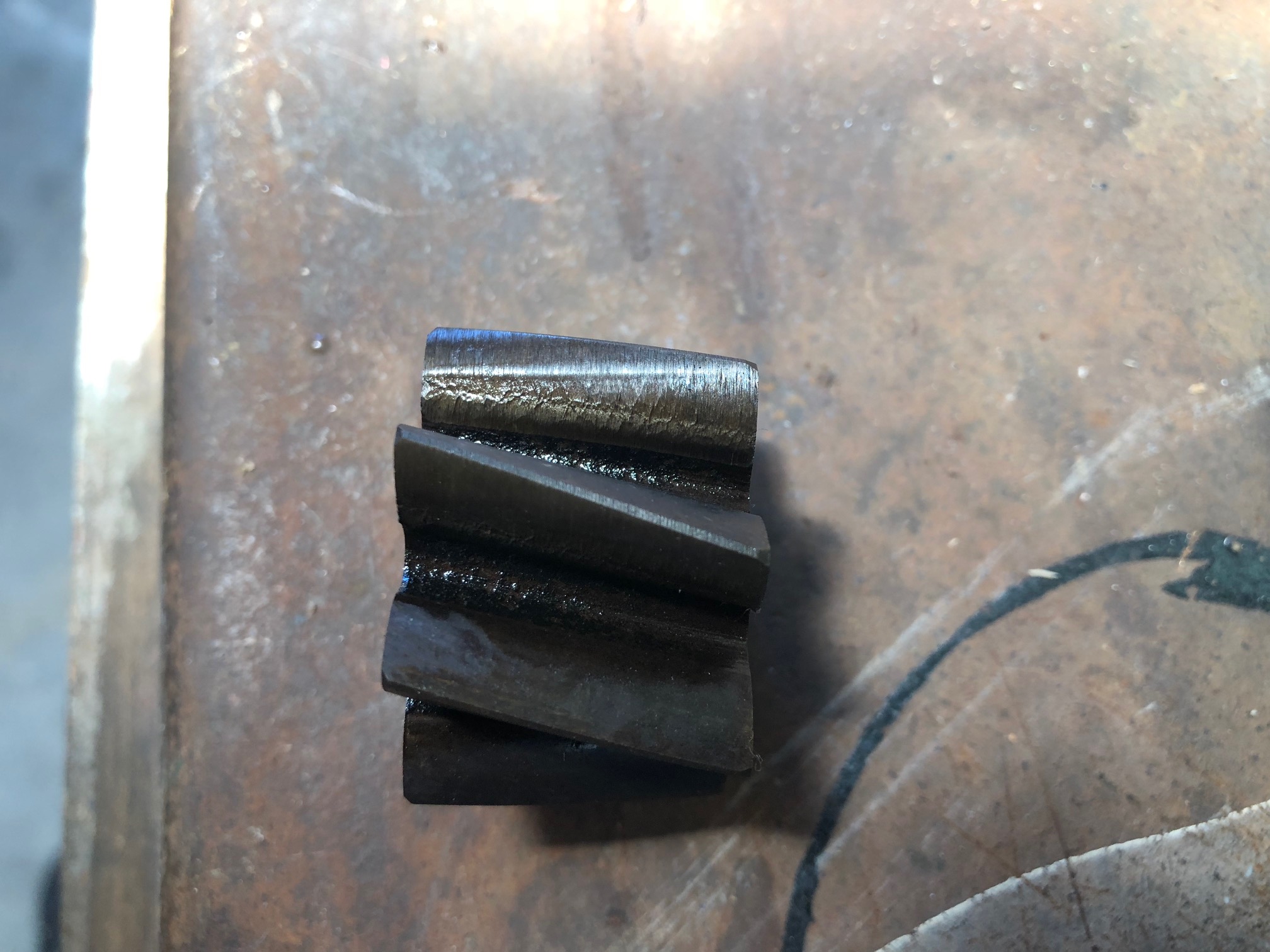

Theres a fair bit of texture on the face of the gears too - not sure if that's normal or a sign of wear?
oil pump gear 1.jpg (438.93 KiB) Viewed 4738 times
oil pump gear 2.jpg (615.49 KiB) Viewed 4738 times

SunnyTim wrote: Mon Nov 05, 2018 6:49 am I think you can buy kits for the pumps these days. Check the pressure relief valve too sometimes you can pack them up with a washer. How was the bottom of the sump was there much sludge? You have saved the motor a bullet by cleaning all the crap out of the bottom end. I think the pump will work but better to give it a birthday while it's out. Where abouts are you?
Sent from my SM-N950F using Tapatalk
Thanks Sunnytim - I'm in Adelaide. There was a thick layer of sludge in the sump which I scraped out with a wooden spoon. Clean now. MIght fill it with clean oil and spin the pump again before finding replacement gears.

If you position the engine with number 1 cylinder at firing instant and spin the oil pump, you'll get oil up to the rockers. (There's a groove in one of the camshaft journals to direct oil up to the fitting, but it's not machined all the way around.)
Worn oil pump gears are not a great problem, believe it or not. The oil pump will still operate, but the oil pressure at idle will be a little low. But lots of other things make the oil pressure at idle low, like worn main bearings.
It's a good thing that you've cleaned all the sludge and gunk out of the sump.
As you've suggested, clean the pickup screen, reassemble and re-install the oil pump as-is, temporarily replace the sump (don't waste a gasket kit), add oil, set the motor to fire on number 1 cylinder, engage the drill and spin. If you can hear the drill "load up" after a couple of seconds, that's the sure sign that you have good oil pressure.

Hi All, I once had a tooth break off an oil pump gear which also screwed the tang off the bottom of the dizzy. The gears looked like the picture of your one.( ie , the teeth looked pitted). Perhaps compare with some new gears. - just to be on the safe side. Regards Daz.
