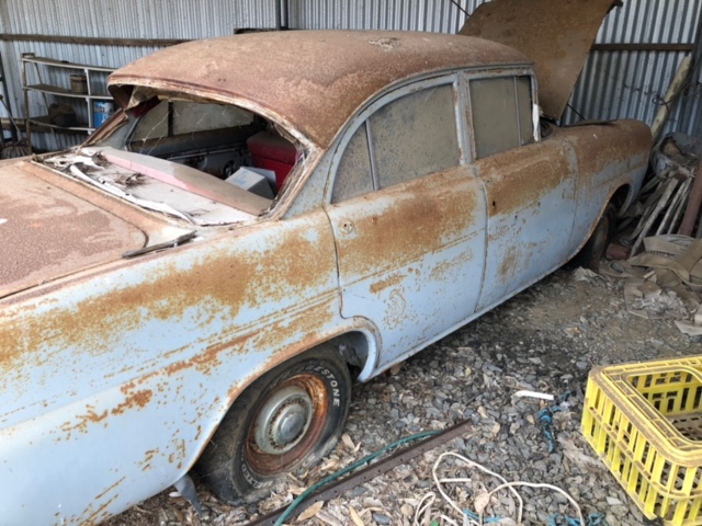

New member to this forum. I stumbled across it as a result of googling information about my new project - a 1960 FB Special Sedan. I guess you can call it a barn find, given I found it in a barn... Its been sitting there for 20 years and was driven in. Someone had started to strip it, but all the chrome and trim, door cards etc are in the boot. Seems to be very solid despite the surface rust. The windscreens (front and rear) had been removed years ago so its pretty dirty inside and the parcel shelf vinyl has perished, but otherwise it seems to be in really good condition. All i've done so far is place the glass back in, cleared the cobwebs, sweep the floors and remove a massive rats nest from under the rear seat...
I plan to restore it to new-ish condition and original-ish spec except where it's too hard to find the parts or it's cost prohibitive. Wont be a show car, but I like the idea of driving it somewhere when I'm not in a hurry on a summers day. I've never restored a car before but I'm reasonably mechanically minded, so I'm keen to do as much of it myself if possible. The forum has already provided heaps of good information and advice, so hopefully my dumb questions are kept to a minimum!
Few pictures below.
Cheers, Jonty

Great find Jonty. I hope you don’t find too much rust in the lower sections. There aren’t too many bits you can’t get or make these days. Welcome to th eforum.

Good score with the wheels. Nice to see there are still cars to be unearthed and people who appreciate them. Look forward to seeing more pics and reading about your progress. Plenty of help on here.

Welcome to the forum mate, thought that was pics of 2 different cars there at first !!

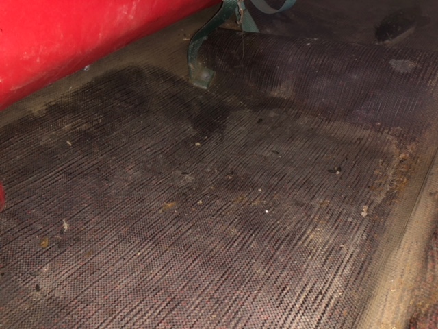

So ive started stripping the car down, the it is beginning to reveal its secrets. I've found a bit of rust in the body shell at the top of the rear screen.
I guess that needs to be cut out?
Also the left front gaurd has been bogged up in the bottom rear, and there's a few holes around the headlight. I'm not sure what to do about the headlight rust, but I think I'll have to cut the bottom bit out and replace it with a new panel part (from Rares or Taylors I think). I have a MIG but I'm a novie welder - is it something that I should be able to tackle with a bit of googling?
Any advice appreciated.

It is all fairly typical jonty. For the window opening you will be best to cut it out. Depending on the extent and complexity of the bit you remove you could make up a patch, fold a bit in the vice or cut a section out of a good roof. Patch panels are available for the guard rust.
It takes practice and a decent mig to get an acceptable result. It is only steel though and if you don’t get it right you can grind it out and try again. Tig and oxy are better for some jobs according to the experts. I am still learning myself and manage to get consistent results with the Lincoln 150 amps I think it is, gas mig.
I have a couple of roof cuts if you want to come and hav3 a look some time.
Clay
Clay
