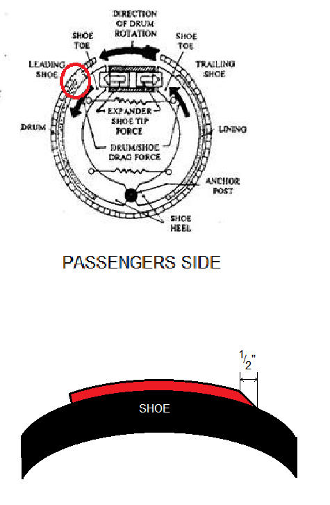

Re: Front driver side brake locking up on startup
I learnt a lot from this posting. Have I got the drawing below correct? i.e. the edge that needs to be machined is shown in the red circle, and the machining is as per my dodgy sketch below?Craig Allardyce wrote: Fri May 04, 2018 12:59 pmRob I'd say by experience the chamfer should taper down from the top edge to about 1/2" to the material face.
That's correct Harv. The set up you have shown is what's called a twin leading arrangement if both linings are set high with respect to drum rotation (i.e. one close to the cylinder and one close to the anchor). Also it wouldn't have a fixed bottom anchor. This would allow both shoes to get dragged into the drum but only in one direction. FB/EK are single leading in both directions as both shoe linings are set high (one for forward and one for rearward motion) and it's a fixed bottom anchor. Only one shoe will self energise for each direction of rotation of the drum.
The chamfer you've drawn is right. Radius grind is about getting the diameters of the drum and shoe lining matching.
Because one shoe is leading when going forwards, and the other shoe is leading when in reverse, does this mean that both shoes should be chamfered (ie the edges in both the red and green circles below? Or are only the forward direction leading shoes (red circle) chamfered?Craig Allardyce wrote: Sun May 06, 2018 7:57 amFB/EK are single leading in both directions as both shoe linings are set high (one for forward and one for rearward motion) and it's a fixed bottom anchor. Only one shoe will self energise for each direction of rotation of the drum.
I guess for old shoes there is a pretty fair risk of the linings being asbestos bearing, so you wouldn't want to grind them at home. But for new linings (supposedly asbestos free) is there any reason not to grind the chamfer at home? Assuming this would be a hand file type job (or perhaps remove the meat with a grinder then clean up with a file)?
Yes I'd chamfer both shoes harv.
