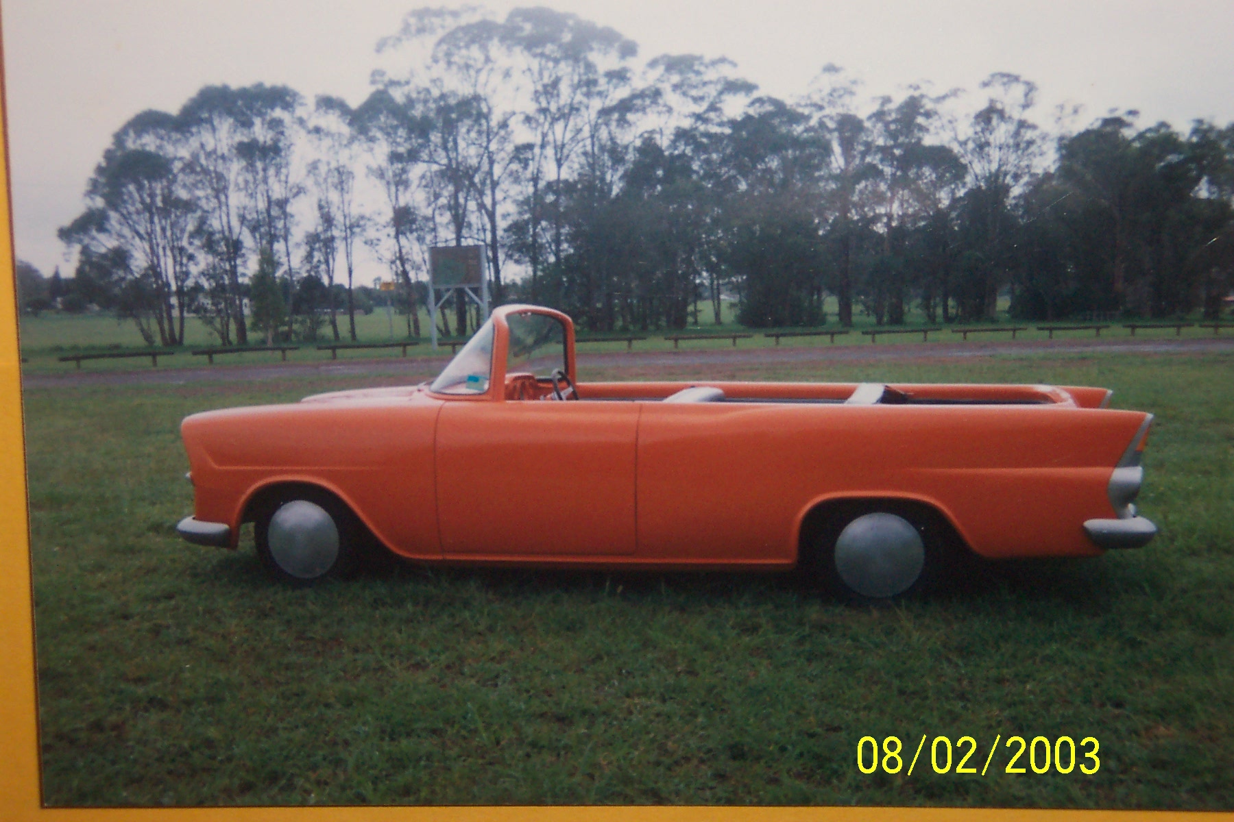

found another one
Posts: 4365
found another one
another car me and some friends built approx 25 years ago
back when we built it
good to see another of my radical custom builds still on the road after so many years

I assume this one started out as a wagon Mick? What bracing did it need underneath?

Harv wrote: Sun Mar 04, 2018 7:26 am I assume this one started out as a wagon Mick? What bracing did it need underneath?
yeah started as a wagon
had to put chassis connectors and triangulate the sills (steel plate from the bottom of inner sill up to floor) also had to fill (plate) the Y on the subframe and i think we also plated the kick panel area also

Guy I knew at Moonta did one in about 1990. It had RHS brace in the cab from above the front spring hanger to the firewall to subframe attaching bolts either side. You had to practically climb over to get in and out.
