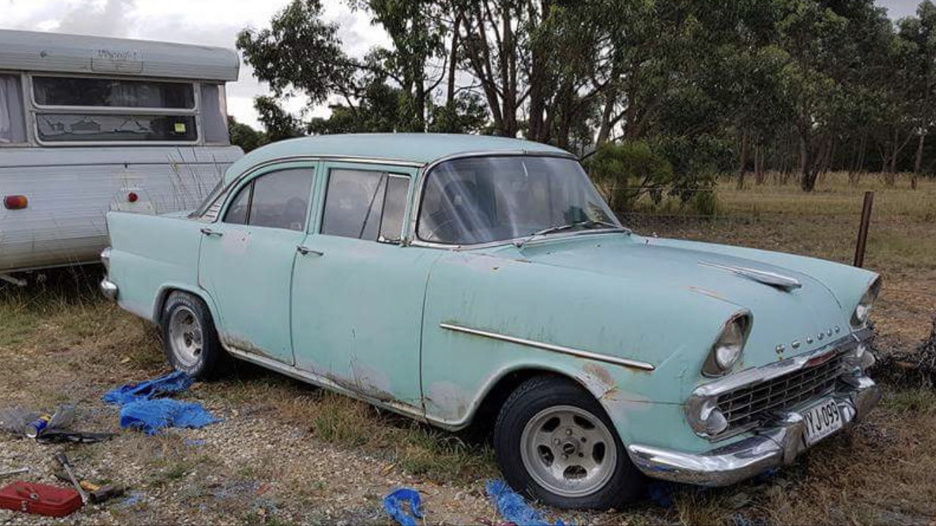

Front wheels off for caliper overhaul.
Front end has UC/LX Torana disc conversion. The calipers are the alloy bodied ones with cast iron pad holders. Gave Val a quick wash too.
Posts: 11448
Re: Valerie the EK Standard Sedan
Colleen Green? My favourite. She’s had a bit of a dress up with the stainless window and gutter trim, chrome light surrounds front and rear. Obviously had some attention over the years.
I take it the Torana discs are on a HR ball joint front end?
gpi
Posts: 1131
Post by gpi »
Valetta Green (0250)
Yes, HR front end w/ torana brakes,186, trimatic and hr diff
I have some front surrounds if stripped to paint as standard, however, i am on the hunt for some standard rear lights.
Posts: 11448
Valletta green. Thanks.
I have a pair of standard rear lights at Willunga, assuming by the plates you are in SA. Gratis to you if you don’t want to scuff the chrome off and paint the ones you have.

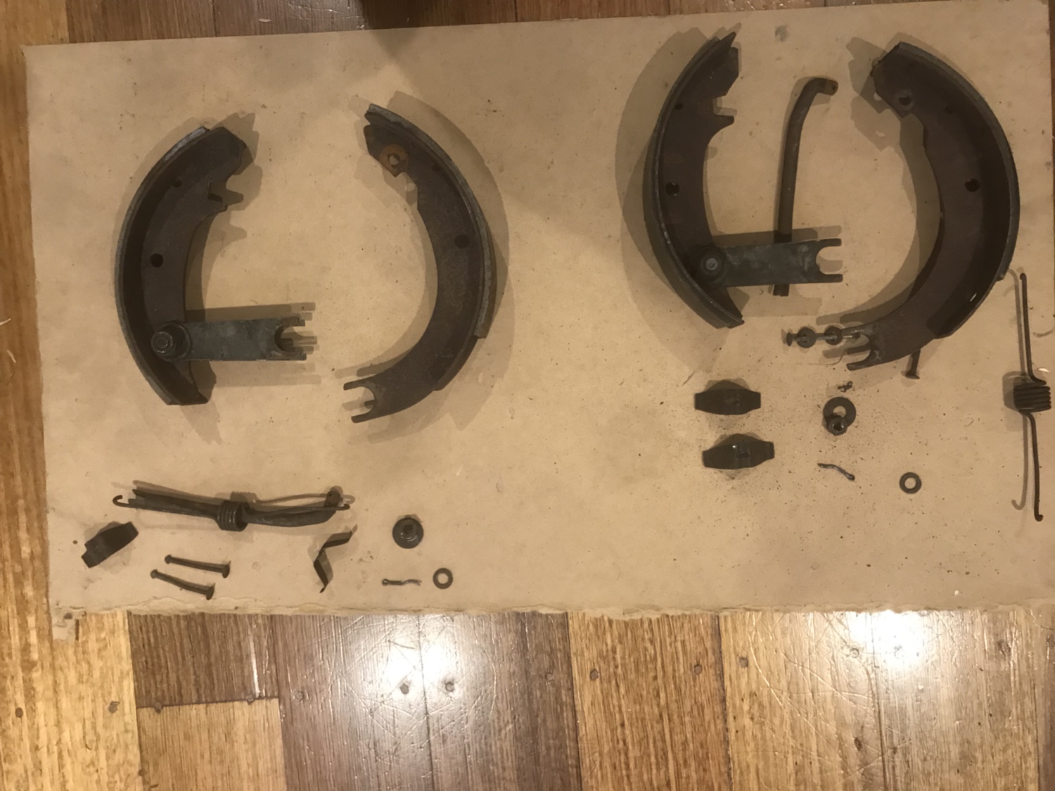

Unfortunately these are not HR Holden brakes...
gpi
Posts: 1131
Post by gpi »
EK brakes. Largest pads at the front...

Posts: 11448
You’re going to have to change the rear axle to match front brakes. What have you got in mind? EJ-H, HD-R, LC-J?
gpi
Posts: 1131
Post by gpi »
Hi Clay and fellow FBEKers,
diff may stay as i have turned to the dark side and am reducing the cubes :ninja22: :minus: :evilll:
brake setup has hj proportioning valve and vh24 with PBR alloy LX-UC calipers and discs

Cool mate. An interesting combination there. VH24, that is Nasco issue EH era and factory HR disc? I wondered if they had fitted a proportioning valve. Another option is to go dual circuit and only boost the front I am told.

i think i should take the hr diff out of the 225 and use that, but im not convinced the rims will fit back on without out issues...
Posts: 11448
I reckon that HR and EK are identical width
gpi
Posts: 1131
Post by gpi »
hmmm, if i keep the 225s on the back i guess ill have the standard issues...
59wagon
Posts: 645
Location: Shoalwater, WA
Post by 59wagon »
I just had a look at the spec's. They vary a bit depending where you look, but it appears pretty consistent that FB to HD were the same, then HR was 10mm wider.
