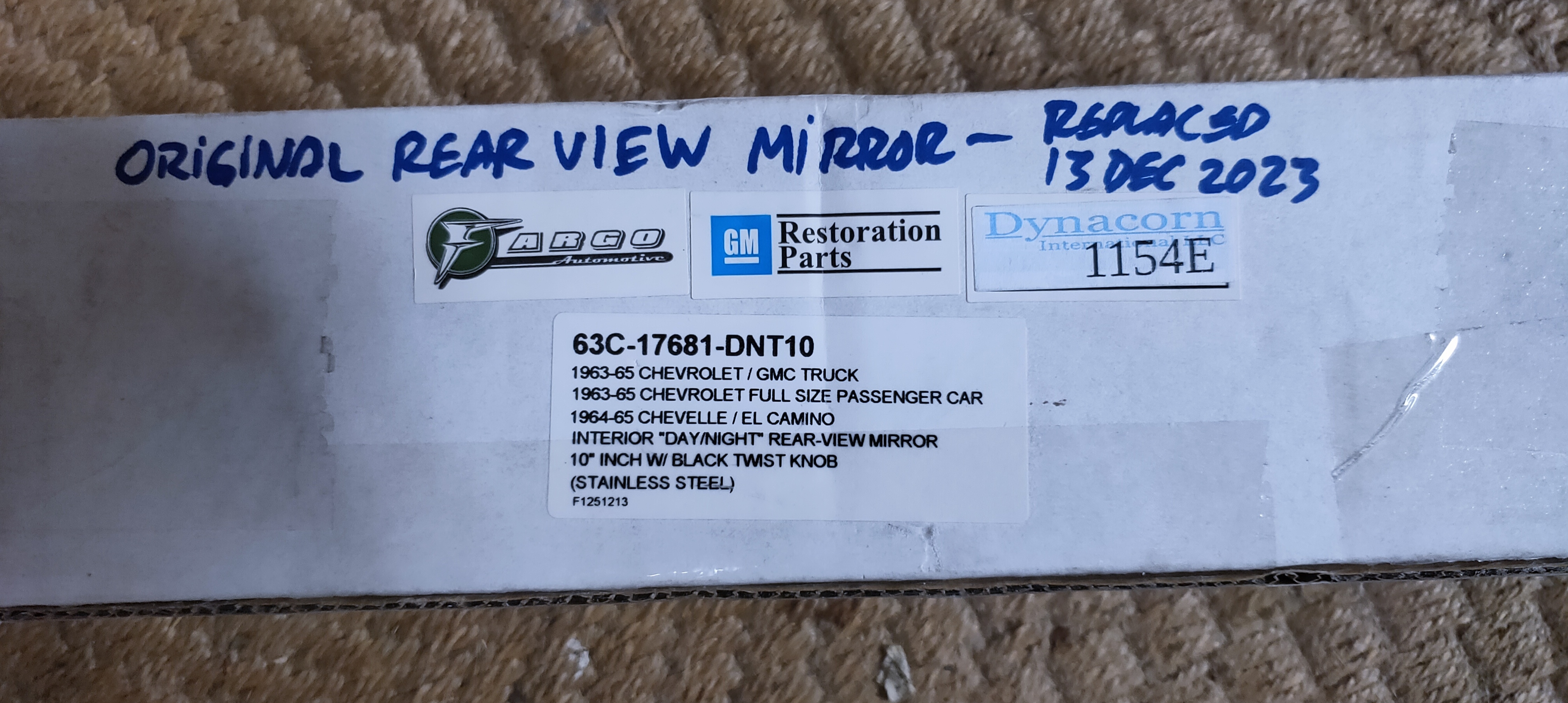

Below image - Packaging for the new rear view mirror - Shows make, model, and other details:

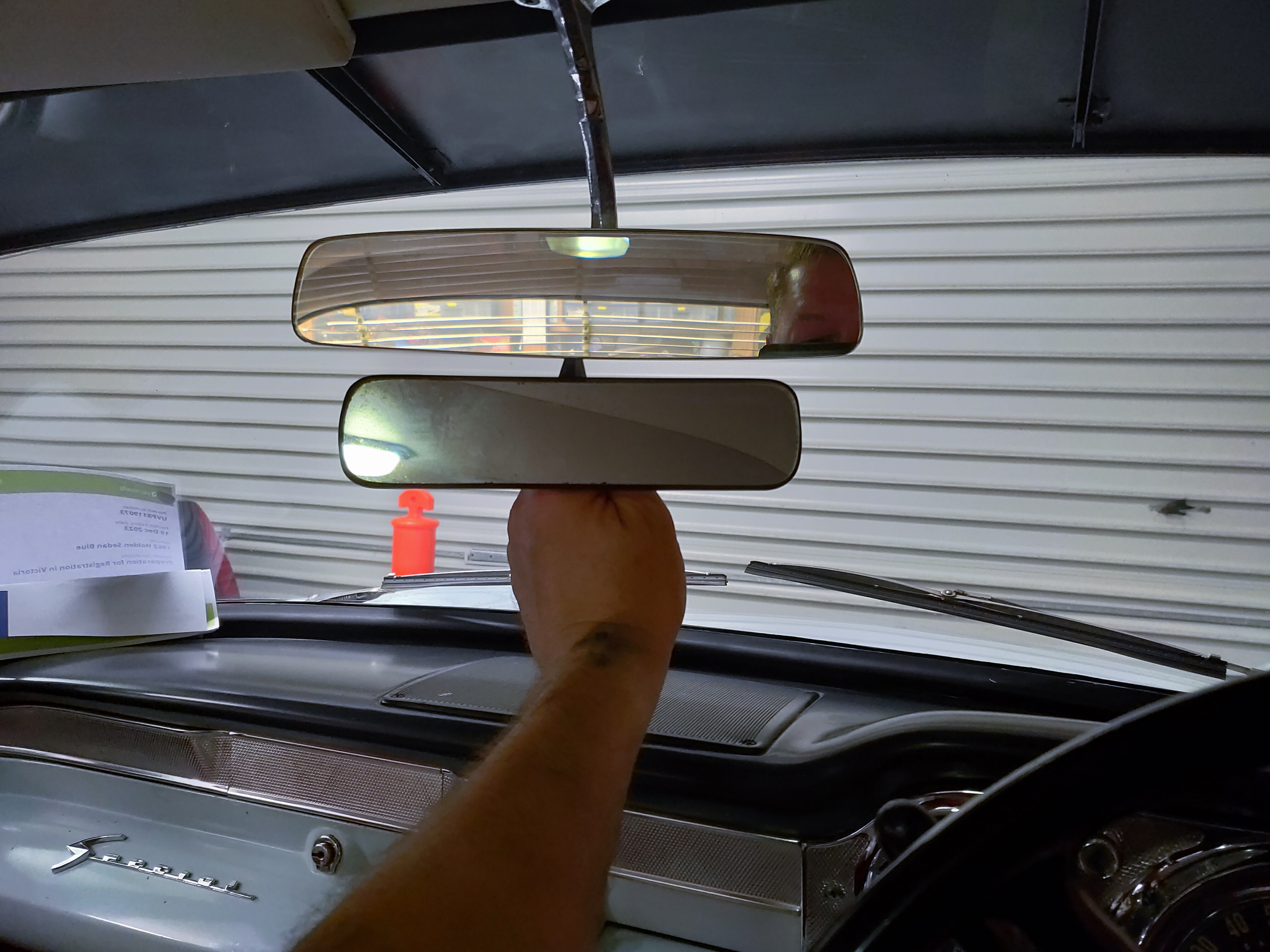

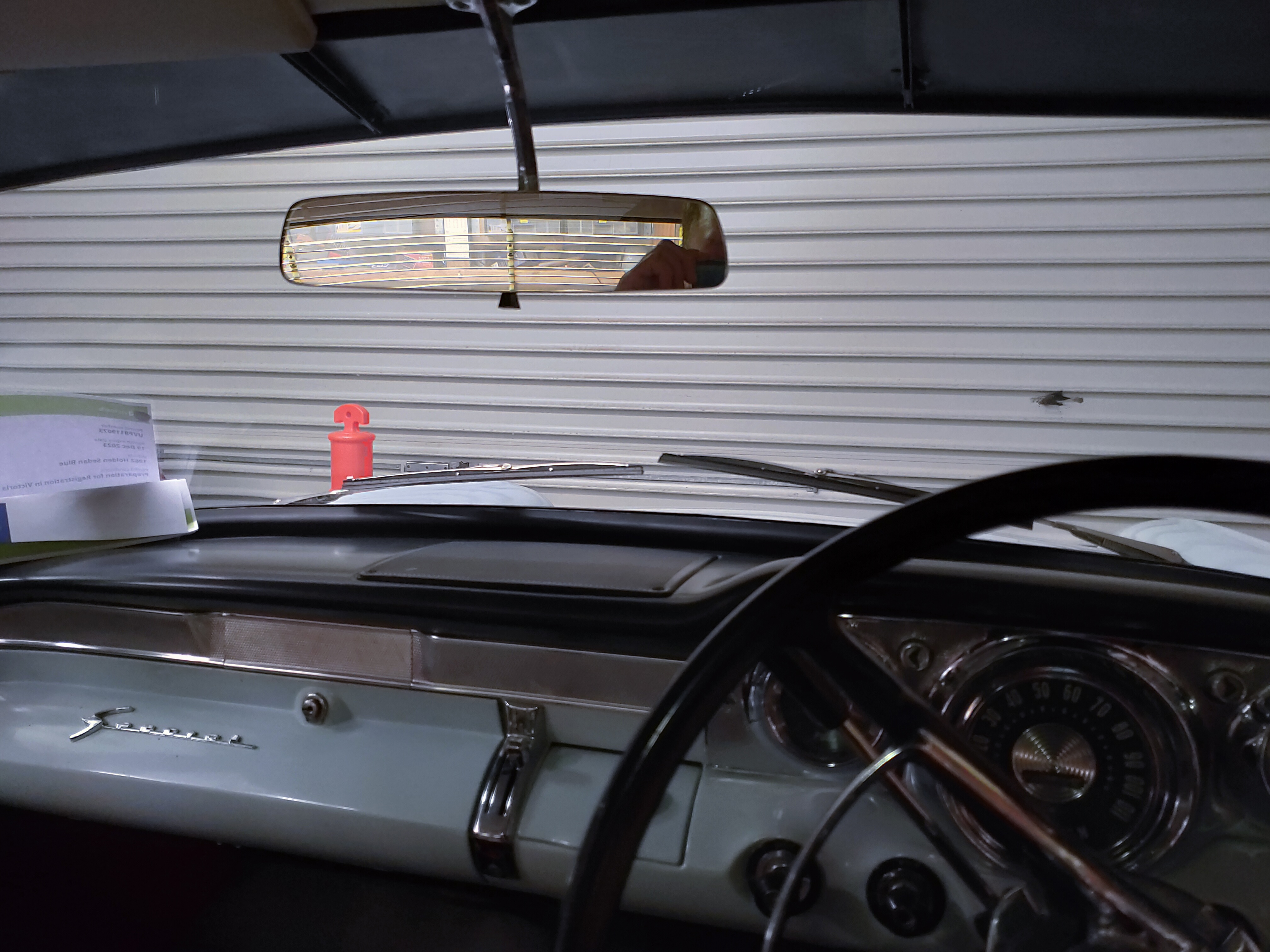

Images showing old mirror, then new mirror, installed:

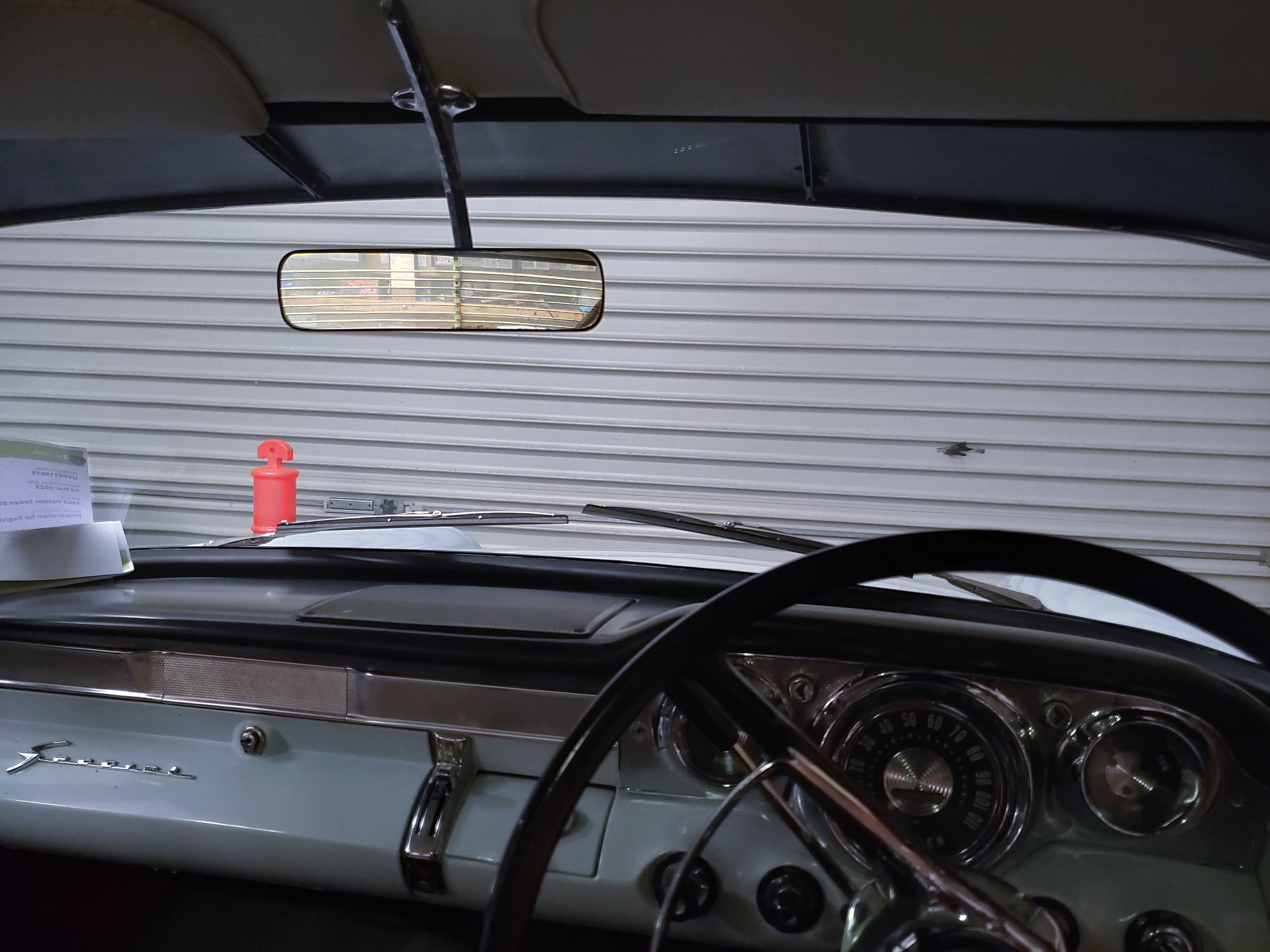

Imagines showing fields of view of old mirror, then new mirror - Note how the new mirror shows practically the full width of the windscreen. Camera positioned at eye level of seated driver:

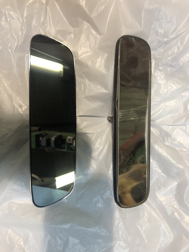

Image showing comparative sizes of the original and new mirrors:

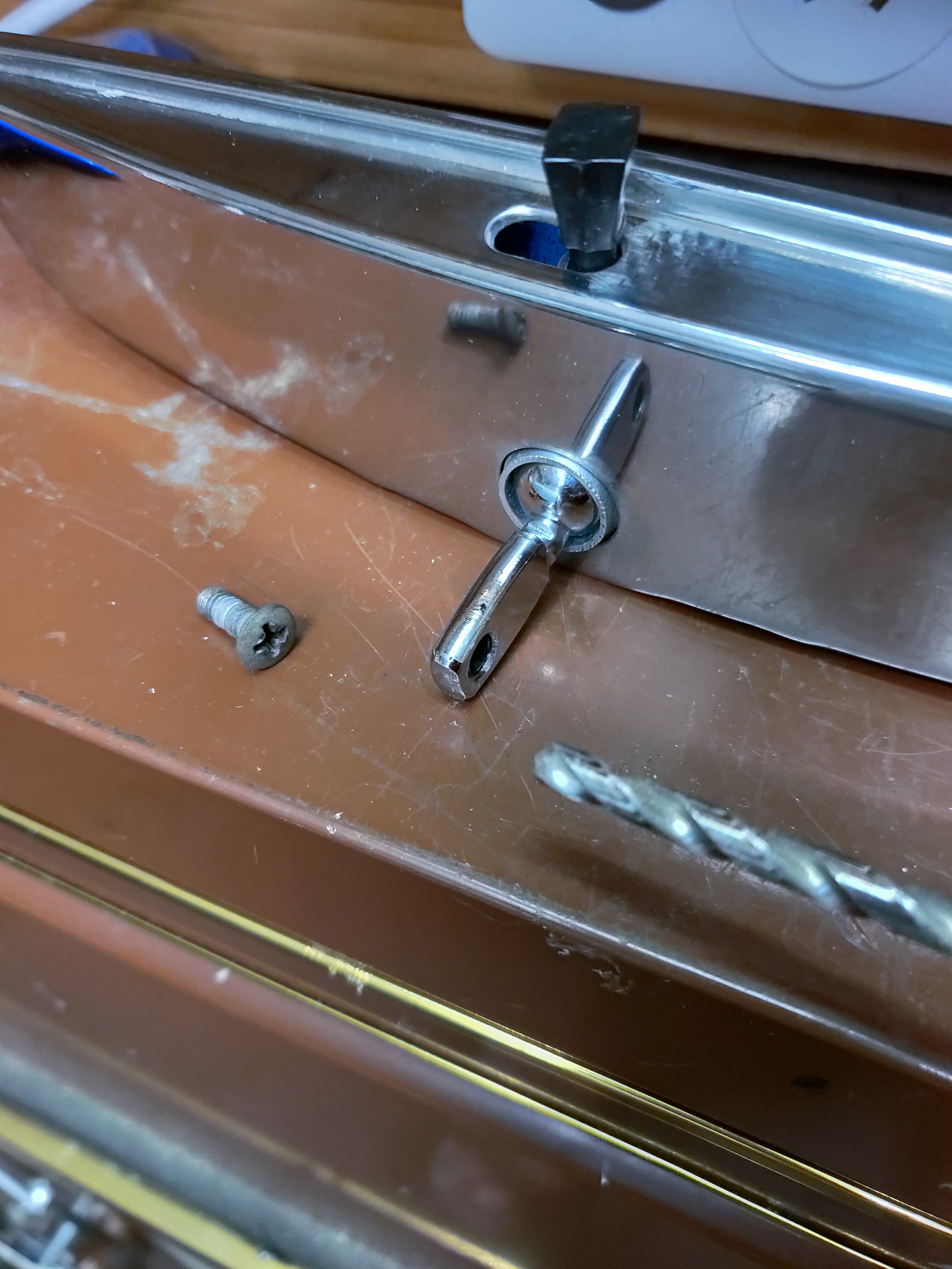

Connection of mirror to the fancy chrome mounting stalk is critical. FB/EK HOldens use a hinged connector (tongue is bolted between a fork), not the threaded nut-and-bolt style that appeared on the vast majority of classic rear view mirrors that I encountered:
