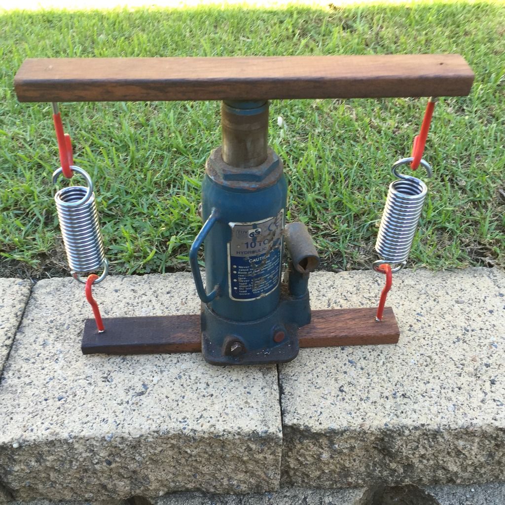

Thought I'd put up a dedicated post on Stu's Spring Stretcher for those who haven't seen it. The original is here:
http://www.fbekholden.com/forum/viewtop ... et#p173991
I went to make one up this afternoon, and was about 2" too short in the length of threaded rod I had :( . Using the licensed Stu Stretcher technology, I applied a little more grunt to the stetcher bit:
Worked a treat for getting the springs back onto my hinges. Those shiny springs in the photos above are the ones that FB0000 is selling here (nice product John :D ):
http://www.fbekholden.com/forum/viewtop ... =2&t=22188
Re: Stu's bonnet spring stretcher tool
8) New and improved Mark II with extra hydraulic lift by Harv :thumbsup: I like it! :lol:
