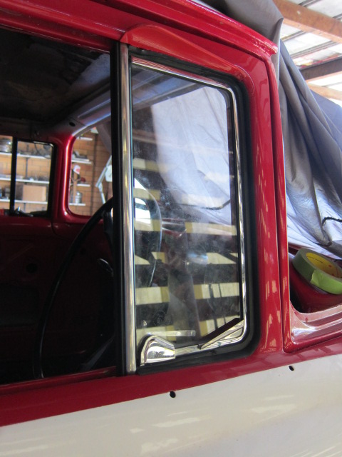

Its been a while since a did any significant work on my old bus....anyway

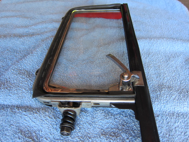

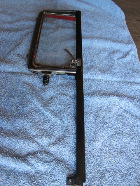

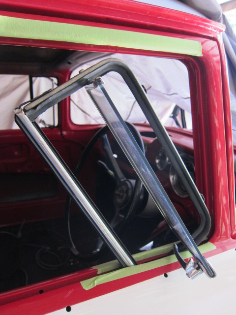

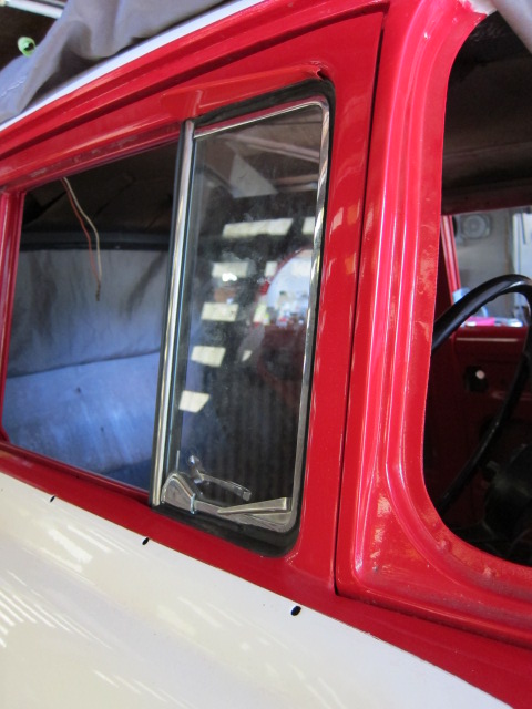

Stripped cleaned painted and rebuilt LH and RH front quarter panel windows.
Installed rear quarter windows
Installed all bailey channel with flocked type
Installed all door belts ( I reckon the windows are gonna be a tight, not much room between the strips!)
Cleaned painted and re-installed fuel tank
Re routed brake and fuel lines from pre ordered straight lengths of tube
Put a kits through brake and clutch master cylinders and installed them, installed new clutch slave cylinder

Re: Front Quarter Windows rebuild / Install
mmmm - bugger of a job getting those in without scratching anything , good to see some progress , 5 months until Renmark !!
