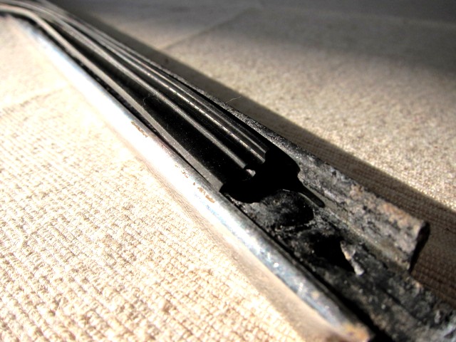

Hi Stewart,
My quarter window vent seals were missing so I didn't have anything to go off except removing the metal strips.
So I've come up with this as the position the seal needs to be when glueing. Is this correct? :thumbsup:
I'll clean and paint before putting th seal in :wink:

I haven't glued them yet...here is my interpretation of the installment;
The seal has a small c - channel profile that I have assumed allows for the 7 raised ' bumps" where the metal strip tabs originally sat.
The only flat side of the seal contacts up against the inner side wall of the upright channel, the small '45 degree' profile of the seal contacts against
and acts as the vertical seal for the quarter glass window when it is closed.
I could be completely wrong...I have nothing to go off, so, it's a logical guess :think:
Hopefully someone will confirm or set me straight!
Posts: 14249
Re: HELP!! How To Glue Quarter Vent Seal (uprght channel)
Looks about right ??? seems like the only logical way it COULD go ???

Blacky wrote:Looks about right ??? seems like the only logical way it COULD go ???
Yeh, I reckon thats it, :thumbsup:
Ditto what Blacky said. That's correct Lex.
