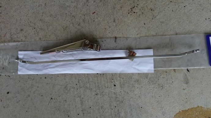

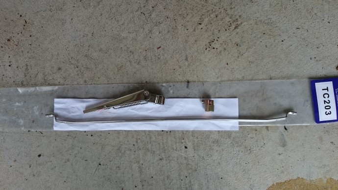

Had a bit of luck, an Aussie company [TRUVISION] making parts that fit our cars. As you can see from the photos, they multi fit. In a pinch if your spindle is totally useless you could machine it down and fit the boss, but my drivers side i thought might be screwed but with the new arm on, almost as good as new. They also make wiper blades to suit bayonet style which i guess is OEM, i used my old wiper blade holder. Got mine from SpeedScreen in Campbellfield, Vic, other states ring TruVision for a stockist.
I don't think i need to do a how to, each new arm pack has a double ended arm, basically just cut off the hook to suit your crank and cut the other end to suit your length. The arm is held in the head with a plate and allen head screw, the same size as the wiper switch screw.
