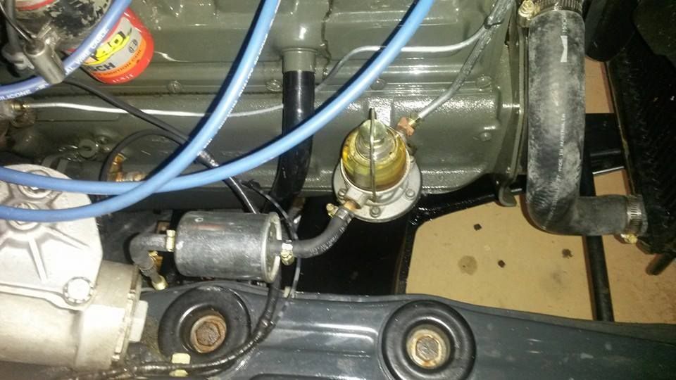

G'Day Harv,
I pulled the fuel pump off and gave it a clean, everything was in good condition looked like it had been reconditioned already. I ended up removing my fuel filter that was between the fuel pump and carby and replaced it with new fuel line. I also replaced other rubber fuel hoses with new ones and blew compressed air back to the fuel tank. Seems to have done the trick, ran the car last night in the garage and it didn't stop after 5 minutes of revving at half throttle. Checked the carby fuel bowl after and it was full of fuel.
Just need to take it for a test drive now and install a fuel filter before the fuel pump. Any idea on what sort of fuel filter I should install?

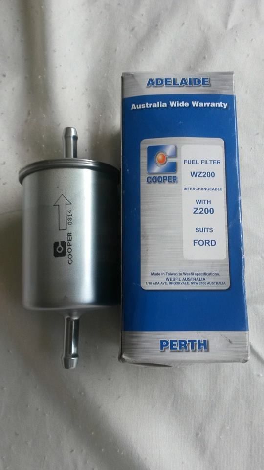

OK here's what I did, removed the braided fuel line and replaced it with a Commodore/F**d fuel filter
You need to used the fuel injected/EFI type so it doesn't matter what it says on the box.
I used Cooper but I'm sure RYCO has a similar one.
This is the filter on mine.
Filter installed.

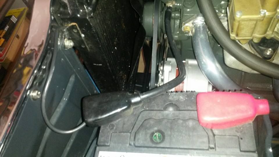

Now as you will have removed the braided fuel line which is the secondary earth you need to earth the battery to the body
as well as the engine block.
Mine is to the radiator attachment bolt as you can see.
Filter installed.

The Ryco equvalent to the Cooper (Wesfilter) WZ200 is Ryco part number Z200.WayneXG95 wrote:OK here's what I did, removed the braided fuel line and replaced it with a Commodore/F**d fuel filter

Thanks Wayne & Harv,
Very good advice, the braided fuel line was already gone when I got it, so I'd already had the extra earth installed onto the body, I'm glad I did something right. Will look into fitting one of the commodore fuel filters, what's the reason for using a fuel injection/efi filter over a standard?

Finally took the car for a test drive yesterday afternoon and it kept stalling again and was difficult to restart without stalling straight away. Managed to get it back home, then once I got home it was running ok again, so I took it for another test drive around the block and this time it drove perfectly fine. Any ideas on what I should check next? Could I have crap in the fuel tank and only blocks when its been driven?

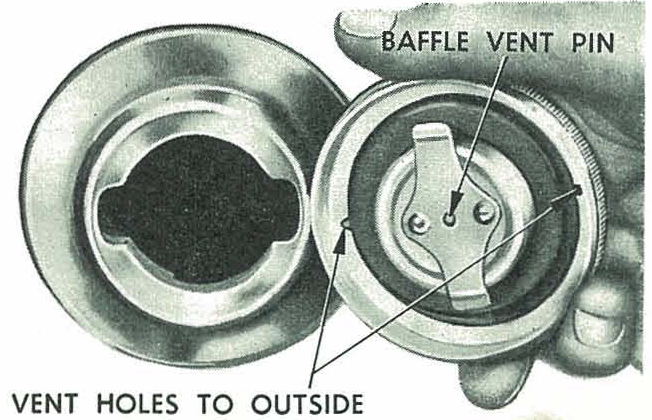

b) Take off the fuel cap, and check to see if the breather holes are clear, and that the jiggler pin is free to move.
If they are not (or if someone has put a non-vented cap on), then the tank can't breathe. It will pull a vacuum as the engine runs, and starve the fuel pump.
