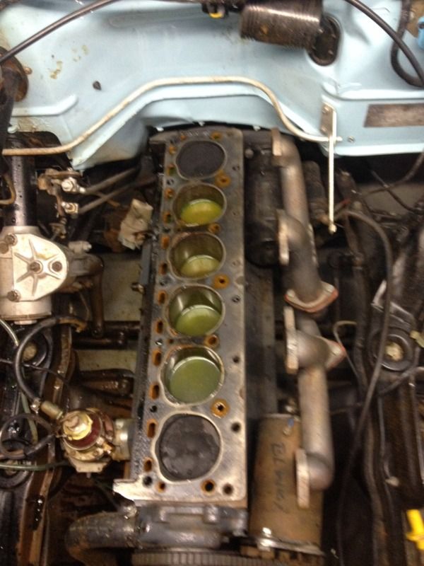

................ but I am pretty sure theres not meant to be water in this bit :econfused: :econfused: :econfused: :esad: :esad: :cry:
hopefully its just a head gasket, if the head is shot I am seriously considering turfing the grey and going red. Bloody grey motors :roll: :roll: :roll: :roll:

It kindof looks blown in two spots...between 2&3 and between 4&5

See the angle the genny is on ? the bottom bolt fell out and it got hot , hopefully not hot enough to fry the head, bloody thing owes me over a large - if I need to get another head done I can smash a red together for less than that and I wont need to worry about flogging it too hard ever again :ebiggrin:

I am going to drop it off today and get it crack tested and checked for straight , will see what happens - I would rather keep the grey as its less work but I am not going to rebuild another one if its knackered - they are too expensive.
