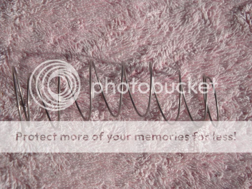

I have it sorted not real hard
finished light
globe had to cut lip off to suit lens
make hole in original holder
fitted spring to hold globe against lens
all the parts wolahhhh now to do the other one
