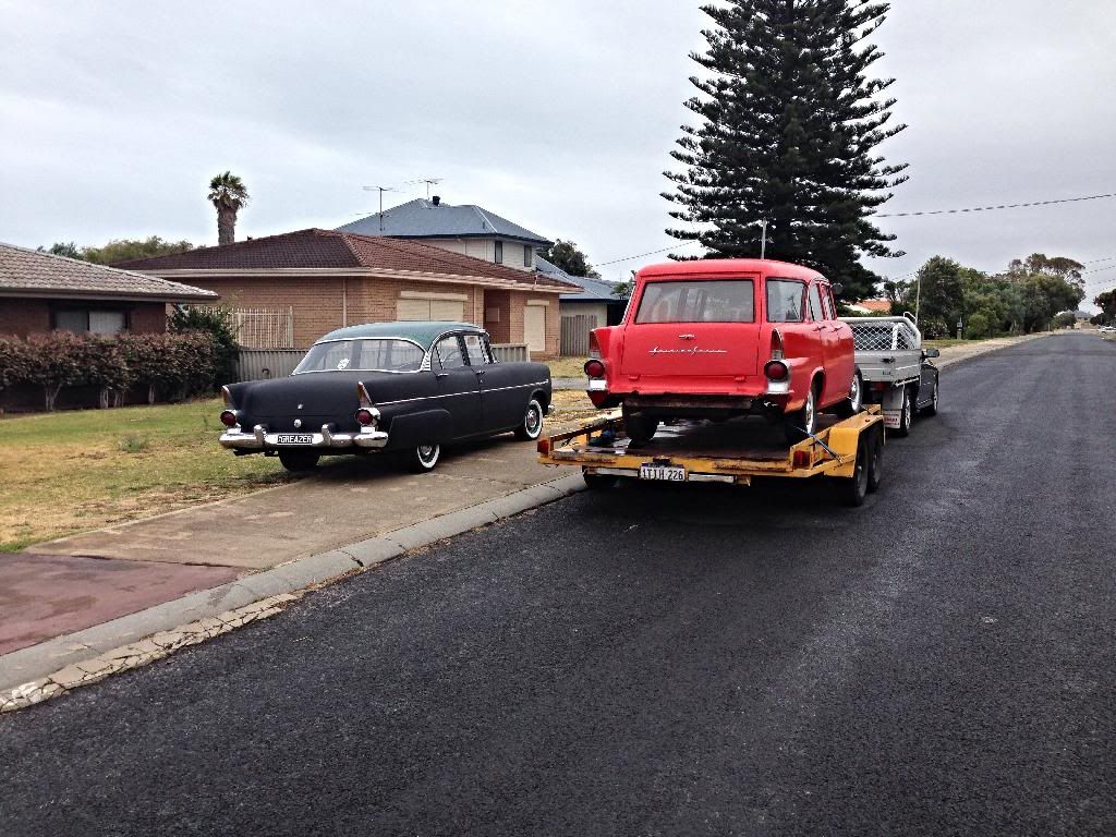

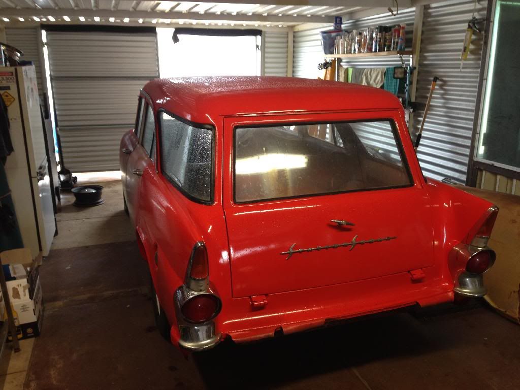

Well what started as picking up a free grey motor, turned into this...
Picked it up on Friday, and it rained the whole way home. Luckily it still has all the glass fitted!
Plans are to strip it right down, and respray it in its original colour, which I think is parisian lilac and a white roof.
I plan on fitting an auto tunnel, and using the original trim.
Will stick with the grey motor, and just make it a nice cruiser.
I have a couple of bits of rust repair to do, but so far I can't see anything to major. Time will tell.

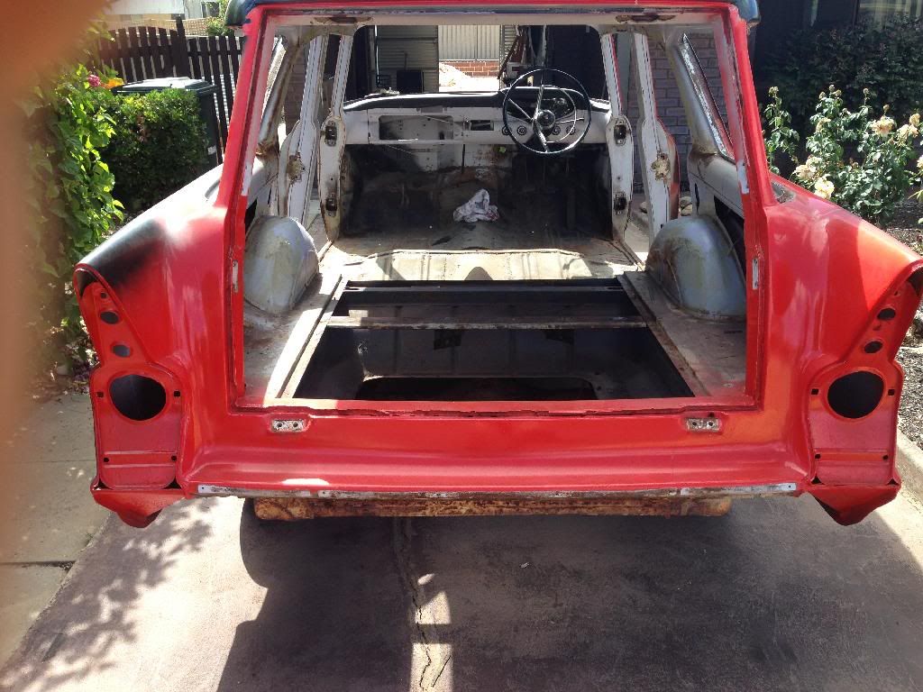

Well I know I said not much will happen for abit, but I couldn't help myself...started pulling off some panels.
Got some KBS paint stripper, and decided in going to make the drive to Perth for some protect paint. Looking at epotec epoxy 408.
Little bit of rust repair to be made there, tailgate looks solid though...not sure how I'm going to tackle this one yet.

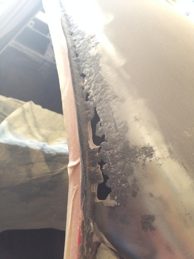

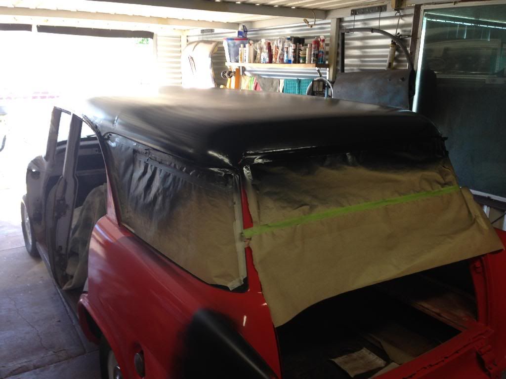

Started stripping her down. Used KBS paint stripper, followed by some protec epotec 408 epoxy primer. Found some spots to repair, never done a rust repair that scarey, so will probably leave that one to last.
Paint stripping.
Back to metal
Drivers side - heavy pitting no holes
Passenger side - rust holes were full of bog
Layer down some EPOTEC 408 Epoxy primer-

That's a lot of paint stripper you got goin on there Woody :ebiggrin: :ebiggrin:
Woody01
Posts: 321
Location: Dampier - WA
Re: Woody's wagon project
Post by Woody01 »
Sure will be abit mate, but I'm glad I've got the biggest area done and out of the way. Hopefully it just falls off all the rest!
This KBS paint stopper seems to be pretty good stuff, you can spray it on (I just used a paint brush, but might try this on the sides) and is pretty easy to clean up. It still burns when you get it on your skin, and it was melting the gloves I was wearing...maybe the KBS brand gloves they sell might stand upto it abit better!

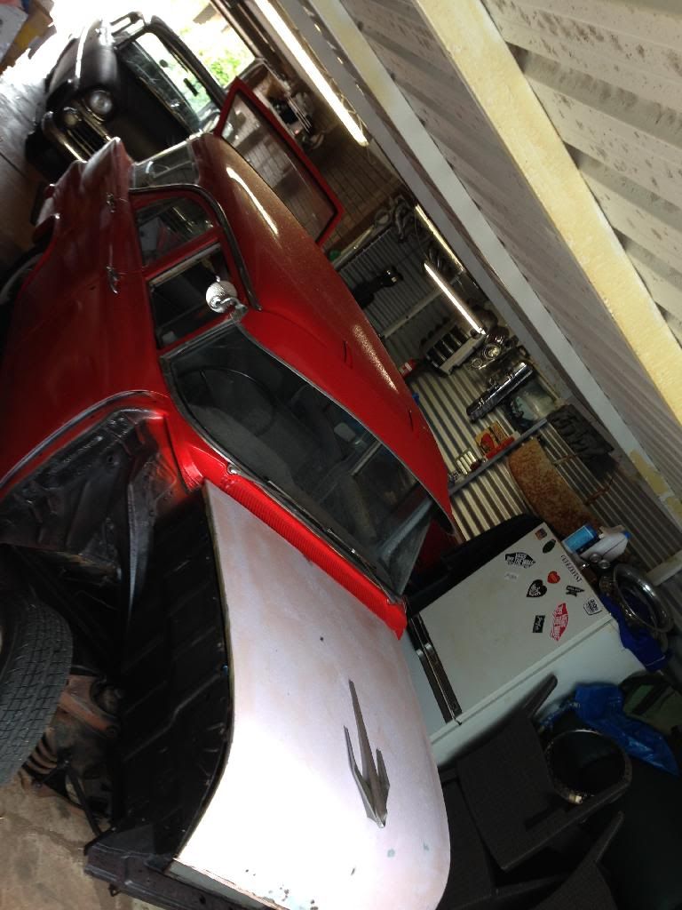

Did abit more bagging and tagging over the break. Pretty much ready to get all the paint stripped back. Then I will make a frame and pull the front end off and prep the firewall.
