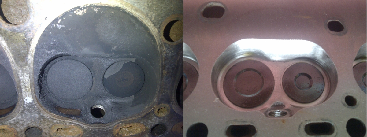

Was trawling through some of my old photos and ran across the one below - though I'd post it for interest. The combustion chamber on the left is the standard grey motor one. The one on the right is from the head prepared for me by Superflow heads - ported, relieved, double valve springs, titanium retainers/collets, bigger valves. Didn't shave the head, as I was intending to use it for the blown meth monster project (no need for increased compression with the Norman huffer). The head made a hell of a difference when I put it onto the FB a few years back.
Optimized-Old versus SuperFlow grey motor combustion chambers.jpg (393.71 KiB) Viewed 2826 times
