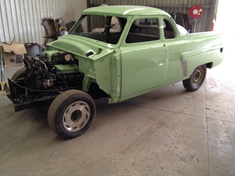

recess the fire wall 300 mm now it fit's also cut the k frame from a 94 fairlane so we got the steering rack aswell
IMG_0347 (816 x 612).jpg (112.03 KiB) Viewed 1342 times
bit of an update for the poor old thing injected 5lt windsor 4 sp auto 4 wheel disc's air and steer again sound easy when you say it fast!
IMG_0351 (816 x 612).jpg (107.91 KiB) Viewed 1342 times
