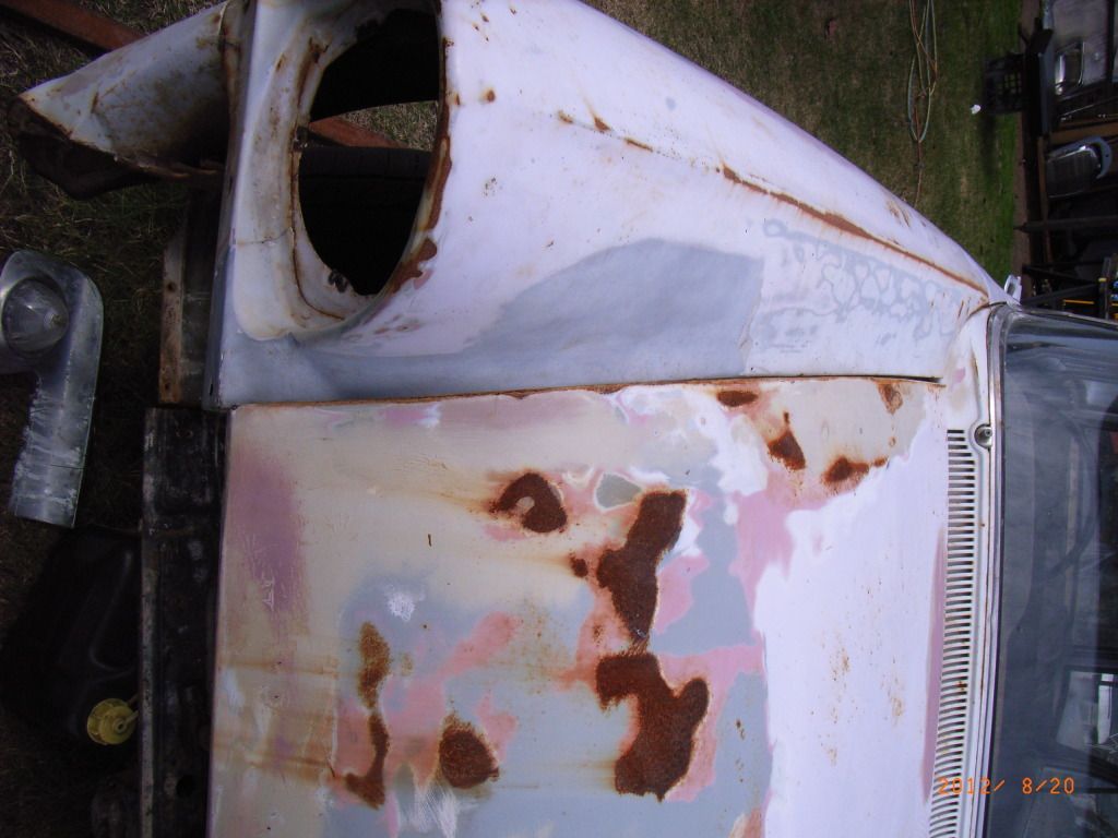

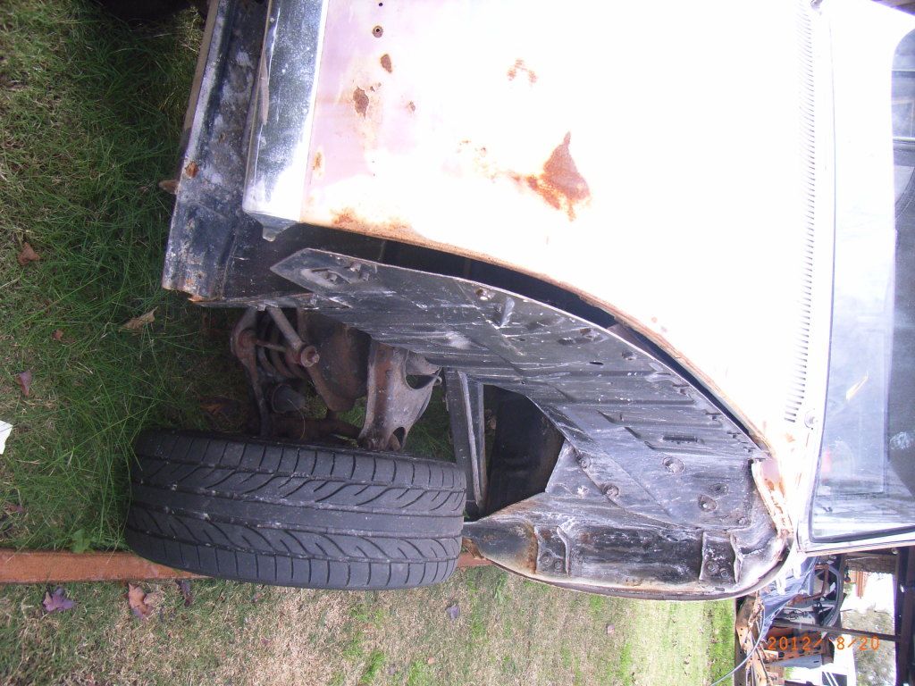

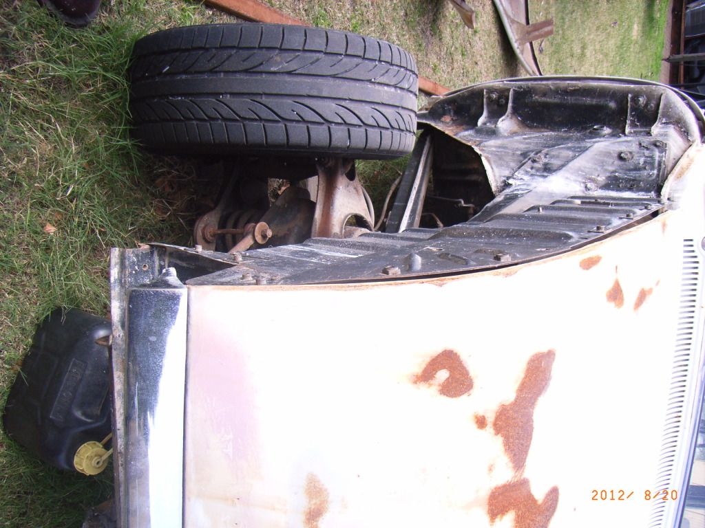

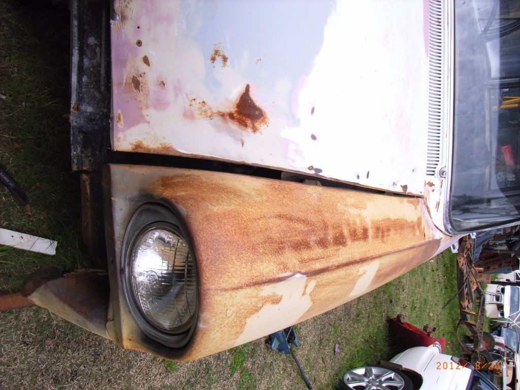

Well this what I have and note the bonnet gap to the plenum is even and central to both aprons in the top corners. Theres no apparent damage to the chassis but who's to say its not a replacement.
Drivers side apron. The bonnet closes over the front of it
With the guard on I have to pull the bonnet across so it will close
Passenger side apron. Have roughly 20mm gap
With the guard on the gap is now about 15mm

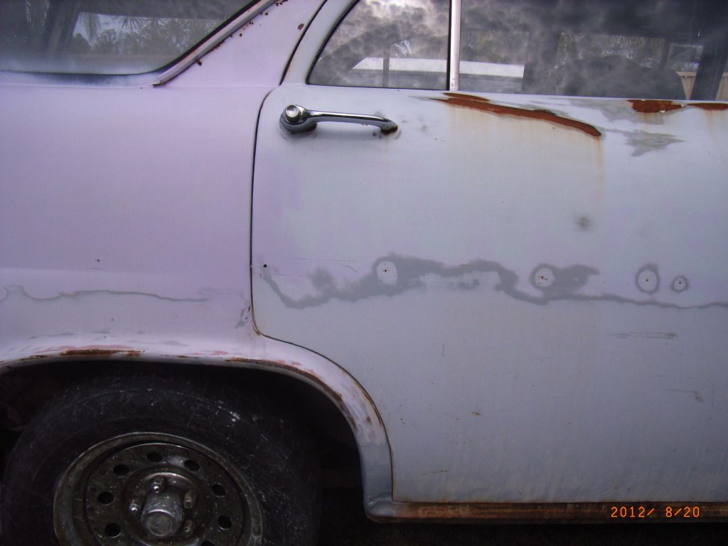

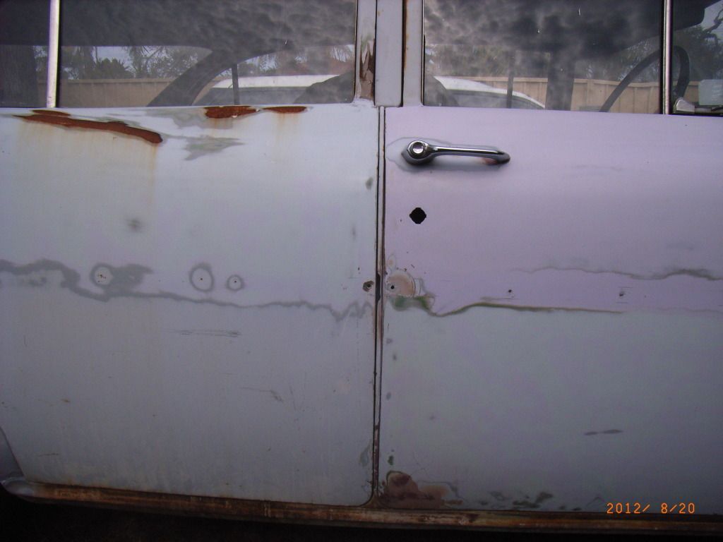

Drivers rear door needs to come down at the rear and up in the front but also forward to open the gap a little and to clear the dog leg
Gaps are not too bad but the rear door needs to come up at the front and down at the rear and the front door needs to come up a tad

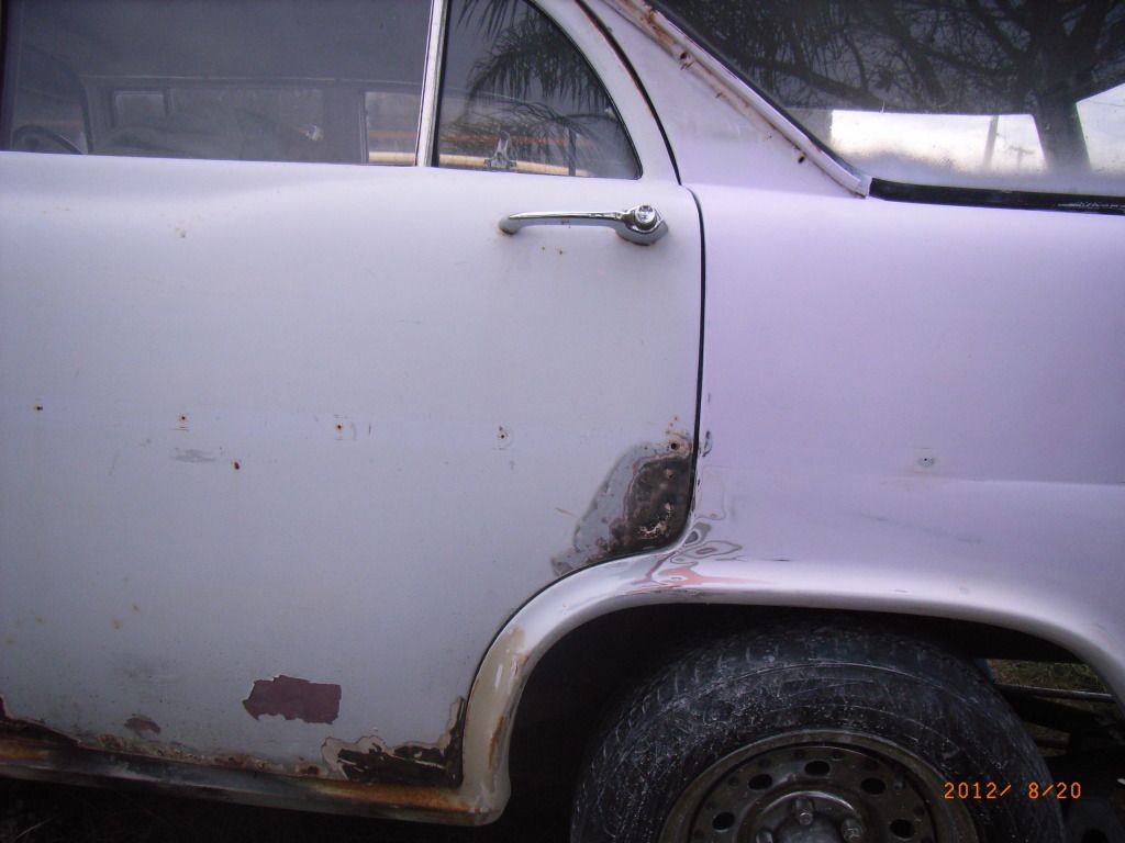

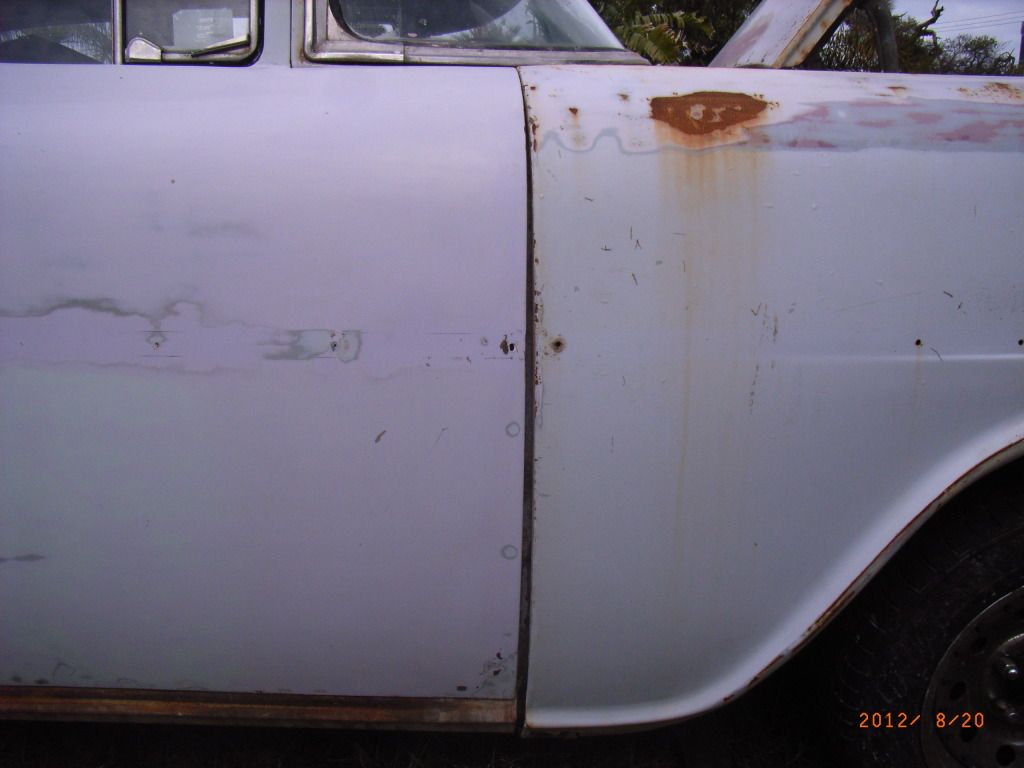

This is the main prob also note the window frame is pretty close to the windscreen pillar. If I move the guard forward anymore the bolts will not line up
Passenger rear door gap is pretty much spot on and the heigths right and seems the only door that fits

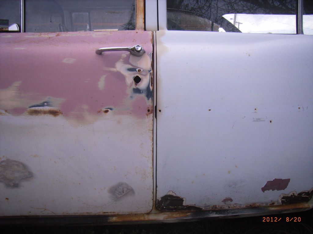

Gaps are not too bad the rear door is good and front door also needs to come up a tad
Gaps opposite to the other side. Ok at the top but guard overlaps the bottom. Not the window frame is also tight on the winscreem pillar
