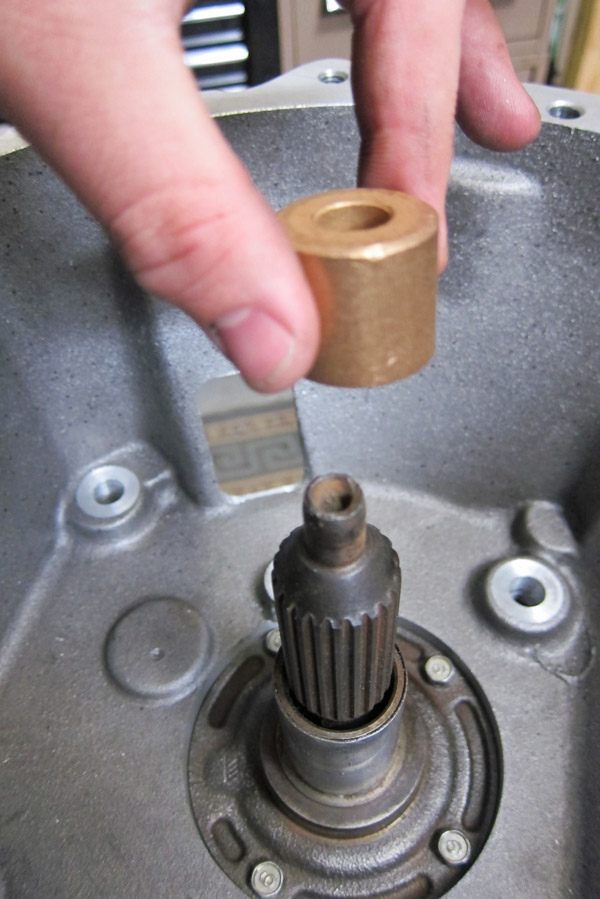

Mines a steel 5-speed. No thrust washer.
Just bolted up to bel housing adapter (Dellows) and then the thrust bearing/carrier slid onto the shaft. Did have a 0.5mm sleeve on it that i had to remove to get the 35mm thrust carrier on....
got a photo?
got a photo?
- IMG_2464.jpg (113.23 KiB) Viewed 516 times
