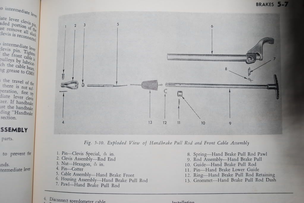

Handbrake retaining clip (see pic)
Post by BS »
No 12.
Anyone know where I can get one? New or second hand not fussed just want one.

Re: Handbrake retaining clip (see pic)
All the ones I've pulled apart had fencing wire used, twisted shut then carefully bent to fit :oops:
Post by BS »
whatever does the job hey, might have to raid the nut and bolt jar for a snap ring or circlip etc that will fit.

Post by Bluehaze »
If you walk into a fastener specialist. ( eg Coventry bolts) with your hand brake handle in hand they'd be sure to find a C clip that will fit nicely.
Post by smakpanels »
I used a circlip and it works fine .
Post by Aussie Bob »
I have found them in the rubber boot a few times, or sitting on something if the clip has fallen out of the boot.
