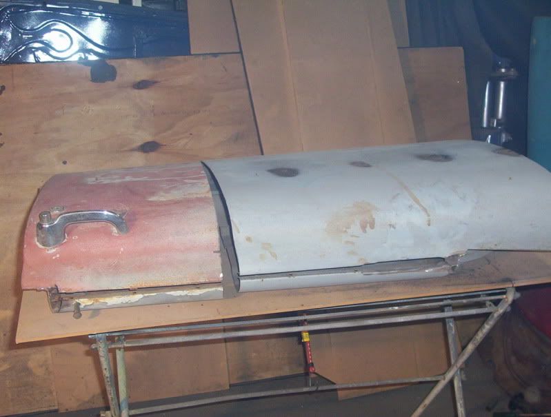

pretty easy set up mate
i still have the templates if you want them
they are 4 inches lower though
