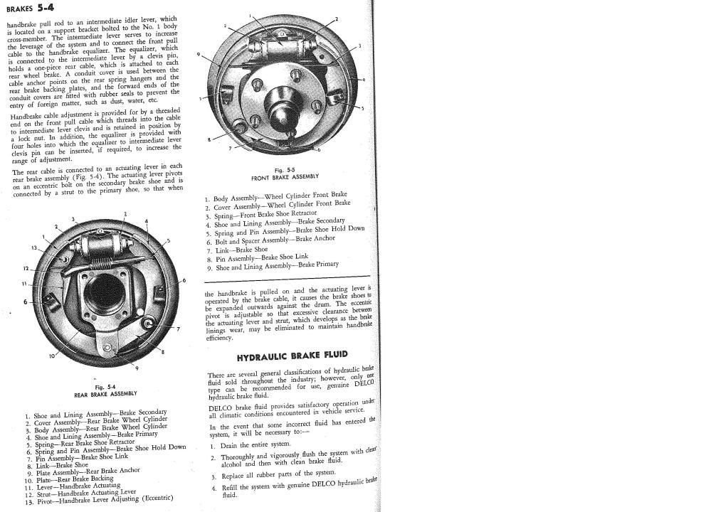

Does anyone have a brake diagram showing the brake adjustors, I have just purchased a set of 4 which were given to me in a box, there are 4 that are thin when you look at them side on approx 18mm and 4 that are thick approx 25mm, does anyone know if the thin ones are a complete set and go on the front or back or are you supposed to put a thin and thick one on each cylinder - Thanks James 0415122285

From the Holden Workshop Manual "FB" Series:

Thanks Harv
That's very helpful
